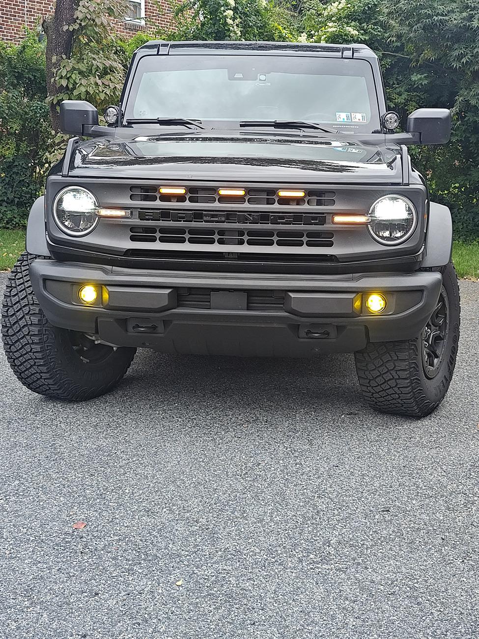

Ford Bronco help with fog lights fo
Got fogs installed. Was pretty straight forward, most annoying part is running the wires down to both lights. Took about 45 min.
part list to get it done for anyone interested
https://www.amazon.com/gp/aw/d/B07FY895TN?psc=1&ref=ppx_pop_mob_b_asin_title
used this and just cut off all the relays and wired into the purple wire and then connected to aux switch one using a quick disconnect fitting so I can change if needed.
Trim panels with the cutouts:
https://www.amazon.com/gp/aw/d/B0D3LQ2VM8?psc=1&ref=ppx_pop_mob_b_asin_image
I went with these fogs but there are a lot of cheaper/alternative options :
https://www.amazon.com/gp/aw/d/B09X25LF6C?psc=1&ref=ppx_pop_mob_b_asin_image
