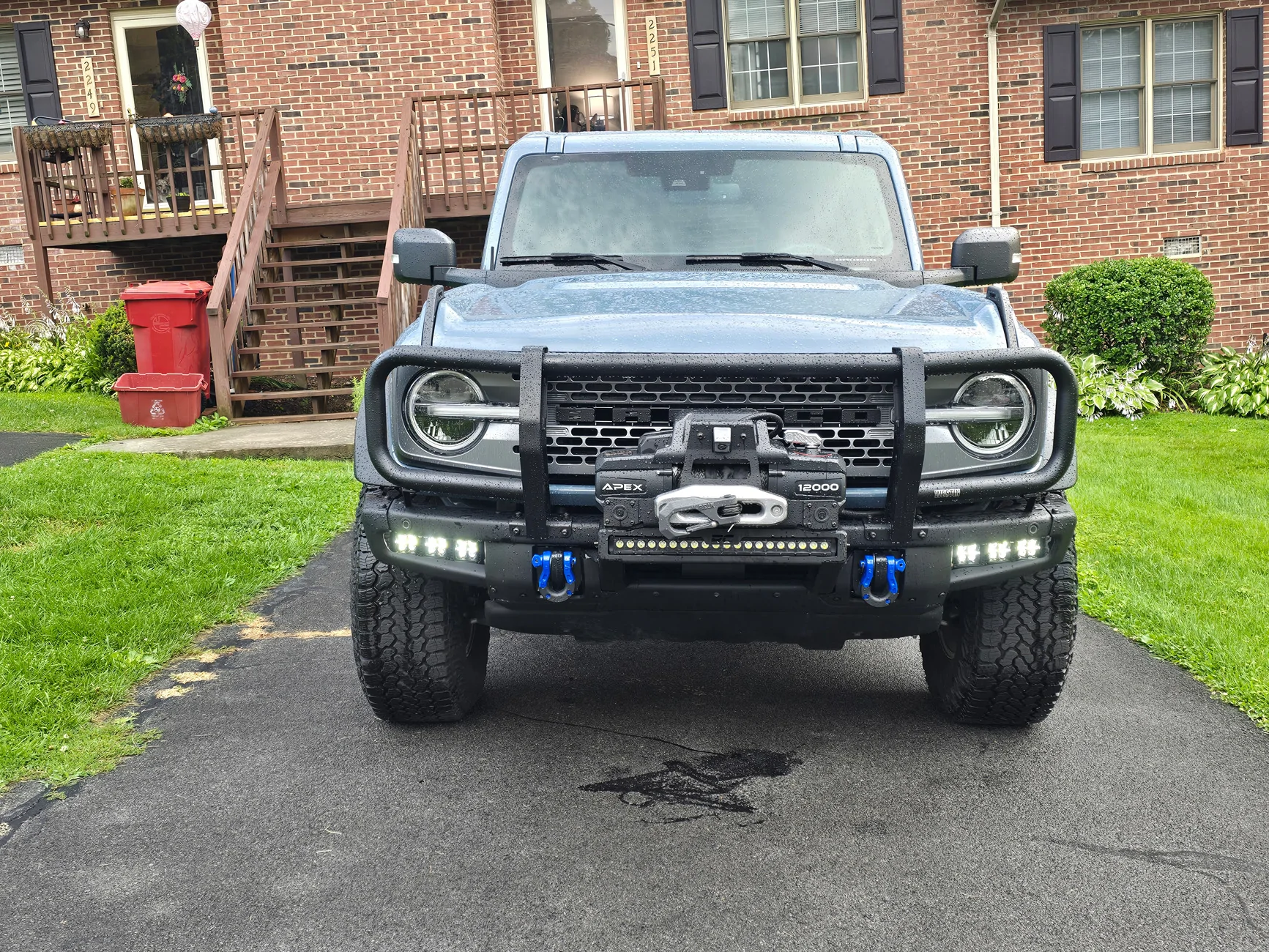

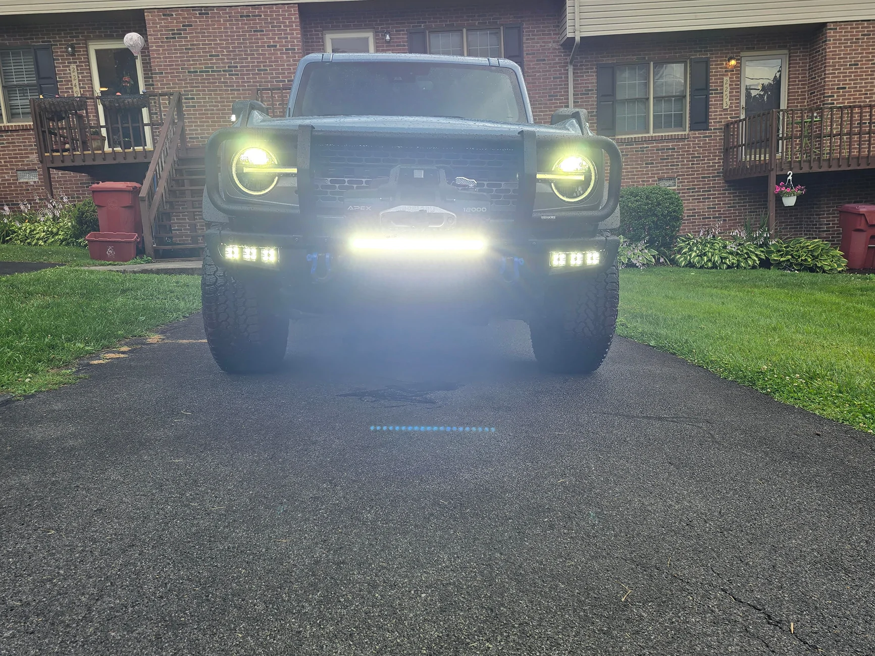

My bronco is gradually coming together. That being said, I am thinking of adding more lights to my setup. I currently have Rough country 20" light bar in my winch setup and the rough country fog lights kit with drl. They produce a lot of light but curious if i need more?
I am thinking of adding some more in the top portion of my brush guard hanging down and possibly some on the pillars to get a wider spread. Budget friendly but good quality and reliable would be best.

You should already have more than enough if you've been judicious in selecting patterns and outputs.
Too much near splash will blow out your night vision and reduce your overall visibility.
Roof-mounted and A-pillar lights will move that splash to your hood, which I personally cannot stand.
I'm getting by with a similar setup to your current one sans center lightbar - I use a set of white Fog and white Driving pattern lights where either is street legal, but as a pair they give lots of forward throw and side illumination. The flat, wide beam of the foglights is also good for recovery work after dark, as you can illuminate the area without blinding yourself.
The third pair is lower-power selective yellow fogs for actual fog or other inclement weather.

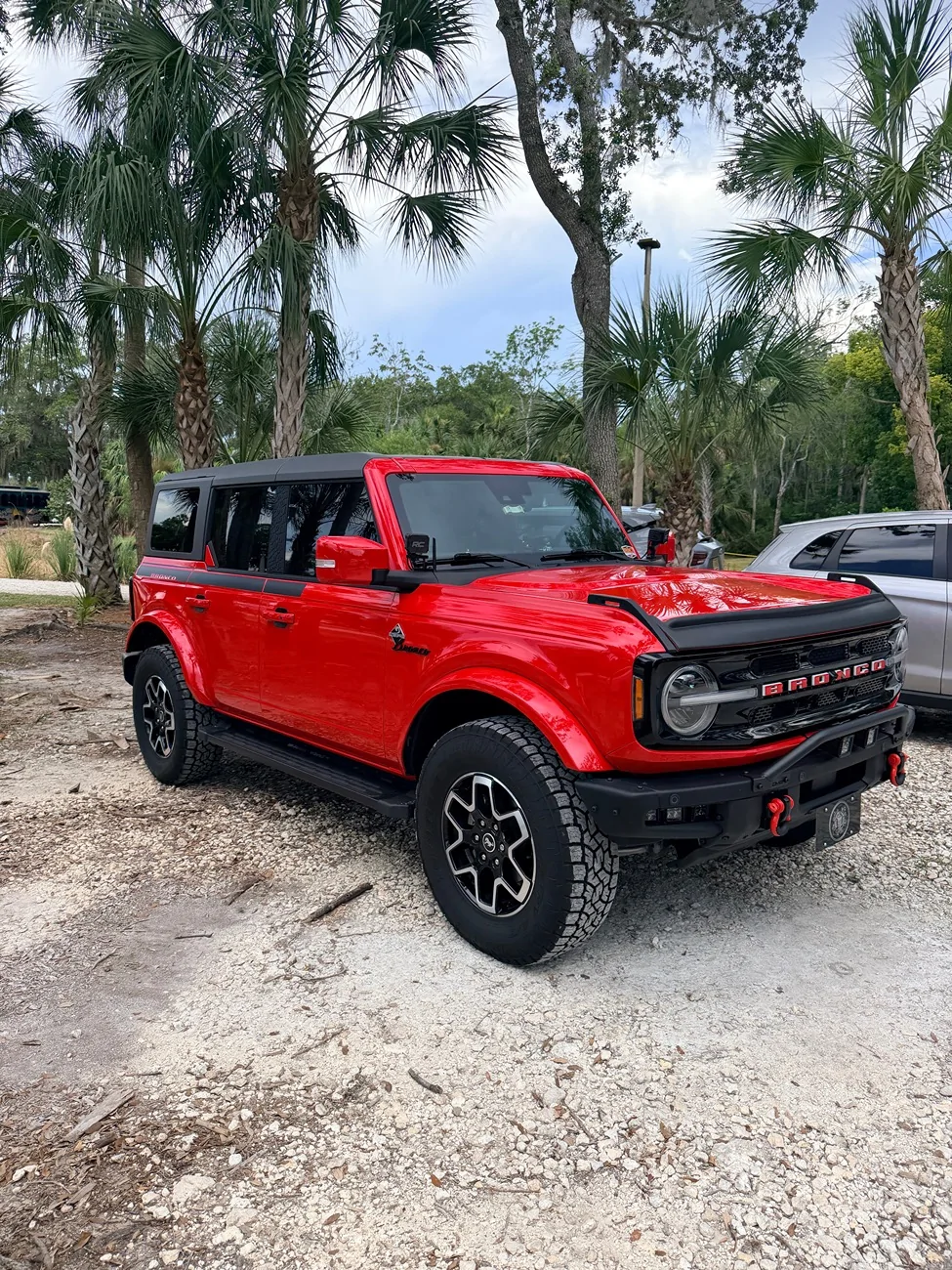

My set up is admittedly not the prettiest. But it is functional. I have a 12 mile section of my commute that it is little more than a fire road and riddled with critters and the occasional axel swallowing crater in the washed out road. After a ton of trial and error I arrived at what worked for me…. It’s a combo of flood and spots all aimed strategically. Point is do what works for you and don’t worry what it looks like 😎
