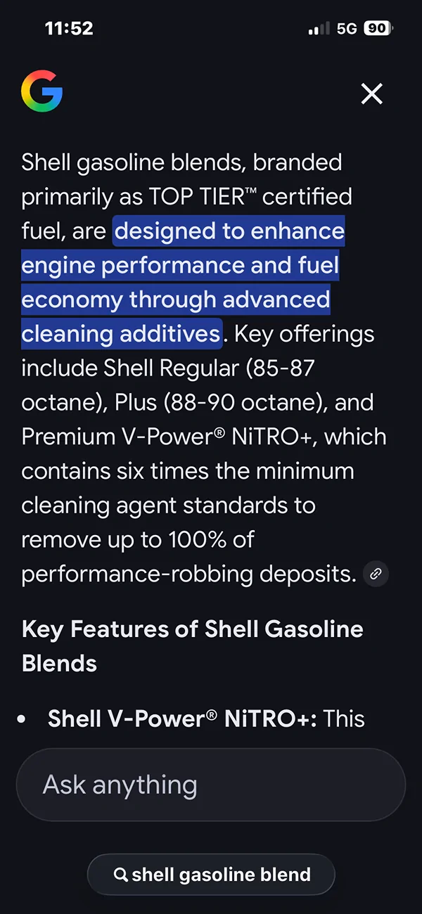

Not just gasoline but SHELL’s gasoline. During His 15 minute video he sets reasons why something is needed but never discussed what Shell did other than ‘additives’ or what those additives do to the cylinder wall and piston ring are affected.
He has been around a long time, is a good guy but he’s a salesmen, in current terminology he’s an internet influencer…

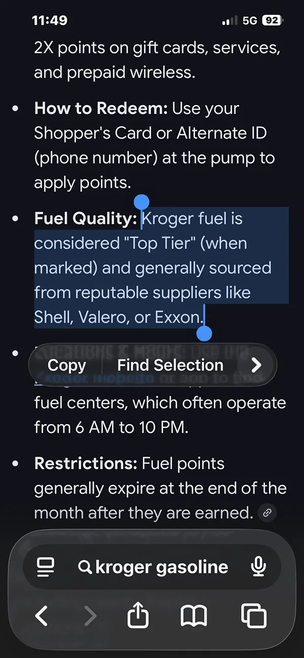

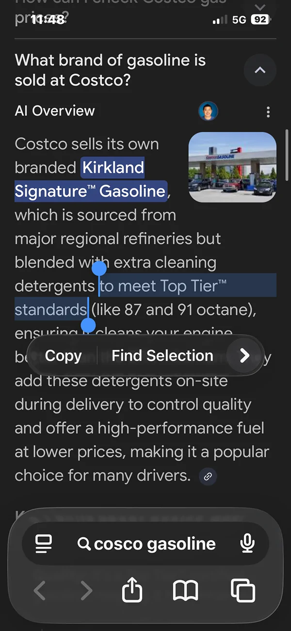

… not questioning but do you have some better Costco data than AI?
I can’t see any of the other top tier brands letting a competitor say their gasoline is better …
I use Ralph’s/ which is Kroger’s outside of CA… I’ve talk directly to the Driver's/ Delivery guys and here in SoCal 66 Phillips formula sold by Shell to Kroger’s
