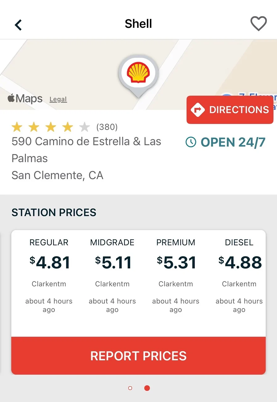

I prefer Shell 93 in my performance vehicles. Sadly our Shell stations tops out at 91 in SoCal and prices for "premium"... well :confused:
Same here in Central CA. You can go to the casinos or grocery stores and get cheap gas, but it's non-"Top Tier" and it definitely runs like crap most of the time.
I haven't noticed a big difference in Chevron, Shell, or Valero (the big 3 where I live). There are a few P66 stations starting to pop up though, which are Top Tier, but I don't have enough tanks on them to notice.
