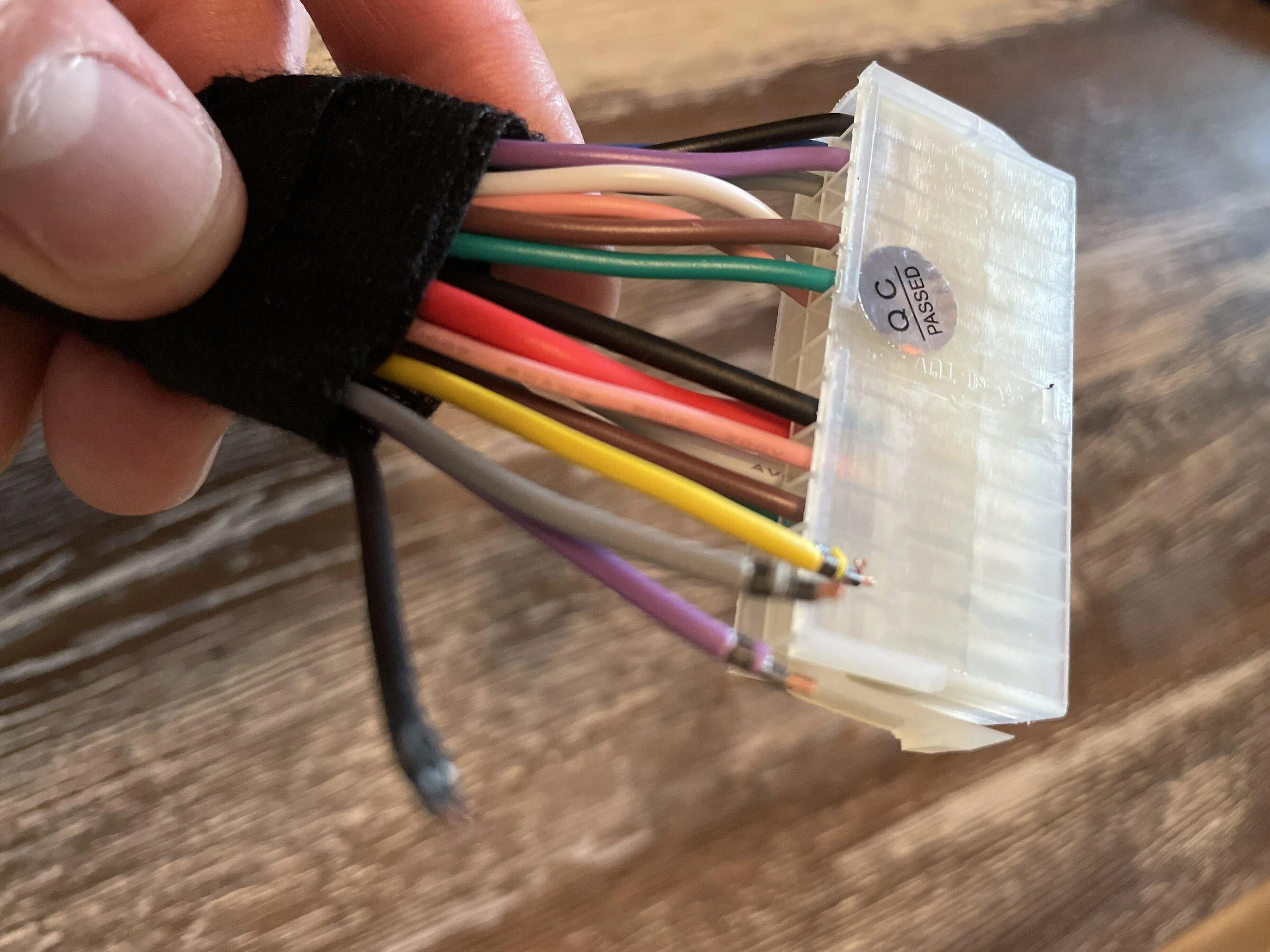

Has anybody had any issues with their harness? I went to install today and had no problems hooking everything up but when we turned it on I only had sound on the driver side. When we unplugged the harness and amp and plugged it back in just factory everything worked. Taking another glance at the harness it seems so if the wires weren’t set right. This is what we found after unplugging it. Just wondering if I happened to get unlucky. Already emailed plugnplay hoping he’ll swap me for a new one to try.
