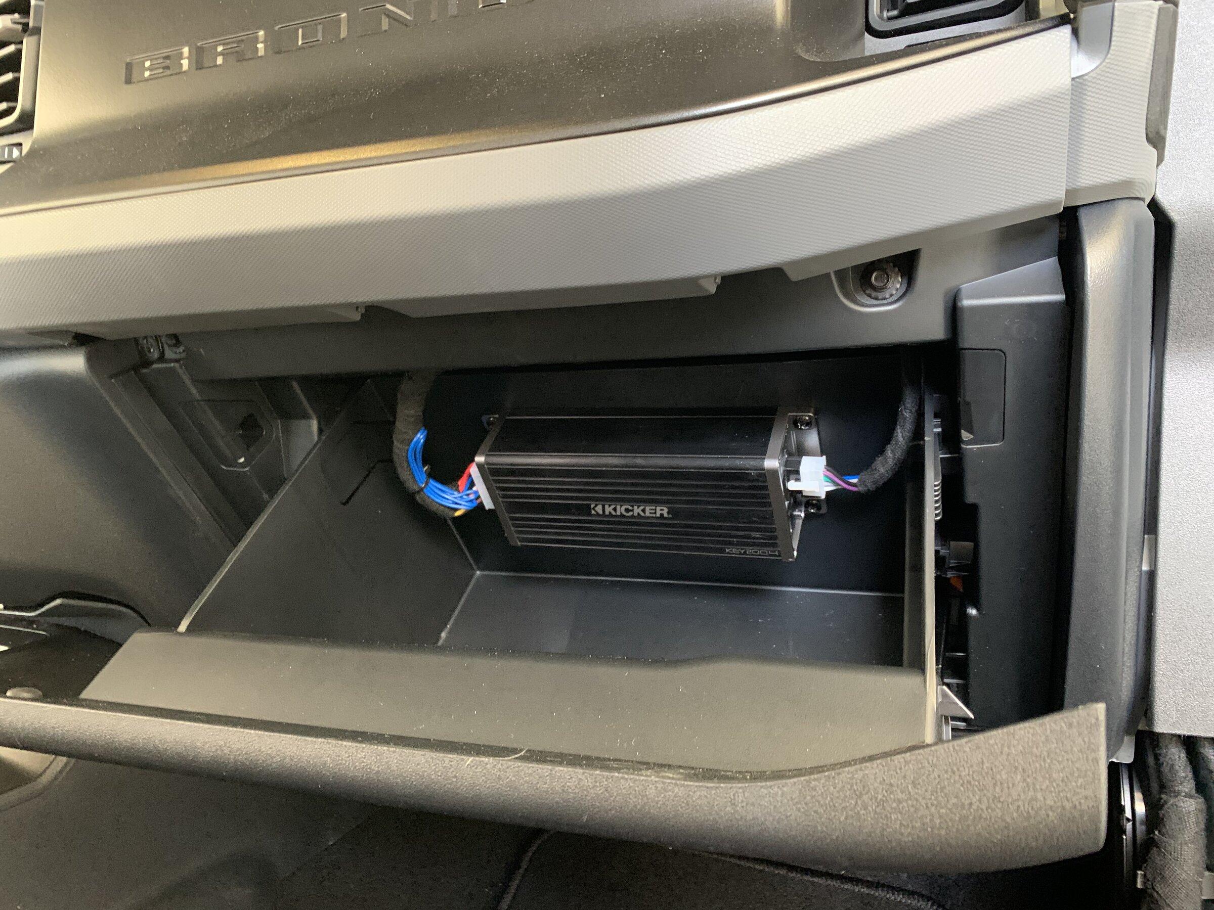

I put the amp in the glovebox for easier access. There are other options noted in the forums. I'm debating on the subwoofer location. For ease of taking it out, I'm thinking of just velcroing it to my rubber mat for now to keep it from sliding around. I can quickly disconnect it from the harness if I want to remove it from the truck.
Awesome, thanks. I dig that spot for the amp

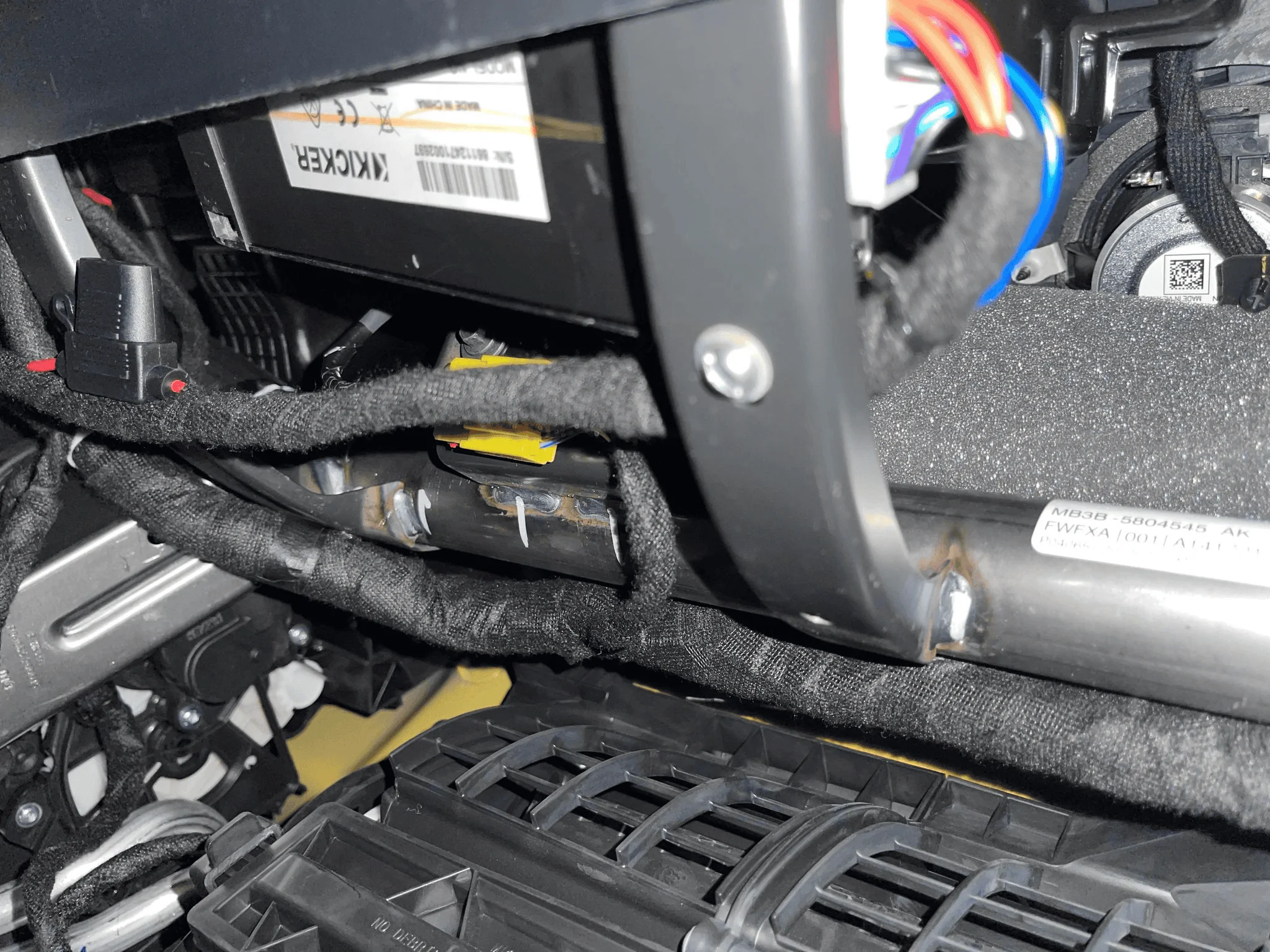

I got mine mounted with a bolt though the metal dash bar.
Extremely happy with the audio outcome with the stock speakers still.
