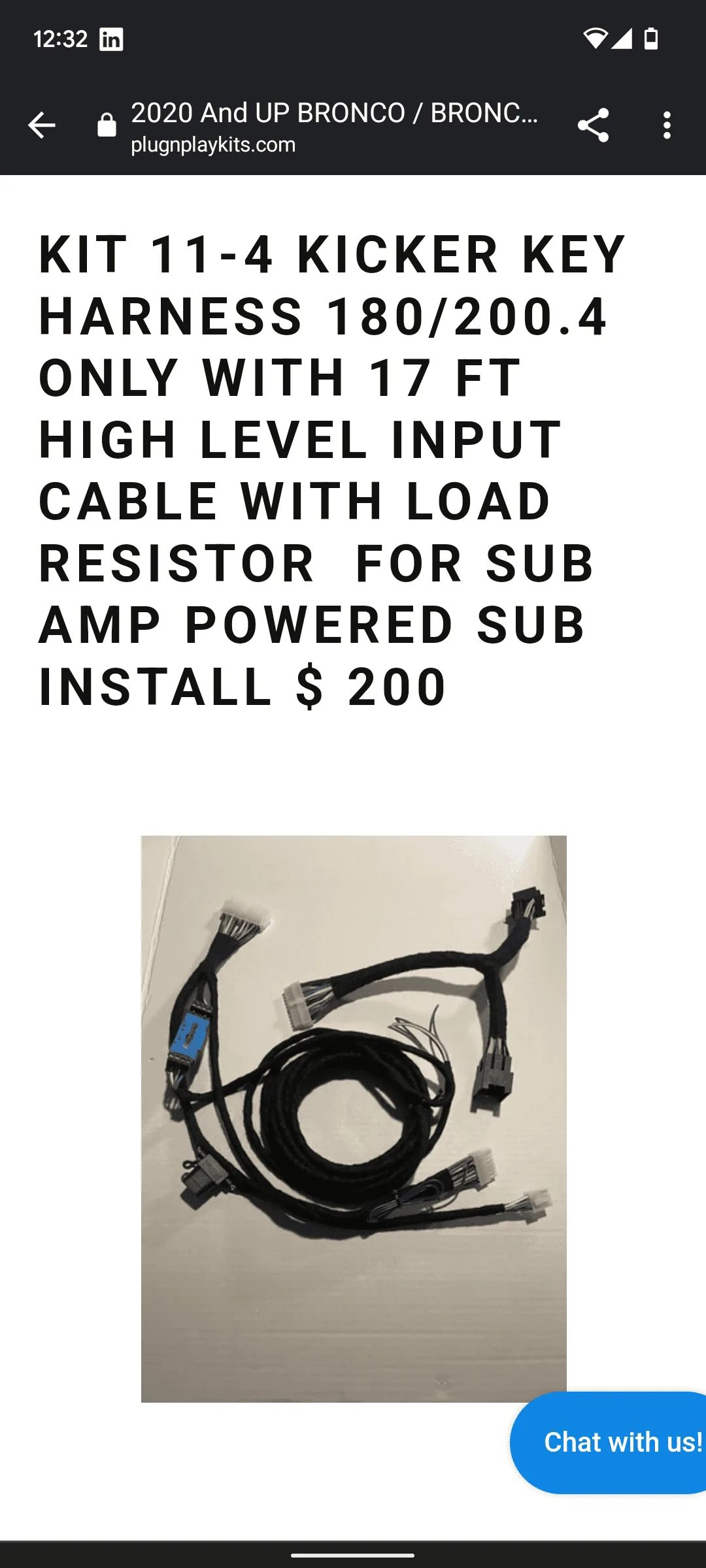

Would this be the kit I would purchase then? I would just need to supply the kicker key amp for the speakers and an additional amp for the sub?

yes, if you just want the harnesses. FYI, it is a bit more than buying individually, but I bought both the key amp and the powered subwoofer from PNPK and it was worth it...just ran the lines and plugged in the harness. Didn't want another power amp in the trunk with the sub so got the HS8 made by Kicker...enough bass for me!
