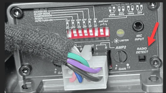

Try pushing in the radio detect switch. Because you are hooking into the stock radio head, that button needs to be pushed in. That did it for me.
I'm running off the battery as well....

This is an ongoing problem that customers who do not buy the amp from me . I turn on DC offset on the amplifiers prior to shipping as well as radio detect for you . Also, people do not read the instructions on the kicker key and then assume that the Wire Harness is bad which it’s not every single Harness is tested and connected after being made .
I was so happy to get my kit today and took my sweet time watching the trail seven video and writing notes from all the 200.4 install posts on here. I got it all ready to mount and no power to amp…dip switch is on DC, radio detect is pushed in..undid the whole thing and went back to stock, everything working great so I tried all the steps again with same results. So it’s either the amp or harness….fuse on harness is fine..I might go buy a new kicker at Best Buy to see if it has same issue (ST is closed on weekends but feel good about their customer service on Monday). Any ideas?
Had this exact issue. This solved it! Thanks!
