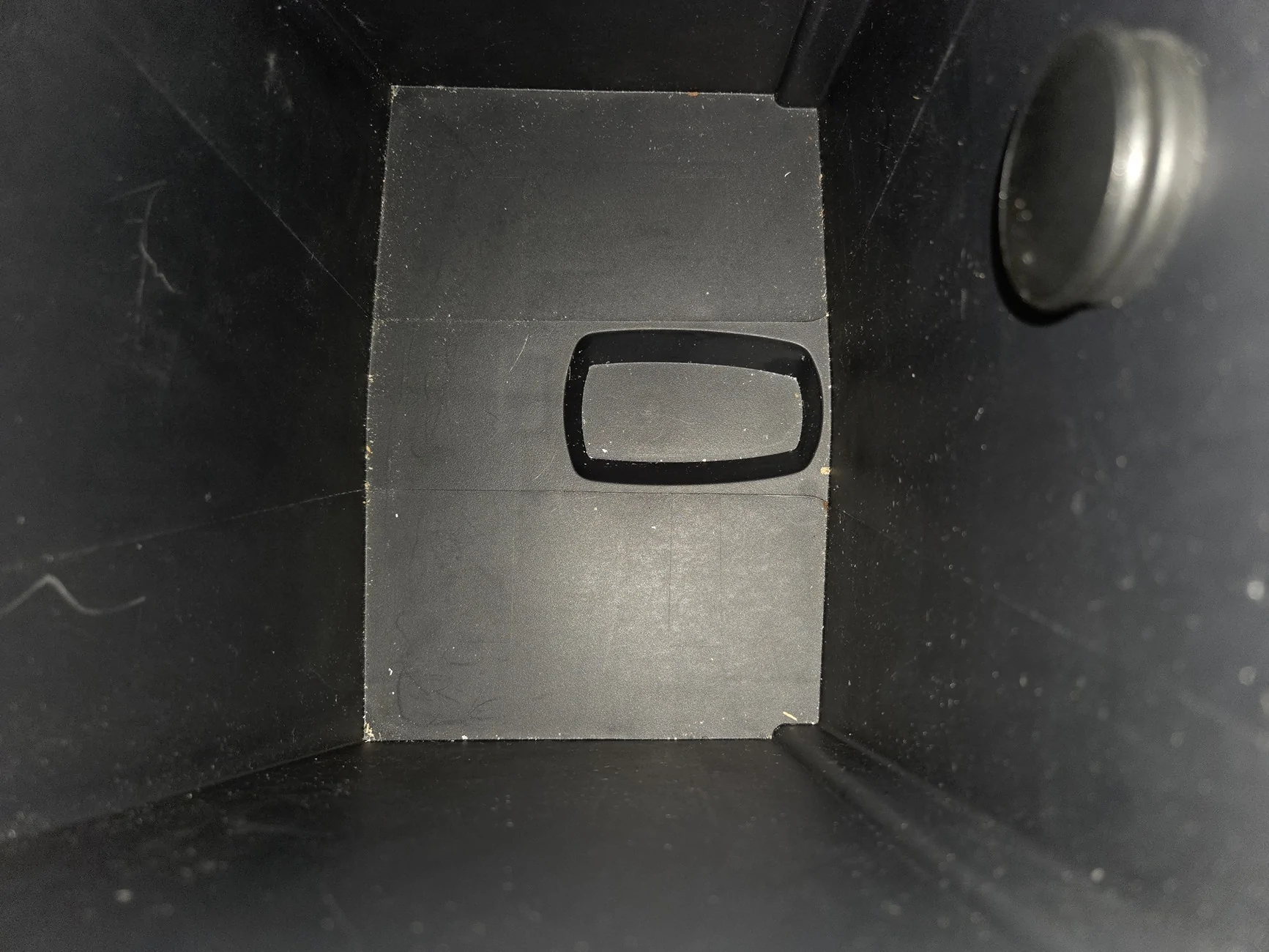

Stopped a gas station. When I got back in and tried to start my 2023 Big Bend, I got no action and the message "Key Not Found" even though I used the fob tio unlock the doors. Called Ford customer service. 17 minute call, rep put me on hold twice and came back saying "no troubleshooting tips for fob. Customer privacy. Call the dealer."
Did a quick AI search and was led to a YouTube video that showed exacctly what to do. There's a fob-shaped depression at the bottom of the center console (see pic). Put the fob in, started right up. Replaced fob battery and it works fine.
Ford Bronco "Key Not Found" Ford no help 20260701_205148
Lessons learned: 1) Ford cust svc should have known that immediately. 2) Always use the Internet.
(PLEASE no smart alecky "read the manual" comments)

My salesman told me about that when I picked up my Bronco.

Thank you for that information. Didn't know it was there under the piece of gray carpet at the bottom.

Could have tried global window down - press unlock button on fob then press and hold unlock button for 5 seconds
Would still have to use that under carpet fob space to start the vehicle. I’ve had to do it out in the middle of Death Valley. Was a bit freaky being 2200 miles from home, trying to get back to Lone Pine before dark, with a vehicle that wouldn’t find the key fob

I would agree, Ford Customer Service should have suggested using that. I know about it and I still might have forgotten in the moment. 🤷‍♂️

Thanks for sharing the story, I forgot about that indent. I've had several similar events. I've changed my fob battery 3-4 times over 5 years, and when my car battery / electric system started acting wierd at 4 years last fall, I replaced the AGM Battery too. It seems like in today's cars, battery is King 🤴!

Ironically, the same thing happened to me today with my 2 1/2 year-old Badlands, except that the key fob wouldn’t even let me unlock the door.
I had to use the mechanical key to open the door and then use the fob in the indent in the console to start the Bronco.
If there was a “Key Battery Low – Replace Soon” warning displayed on the instrument cluster or the infotainment screen, I sure didn’t notice.
Well, off to get some CR2450 batteries.
