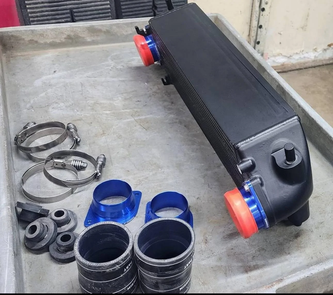

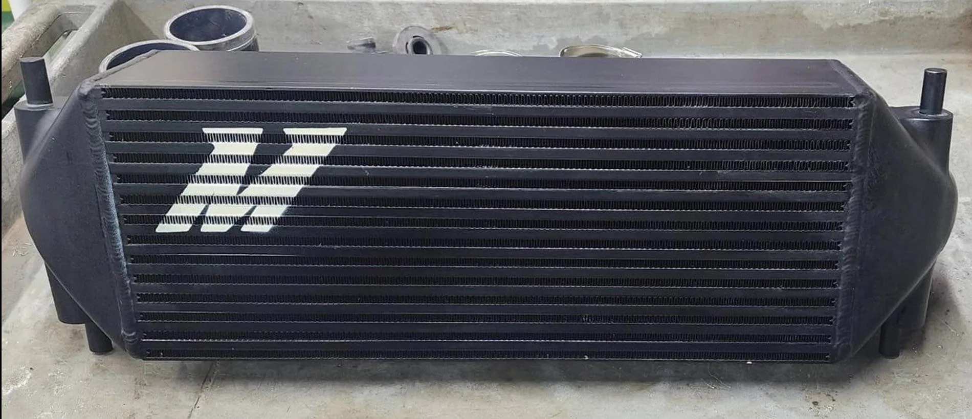

Sounds like this may work out in my favor. Meeting up tomorrow to buy.
Anything unique or special I should be on the lookout for? Plan on inspecting all welds, inlets, etc to make sure there aren’t any cracks or damage.

Everything checked out. Made the deal. Seller was a cool guy. We talked shop for an hour before getting back on the road to come home.
Need to start searching for a deal on the charge pipes now. Let me know if someone has some for sell for a good price.

Did you get an extra set of the blue collars that bolt on the intercooler? If so, are you willing to sell them? I need a set.
nolimits
nolimits
Sep 25, 2023
893
1,290
23 Badlands
Good eye.
I have 2 sets but they aren’t identical. The small ones (loose) are for the stock Ford charge pipes. The larger ones (attached) are for the Mishimoto charge pipes.
Honestly I was a little confused the way he explained it but the jist was he had to buy the extra collars because the way he upgraded from intercooler to intercooler + charge pipes.
When I look on the Mishimoto website I see they have a few different charge pipe kits but they appear to include the necessary collars at first glance. But I haven’t dug into details.
All that jabbering to say I may be interested in selling a pair of them once I know they are truly extras and I won’t need them when I convert to the upgraded pipes. Hope that makes sense.
