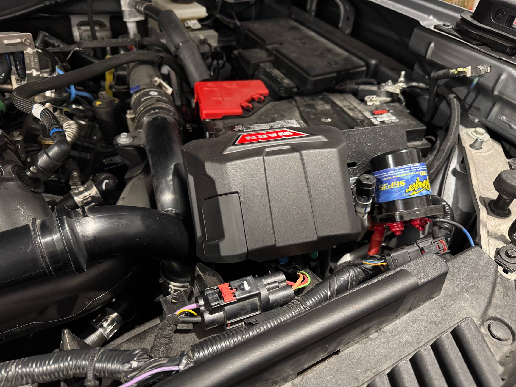

Sounds like this may work out in my favor. Meeting up tomorrow to buy.
Anything unique or special I should be on the lookout for? Plan on inspecting all welds, inlets, etc to make sure there aren’t any cracks or damage.
Do you Still the the Blue adaptors that are for the OEM piping the ones on the cart? interested in them if you still have.
nolimits
nolimits
Sep 25, 2023
893
1,290
23 Badlands
Nope. I ended up relocating my winch solenoid under the hood using the BAMF bracket. It’s pretty tight in that area and I don’t think I can fit larger aftermarket pipes. So I ended up leaving my stock pipes and used the stock adapters to make it all work.
