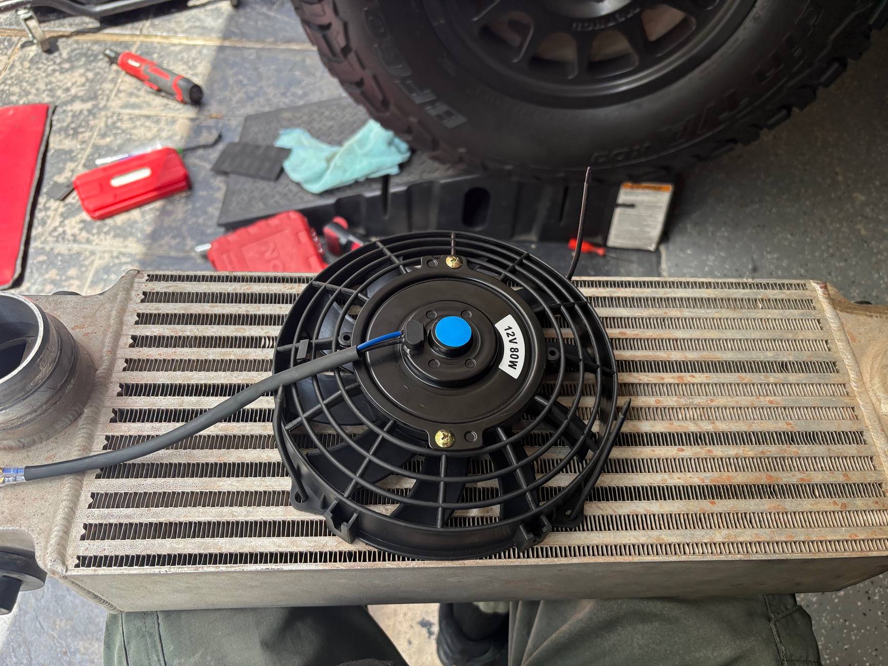

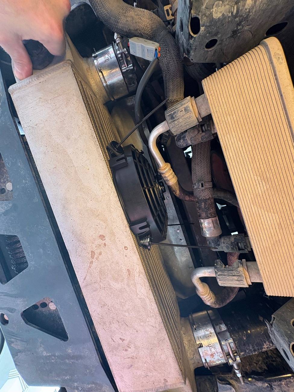

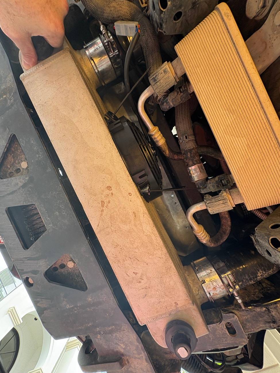

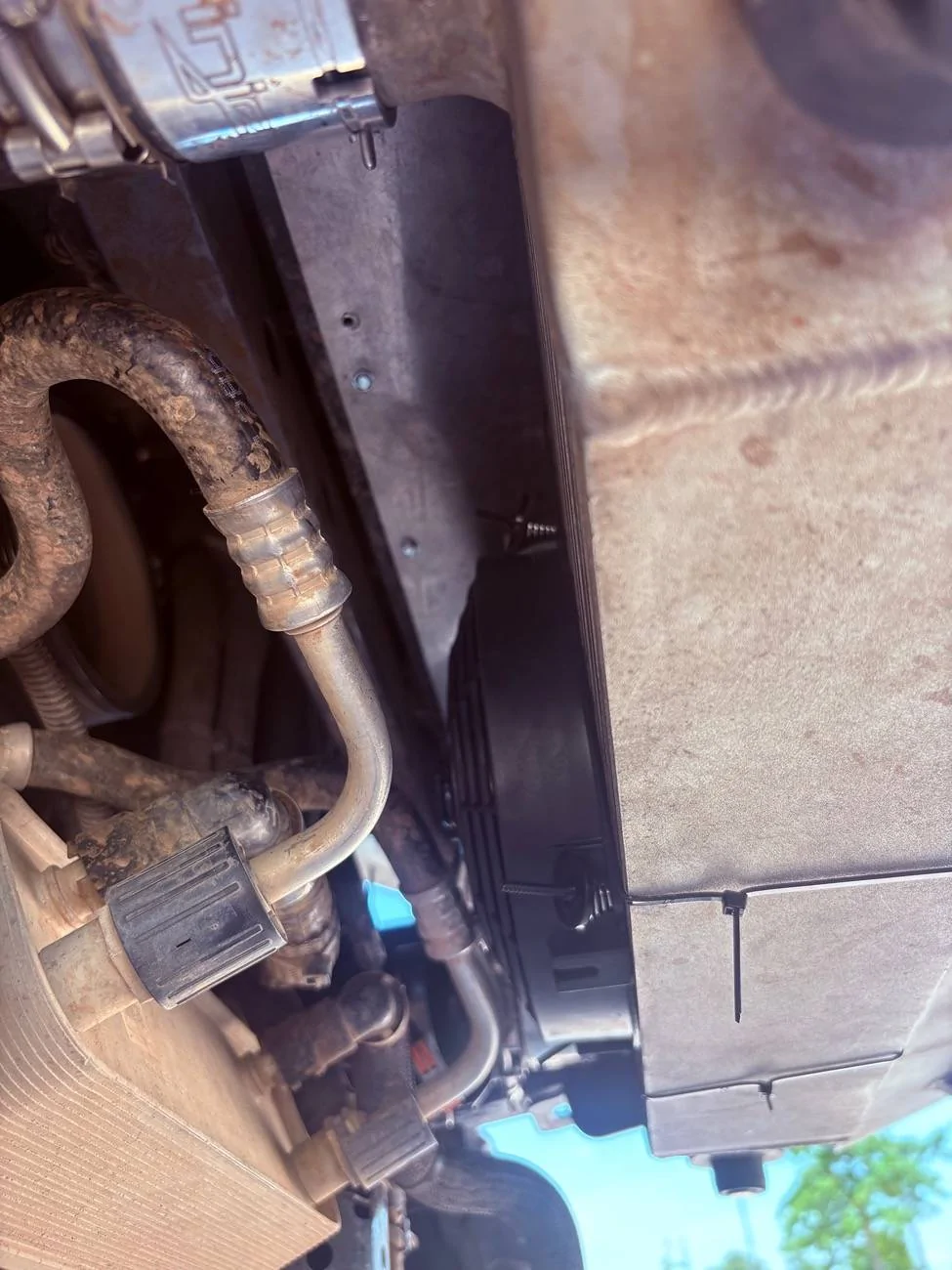

Removed shutters and added a 7” 1200 cfm puller fan. The CPE intercooler is 7 inch tall and there was plenty of space behind it and the transmission cooler.

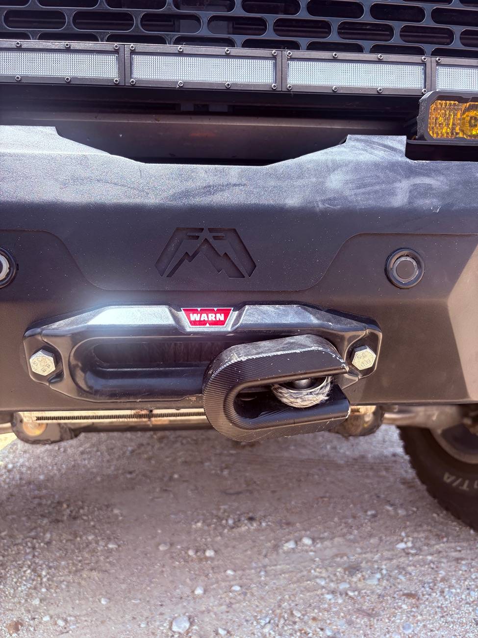

It’s an easy enough experiment to try and improve on my blocked forced air flow (bumper/winch/armor). By creating more draw, and there is plenty of free air flow to draw from under there, maybe IAT will come down in these hot days and heavy loads I’ll soon be facing.

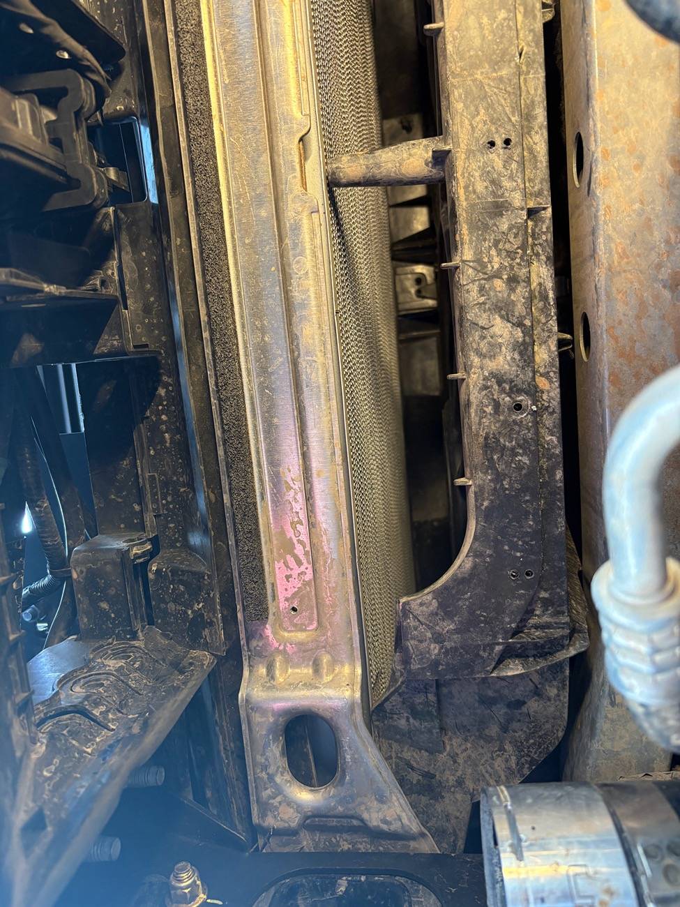

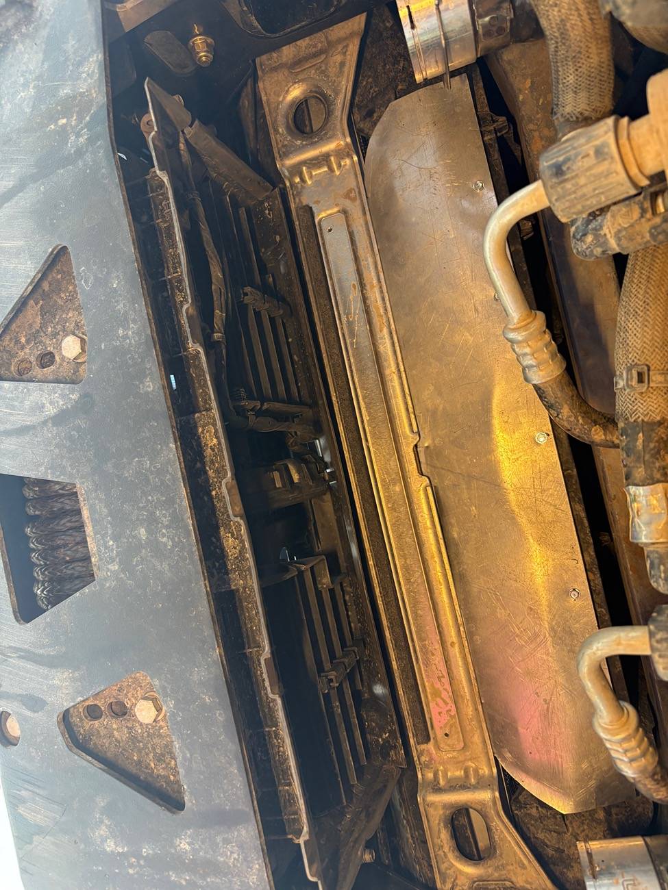

Pics show the aluminum sheet lower fan shroud put in recently as well.
And this may be a corner-case but CPE intercooler + FabFours front skid plate is a bad combo. Maybe it’s always like this but that heavy armor and the A/M intercooler hanging down there, what a PITA reassembling for a one man job without shop stands and a lift. Even my shop says so.
Sorry the pics are lousy and some turns out were videos.

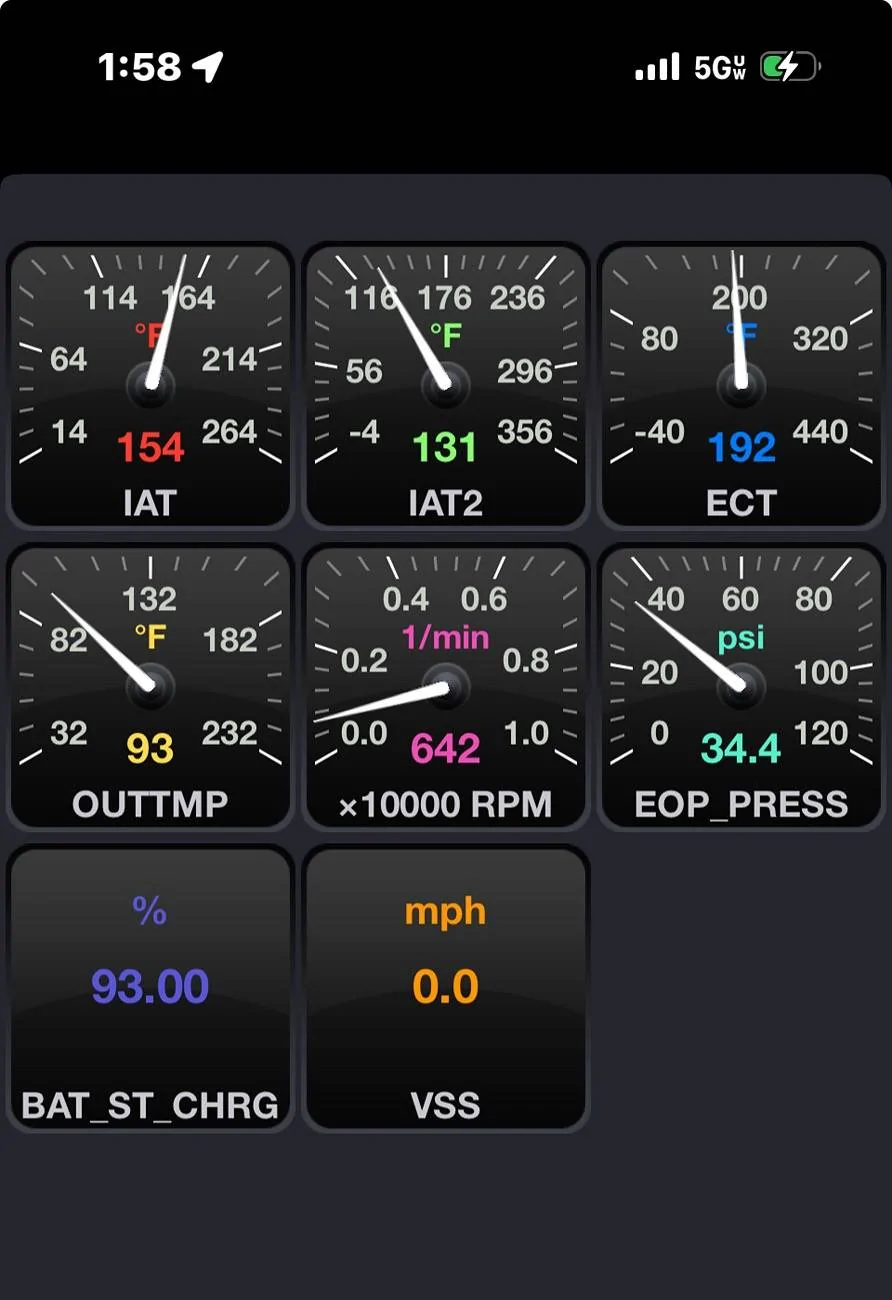

Great input. I forgot to mention that I will monitor IAT and IAT2 temps closely under different conditions via my scanner. AND I put a Bluetooth thermometer in behind the IC to watch what happens on pull through and dead space temps. There’s no way to know what this 2.7L Ecoboost will do compared to my other trucks, not even my F-150 Eco. We’ll see, at all speeds.

Today it was cool but I can tell driving around that just the shutters being removed is dropping air temps.
Haven‘t run the fan while driving yet, it was miswired.
Got that repaired, and did a smoke test in the driveway; the fan pulls a lot of air from around obstructions into the IC, and air gets pushed out all different pathways from the skid plate interior and off-axis of the fan output.
Later this week, that high ambient heat will be a good test.

95 degree highway and local driving and lower than my usual temps. IAT2 recovery to 110 degrees from high boost on punches from 40 to 85 mph was almost immediate (after removing shutters) and traffic/idle never went over 130 (fan), mostly low 120s. I mean it’s not dropping below ambient
like others, but a big improvement for me and just where it probably should be.
I’ll wire the fan to always on/ACC because where it is mounted (see pic) is behind the winch. When on I can feel the front of the IC getting air pulled in through the shutter shroud, and a ton of hot air is of course blasting out; and this location doesn’t get/fan can’t block the direct highway air flow because there is almost none. A few rows at the top of the IC get that air.
These runs were with the (solid) skid plate off; before I button it all up I’m going to have a machine shop punch a few air flow holes in it.
