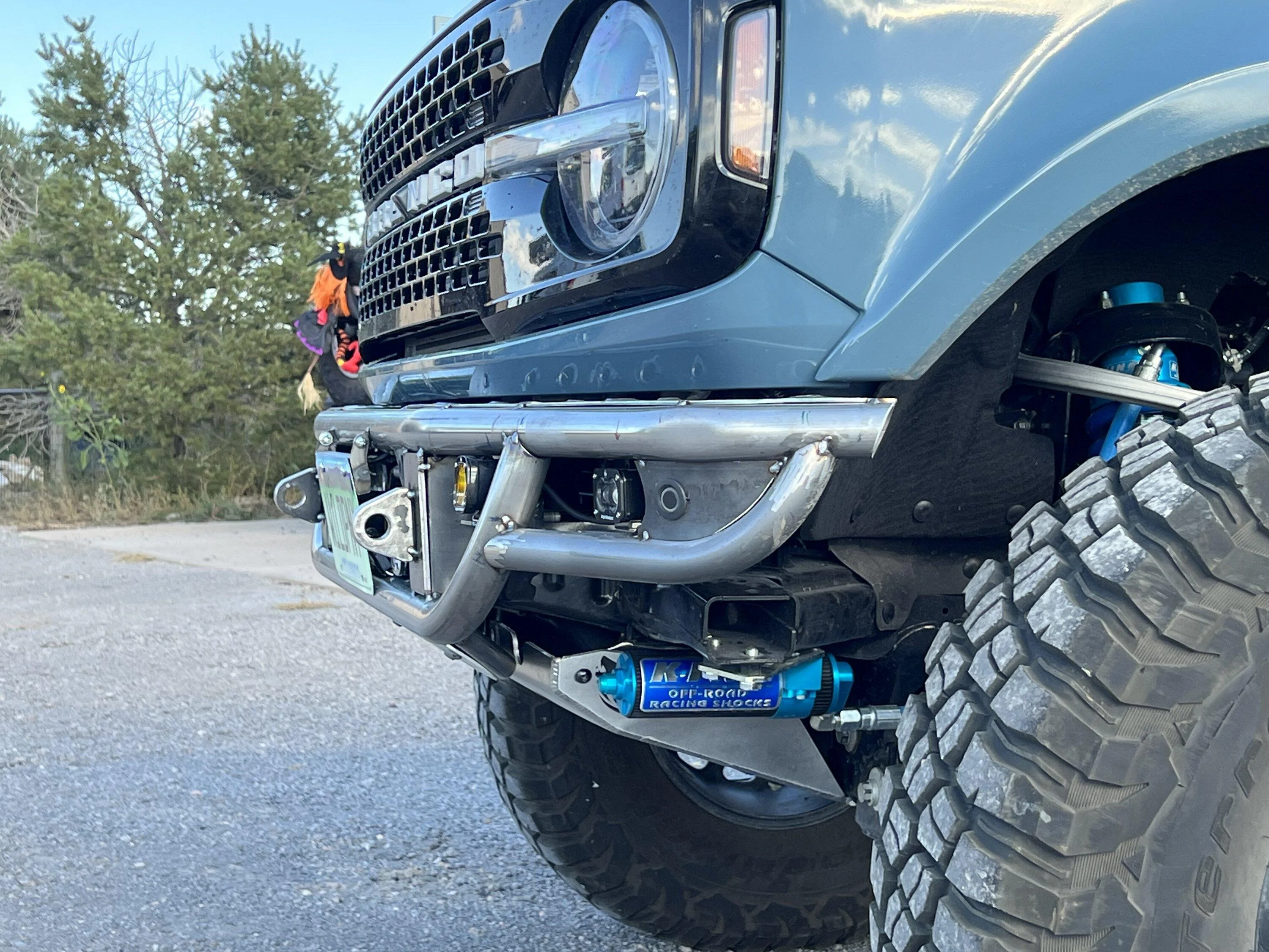

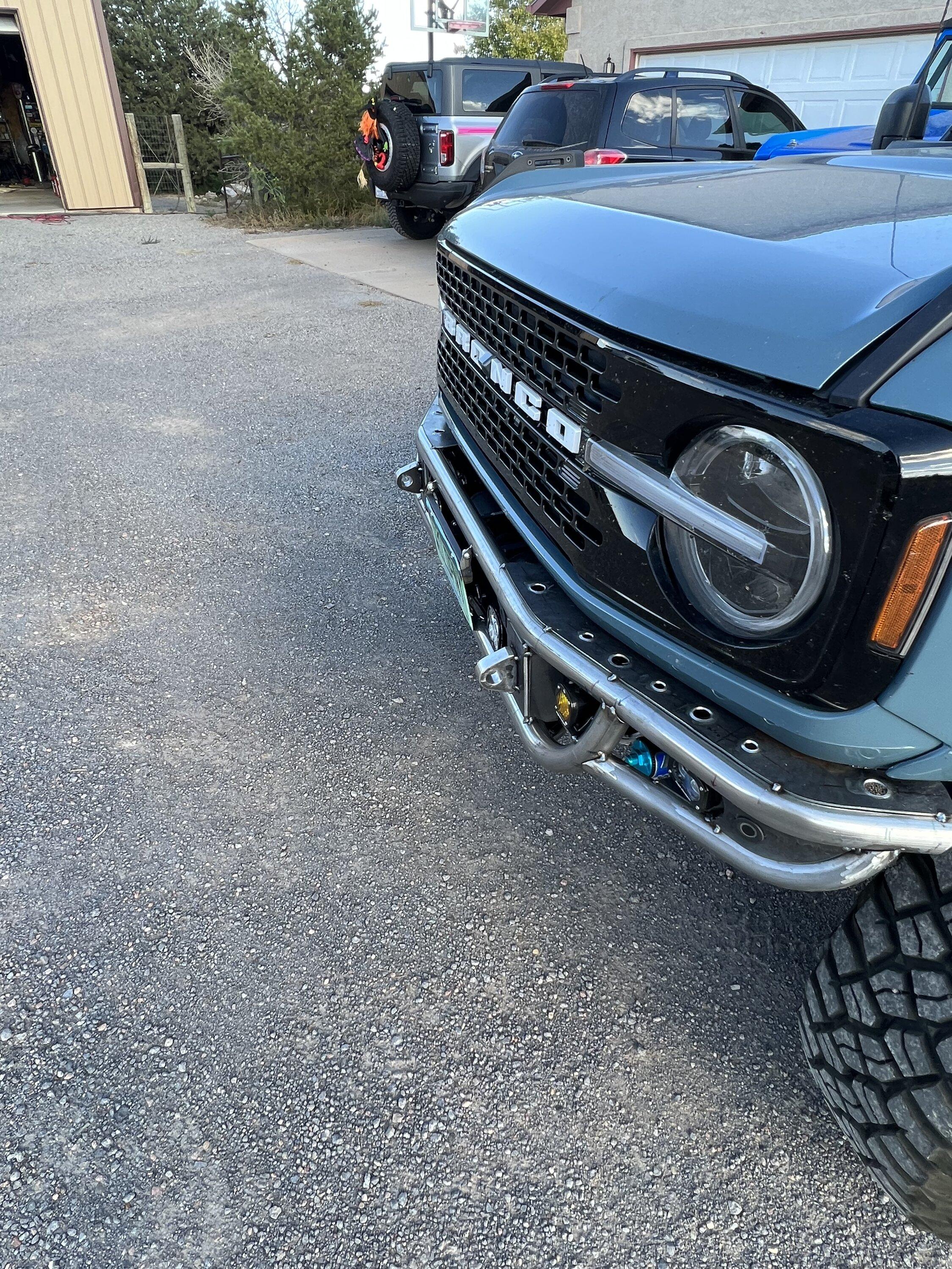

It can't be bought, but it's glorious when pulled off.
Hey!!! Didn't see post on this elsewhere???
Beat me to it by a few miles...looks really good...
What do you mean, can't be bought?!
I got a dollar...or 2,500...

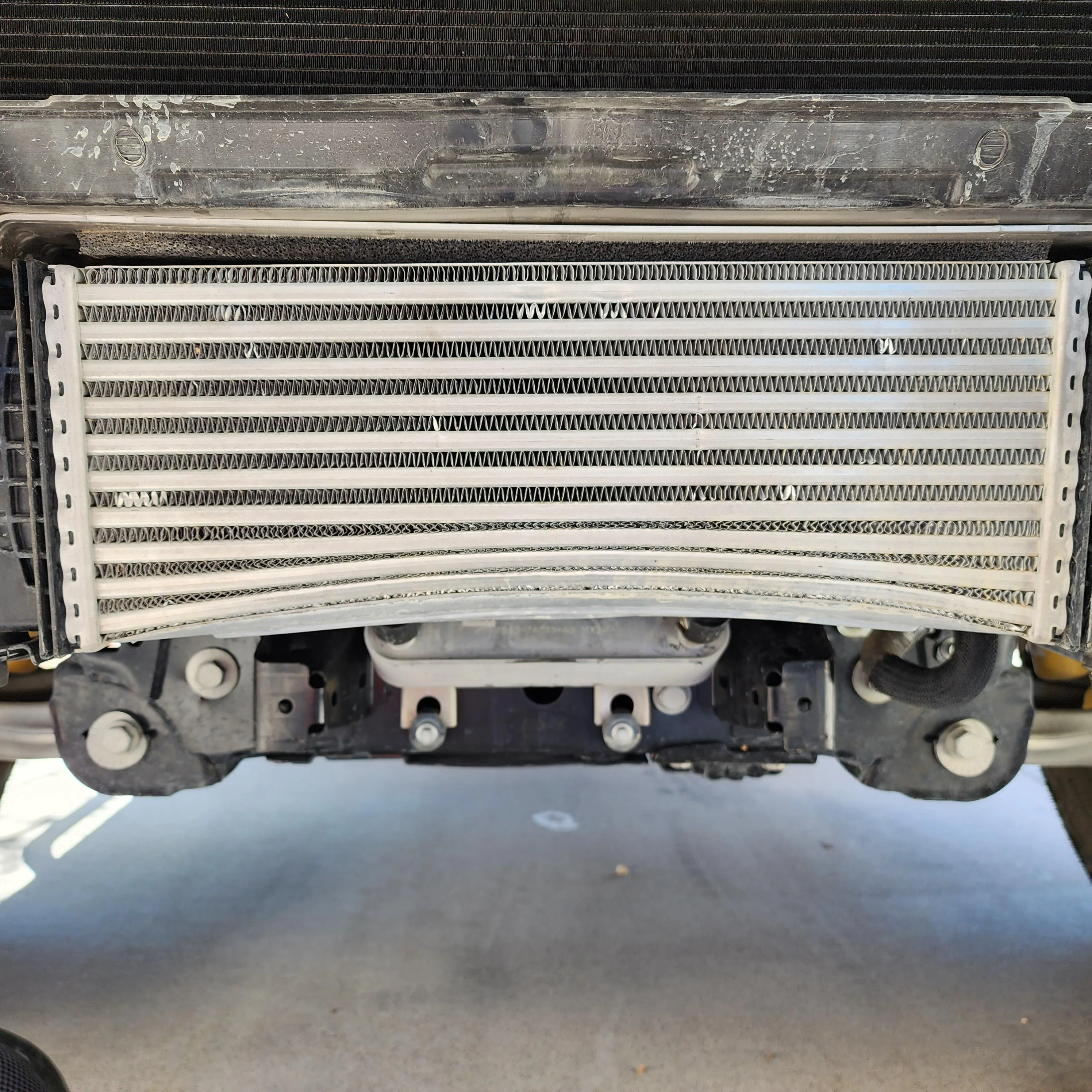

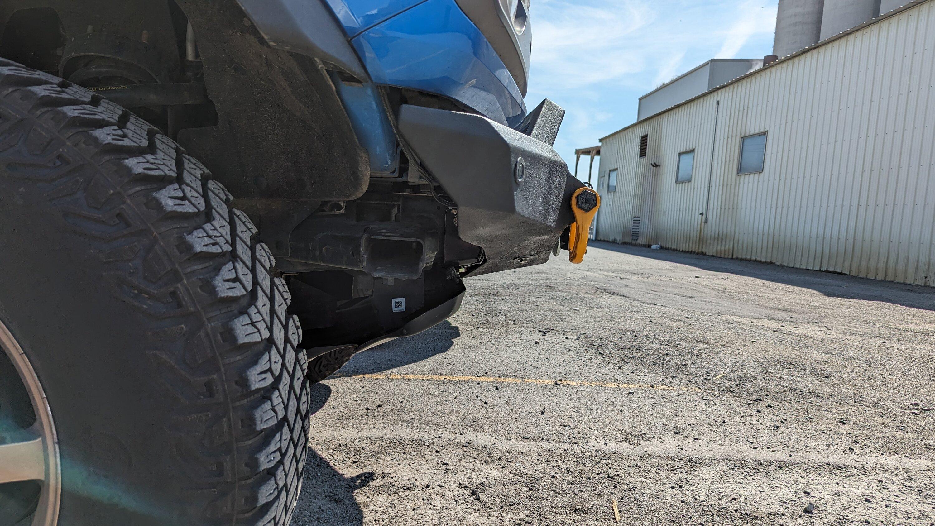

If you don't have good skids (once upon a time/from the factory) and occasionally offroad like a careless idiot (👋), this, THIS is what's wrong:
You don't put fragile ish in harm's way.
Or you're Ford, and you DO!
OK, that makes sense...

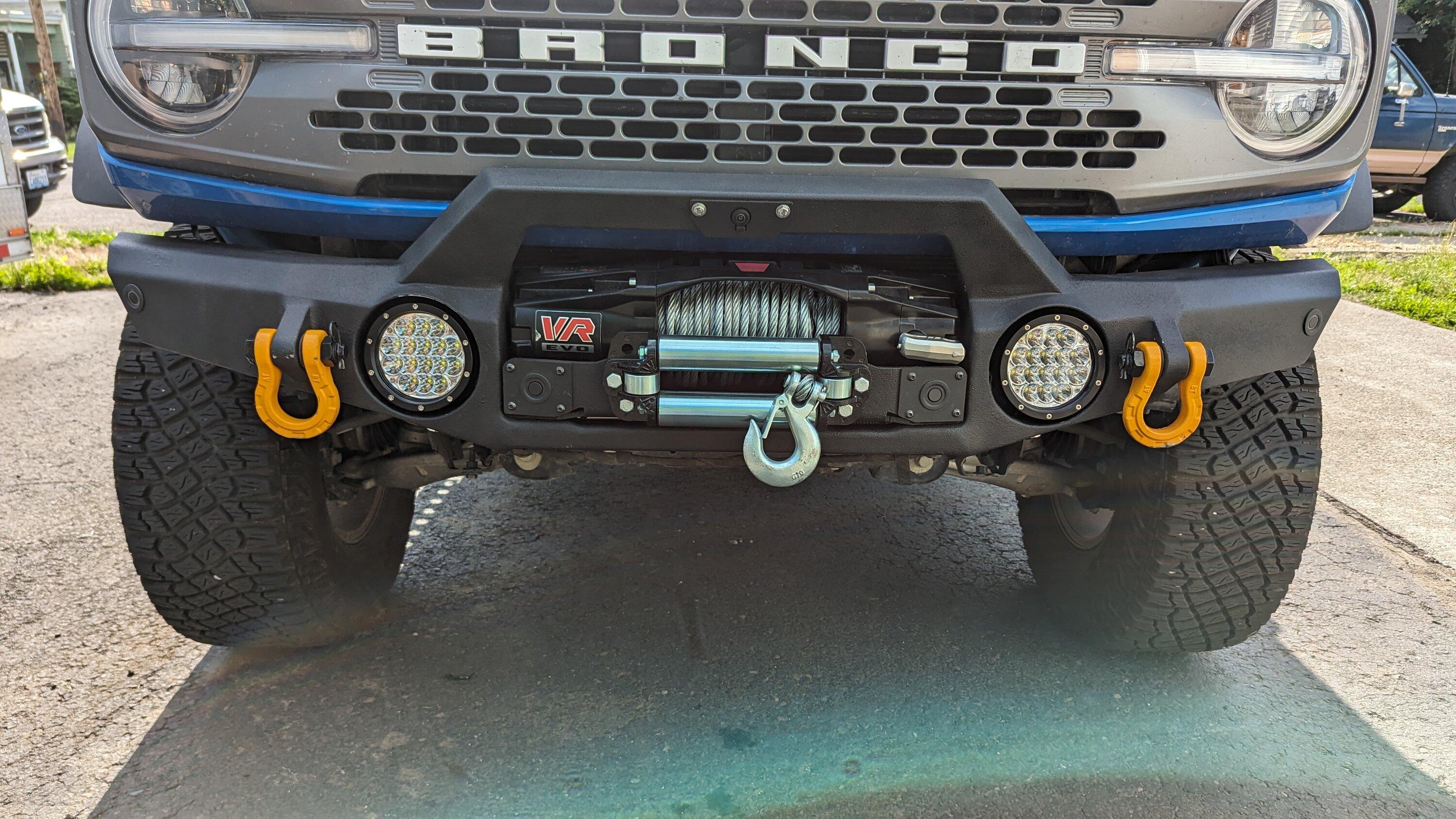

Ford always puts too small of ICs in and they suffer from heat soak. Also the shutters were in my way, a winch fits perfectly in that spot without sticking out like everyone else.

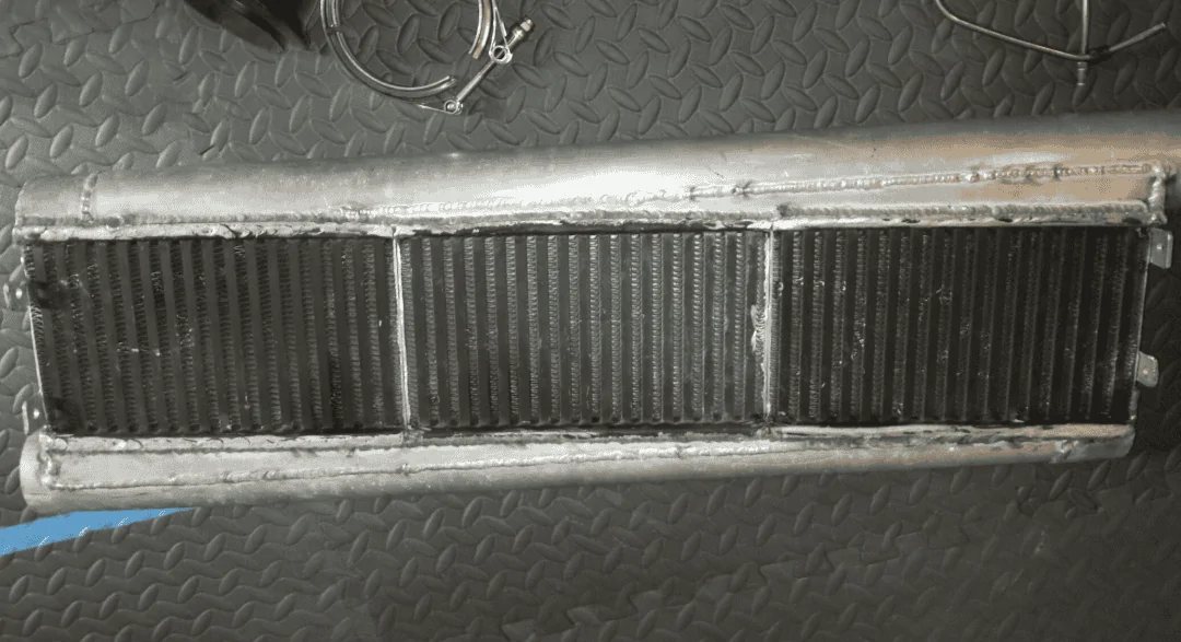

Yes, a history that dates back to the 1984 SVO with it small intercooler placed directly above the exhaust manifold.
Side note, back in my 2.3T days I chopped up 3 of those ic's, welded them together (ok, my brother did the aluminum welding) and made a mega intercooler.
Ford Bronco correct way to remove intercooler shutters Screenshot_20231101-184856

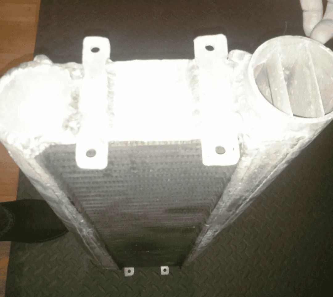

Even had internal baffling to ensure even air distribution.
Ford Bronco correct way to remove intercooler shutters Screenshot_20231101-185201

LOL....waiting on that triple threat to hit the market.
