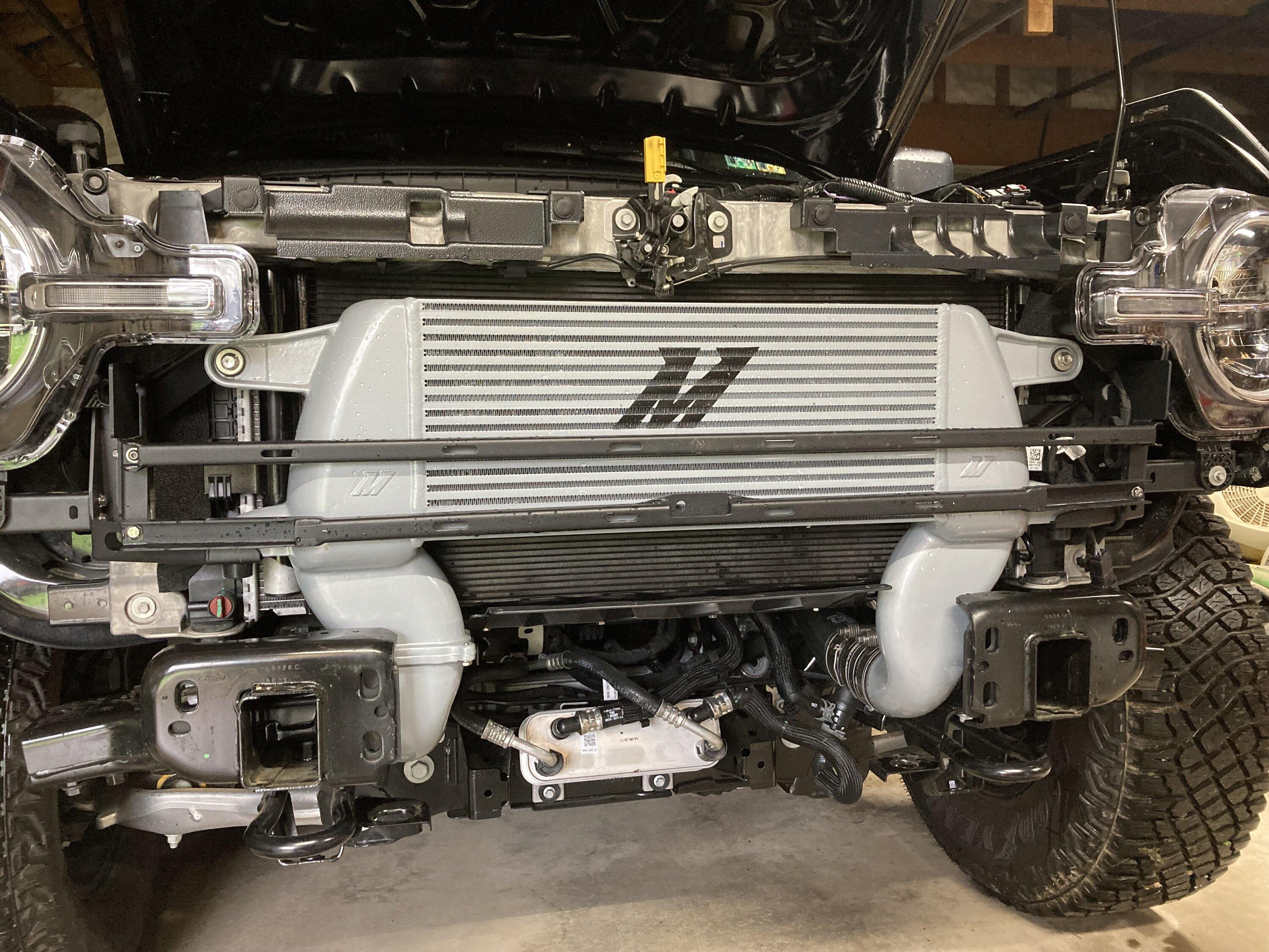

Installed mishimoto high mount IC few months ago
Factory instructions delete both IC shutter and much larger radiator shutter, motors and all, as a result. There is I think just a plug seal, (possibly a jumper though), that they include for at least one of the shutters, which I installed per instructions
I have not had any dash lights or readily visible error messages, or any other related issues since install. Whatever forscan might show I do not know as I don't have an interface.
same here. No issues
THIS ๐Ÿ‘†๐Ÿ‘†๐Ÿ‘†๐Ÿ‘†๐Ÿ‘†๐Ÿ‘†๐Ÿ‘†๐Ÿ‘†๐Ÿ‘†๐Ÿ‘†๐Ÿ‘†๐Ÿ‘†๐Ÿ‘†๐Ÿ‘† was going to be my response as well.
High Mount Mishimoto here as well. ZERO issues. ZERO change in coolant temp. NO CELs. Just a dummy plug in the shutter wiring connector. No zip tying the motor out of the way. No Forscan.
Sorry if I seem bias but I also own a Procharged Fox Body and have had some experience with mounting an intercooler in front of the rad and had my doubts at first about what might happen, it is tight up front in the Bronc. But as I said I have had ZERO issues with coolant temp. Runs the same 4 bars as it did the first day I drove it home. Thought I might need a larger, more efficient rad, but I have not seen the need yet.

That looks wicked cool!
