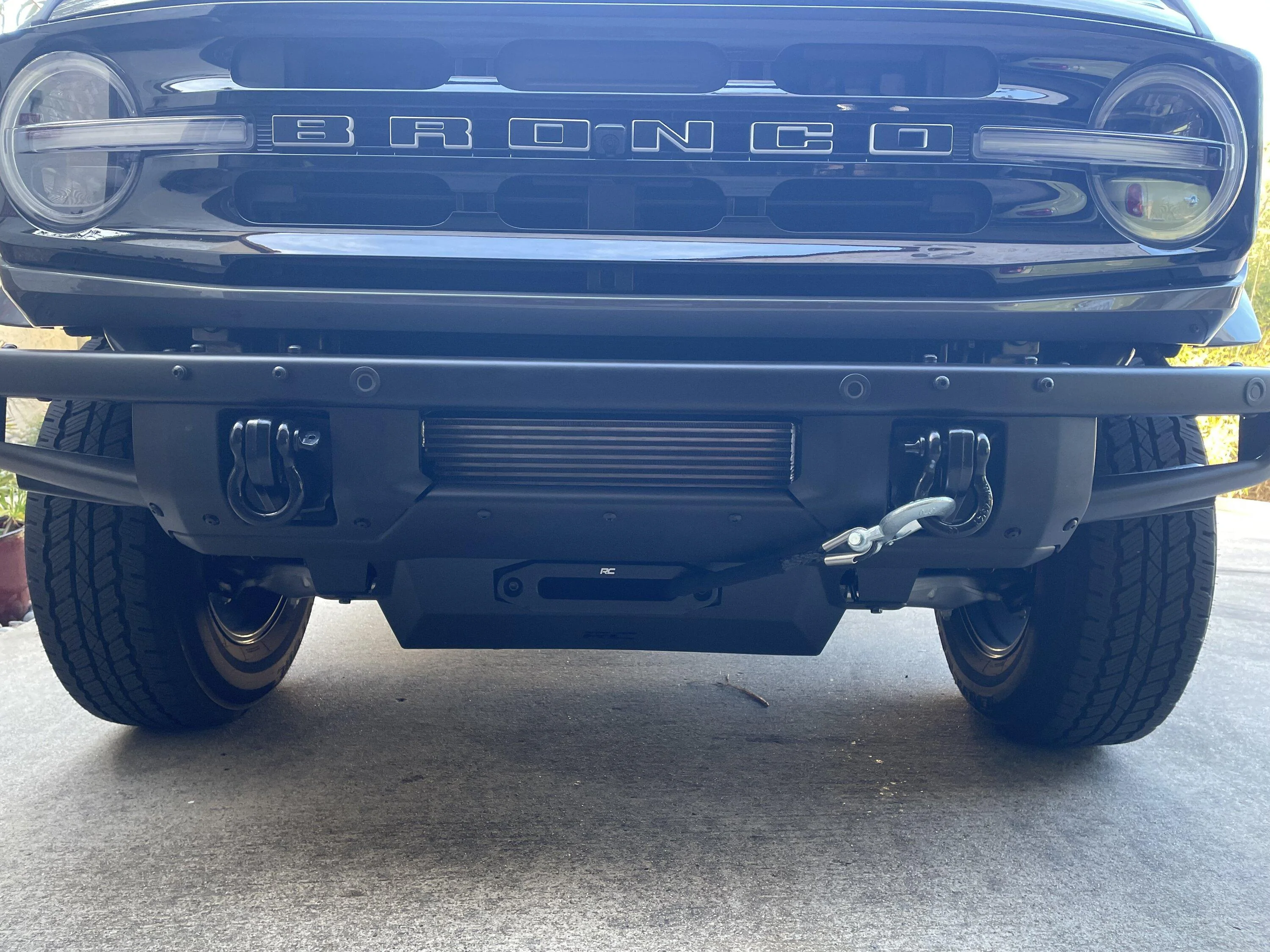

So what's wrong with the OEM intercooler and shutters? That a lot of people wants to replace
If you don't have good skids (once upon a time/from the factory) and occasionally offroad like a careless idiot (👋), this, THIS is what's wrong:
Ford Bronco correct way to remove intercooler shutters 20230318_120341
You don't put fragile ish in harm's way.
Or you're Ford, and you DO!

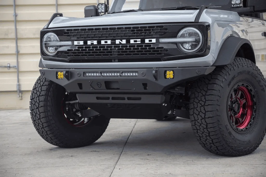

Unrelated, but what does removing the shutters from the IC have to do with an aftermarket bumper? I'm going to get a custom-fabricated copy of the JCR Crusader bumper, and was wondering if I needed to touch the intercooler in any way?

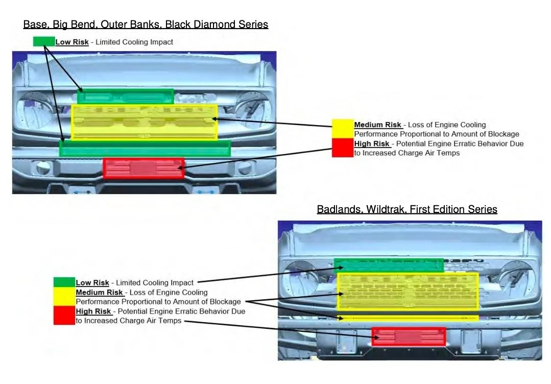

Unlike at least some folks who are trying to get GT3 performance out of their Broncos, I'm okay with the bone stock level of performance the 2.7 has thus far (especially for wheeling). I wouldn't mind slapping things on that would improve the longevity, or things that would provide a reasonable boost in mileage while maintaining the performance I already have, but my big concern is (especially after having worked for a dealership) that Ford would love to deny a warranty claim for just about anything they can. If any of us lose an engine and get a claim denied, even for something unrelated to the modifications (like, say, a valve) that would be a huge cost. Many of the bumpers do in fact block the very areas that Ford is very clear about not blocking, and yes there are fog light kits that do the same thing or license plate relocations that also do that so I'm just trying to avoid anything that could potentially screw me down the road. To determine if your potential bumper or add-on is going to block any of the areas for his indicated shouldn't be blocked, refer to this:
Ford Bronco correct way to remove intercooler shutters Screenshot_20230305_184118_Chrom
Clearly the hot zone is the intercooler...and I have no idea what Ford would say if there is a failure down the road even unrelated to relocating it, but doesn't seem like a stretch that someone could say "hey you put something that generates heat in front of something that is supposed to have cool air flowing through it so we're going to deny you." Hopefully that isn't the case for anybody who goes with the aftermarket intercooler but as we've already read in the forum there have already been loads of claim denials for much less. I also don't want to be the person who doesn't do anything to the Bronco because I'm so fearful of warranty denials, but unless somebody has exact temperatures from the engine (not just going by the number of bars because that range can vary widely), and pre and post intercooler installation turbo and charge temps, and unbiased/objective dyno numbers pre and post aftermarket intercooler, I for one will just live vicariously through the pioneers.

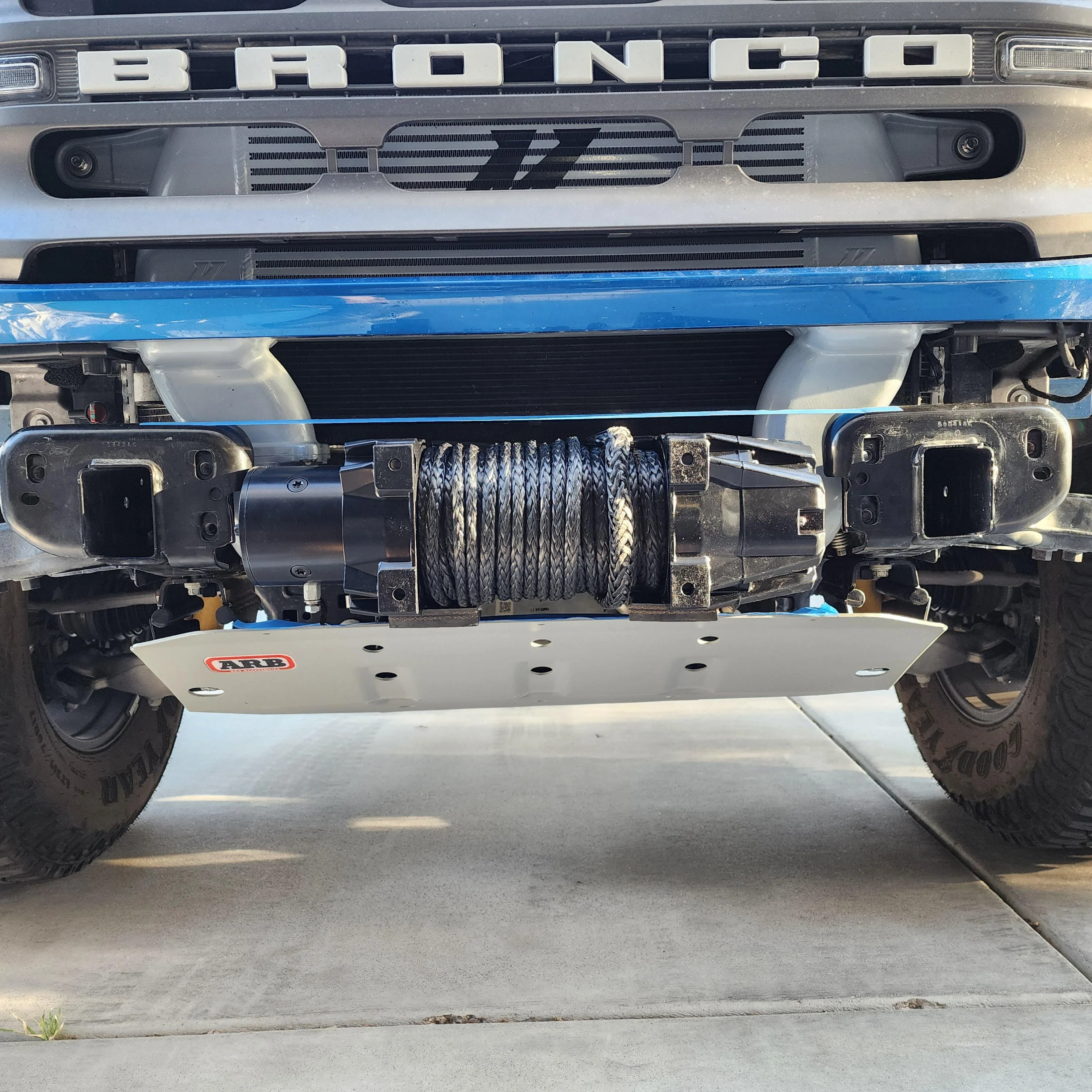

I have been pondering how to paint teeth on my IC without blocking the fins
