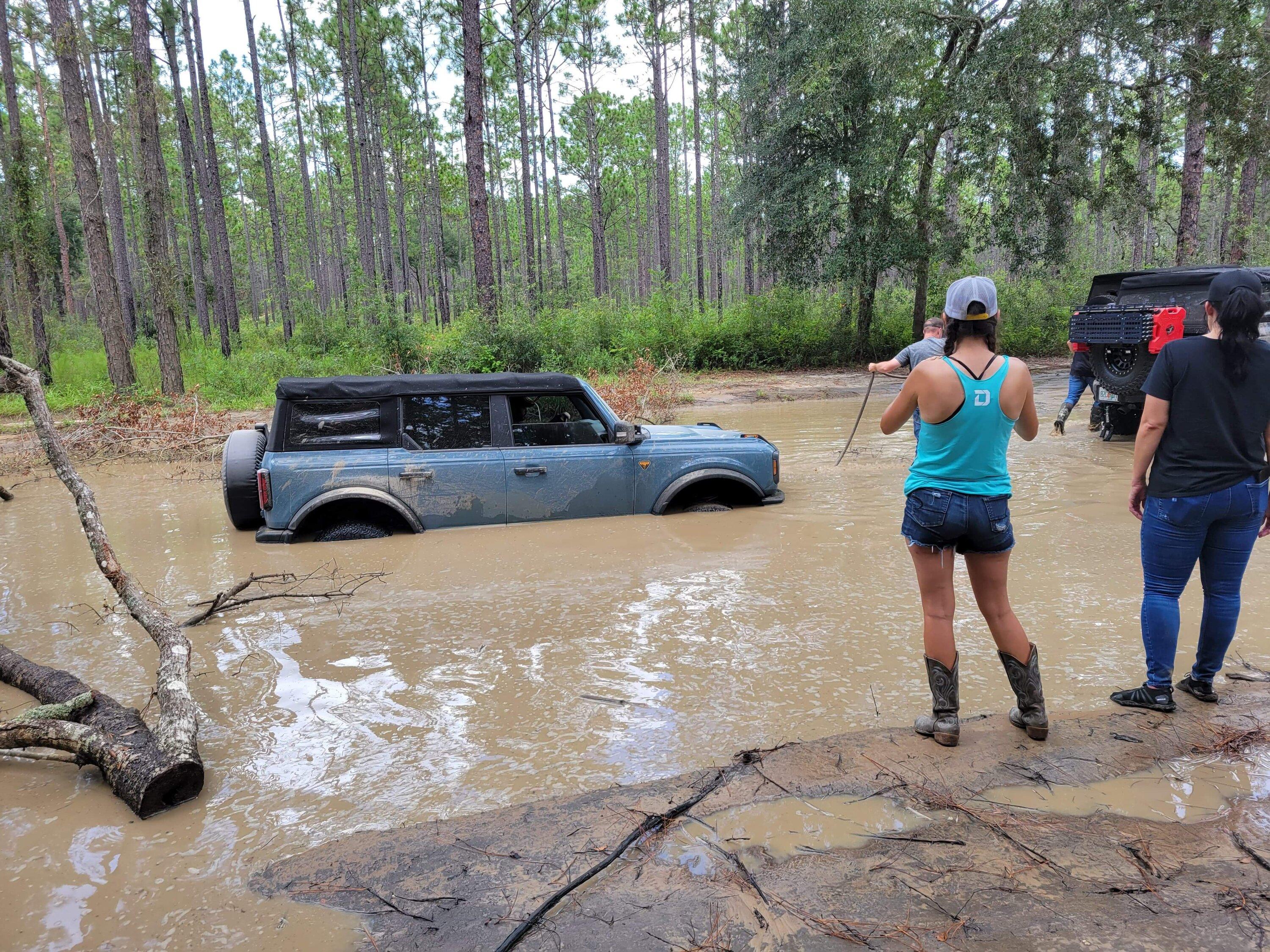

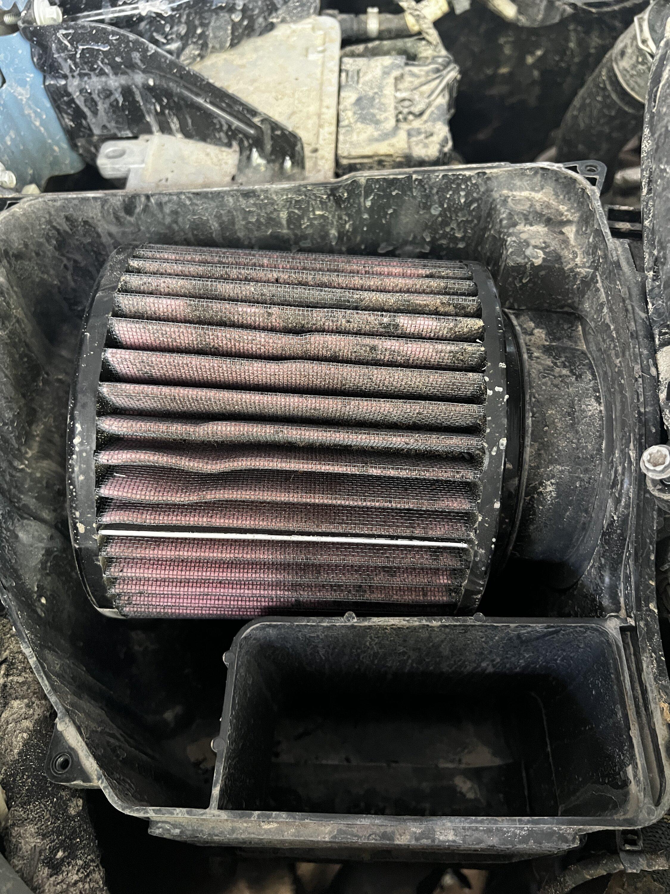

Sorry OP you are going through this and count myself lucky from my infamous dunk in the water. Water can very easily get into the air box. It is not uncommon from all the broncos I have been around that have been off-road. My bronco stalled in the water. Likely the K&N got clogged and it couldn't breathe but once pulled out and the filter box cleaned. It started right up and drove over an hour home. Been going 20k plus miles now since without one issue (alternator included). I count myself very lucky. I have since added a snorkel because water crossings are very prevalent in Florida. I don't think a little water from your air box based on the photo was your culprit. I believe it was through some other means.
