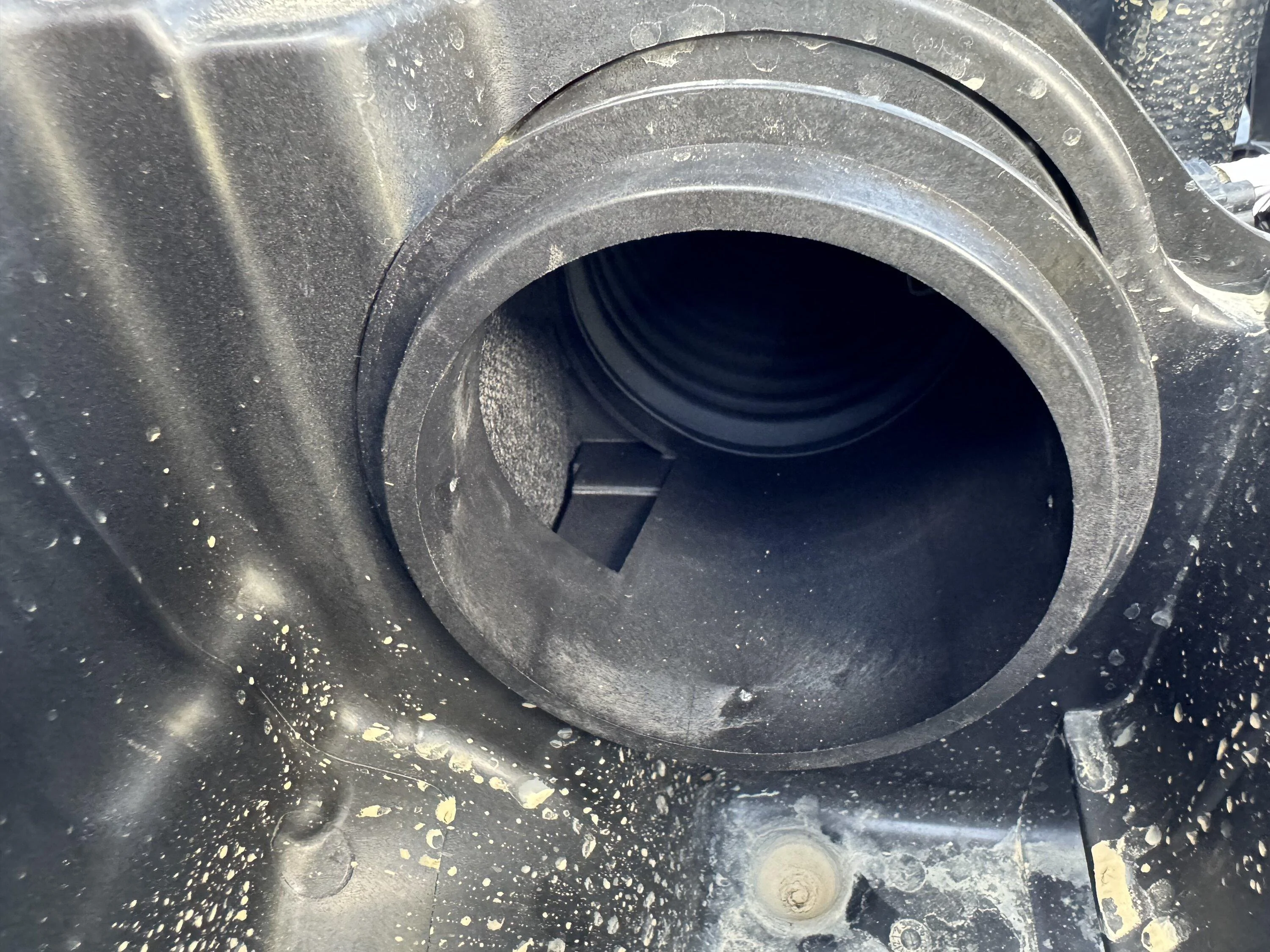

Apparently you didn’t see the picture of the airbox with a few splatters of water in it and the clean filter. Look at that water and tell me it wouldn’t leave an actual water line in the air box? Or on the filter. Or the air intake tube that didn’t have one sign of water entry. But I’m wasting my time. Think what you want to think. As I’ve said, others have been helpful and I’m thankful for that.

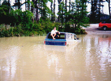

Here's how you get water in your oil, if you really want too.
(yes, did this on purpose, but when someone gives you two broncos
for $300, what's a guy to do. It was almost 20 years ago, when FSB's were
worth nothing) .

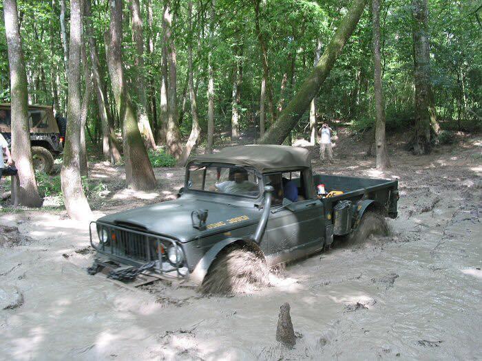

I’ve filled a 53 m38a1 f134 with water and here’s a functioning snorkel on a Cummins 4bt…..
I said it in an earlier post. The filter in the photo has never seen a drop of water…. But then again is that the filter that was on it when it sunk?

It’s the original filter, all you have is my word on it. And I posted before but this is the original air tube leading from it
Well, if f you do this all the time, with some rigs un-snorkled, you know that airbox of the OP is pretty darn clean, when you are talking the realm of water and muddy water airbox/intake ingestion.
Where is the water line in the airbox? (if there is one, it is on the very bottom of air cleaner box) Why isn't the entire inside of airbox covered in at least a muddy water stain. The fact that there are a ton of very small muddy water "stain" spots all over inside of airbox, tells you it did not get "swamped" by any means, not even close.

There isn't enough in the air filter housing that would lead me to believe water ingestion on the top end. The filter would show signs of collapse and the inlet tube doesn't have any spotting in it. Still, anything on the top end would've likely ended in a bent rod and immediate seizure. If there was water in the inlet side there will be some in the intercooler or evidence thereof.
