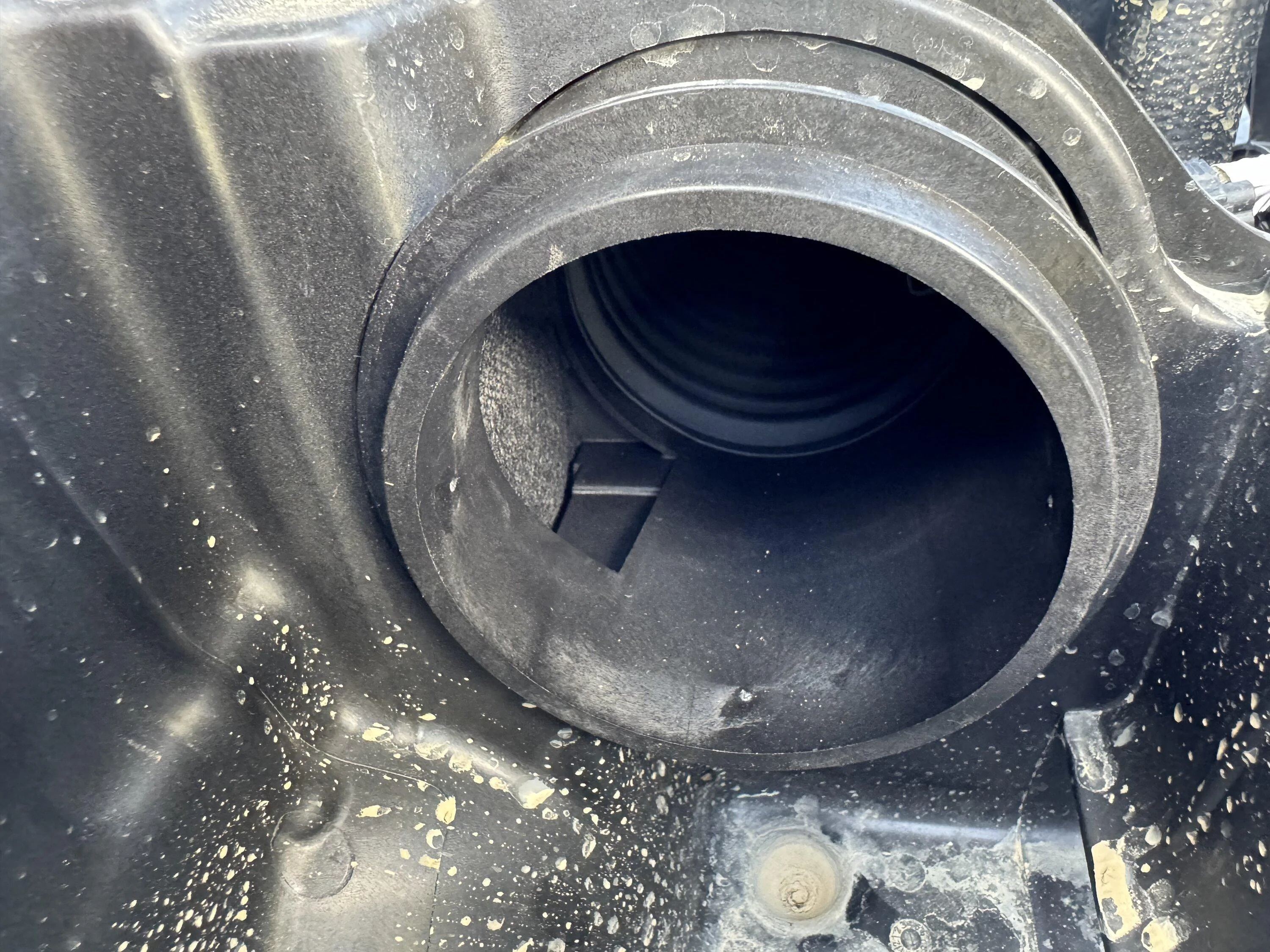

Had a chance to visit the ol’ boy today. So I took a quick pic of the air tube behind the filter.
Ford Bronco How can water enter the engine? 1695503602620
pretty dang clean.

Just from the picture you posted…… water most likely entered thru intake. The dried muddy water puddles in intake housing is obvious sign of water intrusion. Most likely when entering the puddle the water wave surged into intake. “Caked with mud” is an exaggeration by dealer. If water didn’t enter intake how else would dried water be in there?
all I can do is promise you there was no bow wave, the water was 10” below the intake. And for the incredibly small amount of splashes that got in the air box, isn’t there a trap door at the bottom of the box? Anyway, I got to visit the poor boy today and I took off the air filter and snapped this pic
Ford Bronco How can water enter the engine? IMG_3912
Pretty darned clean.
But again the real question is how would it be possible for water to enter the air intake and end up in the crankcase all while continuing to run relatively smoothly?
I agree that part is very clean……? Ya I c your point now. And I do agree it was nothing what I would ever say to be muddy yet alone caked on? That’s not good for dealer to compare what ur first photo looked like with anything like caked on mud. But you know I thought I remembered reading on here few months ago of same type problem. Similar scenario if I recall the front end was well above what should have been considered fording depth. It may be on here somewhere I just can’t find it. I’ll keep looking and let u know. Bummer bad luck.

They were probably my photos. And while I was laughably stuck, it wasn’t submerged. Right behind the front tires the truck was sitting on the frame, so the tires were sagging or dropping down making it look a lot deeper in than it was.

Besides the air intake, how can water enter the engine? I got stuck in water, level was a little above the bumper, below the headlights. (approximately 8 or 9" below air intake). Back wheels were never in the water. But there WAS water in the engine. The dealership said that the air filter was "caked with mud" and then sent me this picture:
Splattered a little from radiator fan with dirty water? Sure. Caked with mud? Hardly. I did check the filter and filter box when this happened and the filter was completely dry.

The photos from the intake, it dosnt seem like much dirt but you have to remember water dries up and leaves little behind. There wasn't much dirt in the water. Whatever dirt was in the water is what you see dried up along the intake. What I am trying to say is that the argument of the intake being "clean" or having little dirt residue as a indicator that very little water entered is not a strong argument. For example, if the water was entirely clean, say pool water, you would see no dirt at all but could still have a water blocked engine.
When I had my wrangler JL I would mud run it up in big bear. It would get covered in light streams of dirt just like what you see in your intake. The entire inside of the engine bay was also covered in it. Everything. But I never once ran it in water that went above the tire center caps. Ever. One of those mud fun days, water splashed up into engine bay and caused the engine light to come on. It was literally because water splashed into the intake for a second. My intake looked JUST LIKE YOURS (light streams of dirt). and it caused the engine light to come on. Now granted, the next day the engine light went away. I guess water didn't get all the way into the engine? IDK. My point being that water splashing into the intake from puddles no deeper then my 33" KO2 center caps and caused the engine light to come on.
What I am thinking happened in your case was that you had the bow of the bronco in water submerged for several minutes, at the least. Although the intake was not underwater. The fan is spinning, under water. Belts are spinning, under water. Water is constantly being churning up and sucked into the intake. Had you forged through that same water depth, nothing would have happened. But I think because you sat in it for prolonged time. Water was constantly being splashed into the intake.
