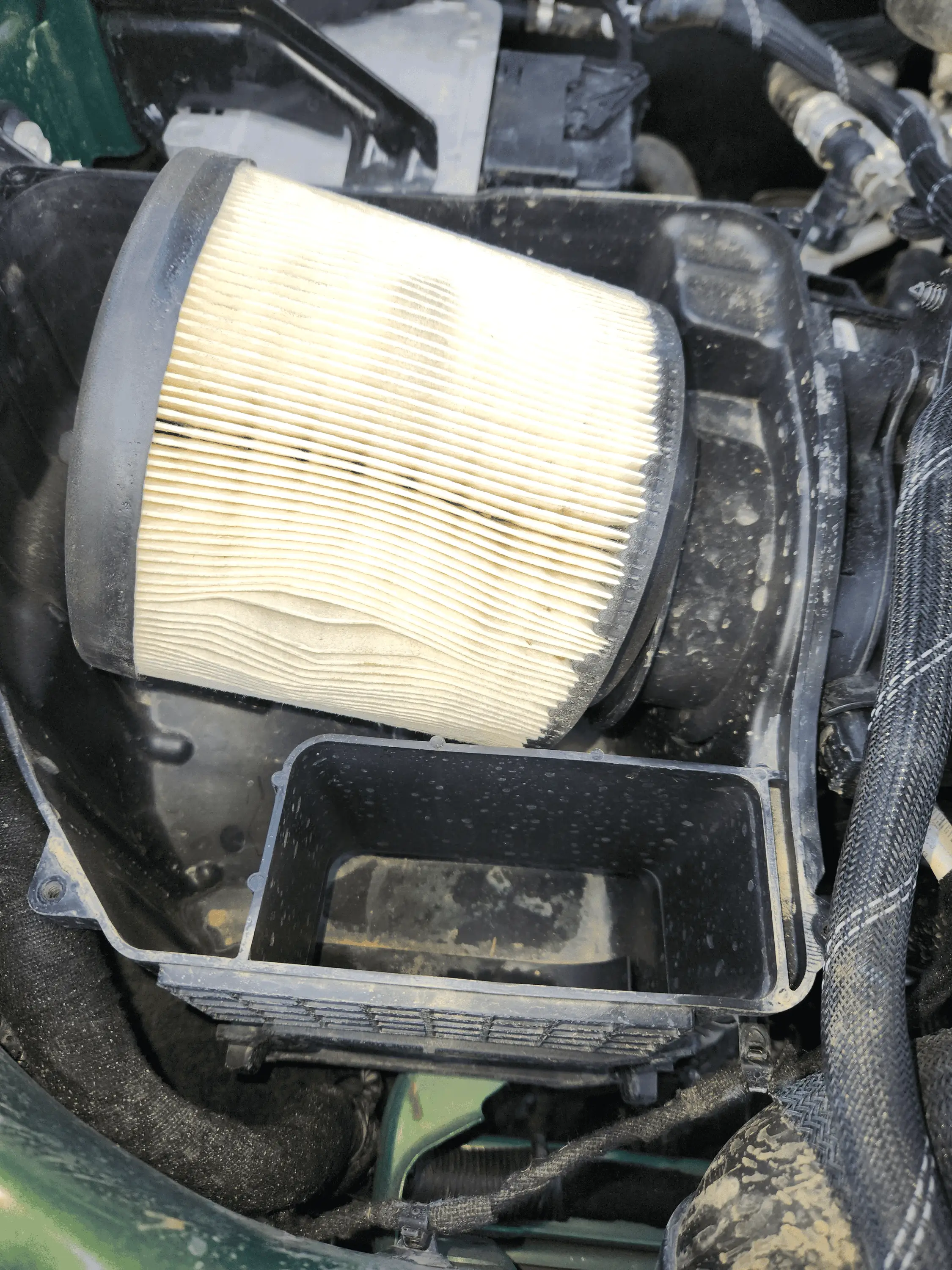

Had a chance to visit the ol’ boy today. So I took a quick pic of the air tube behind the filter.
pretty dang clean.
I don't get why people are still obsessed about water getting into the intake. Maybe they didn't read all the pages?
Side note:
I wonder what that square cutout is on the left side of the tube? From the pic it almost looks like felt.

Yeah I didn't notice the felt/foam piece until I looked at the picture, not sure. I 'm also not sure about the obsession with the water in the intake. And those that are sure that the water went in the intake have no answer to how it came in, the engine ran fine, and it made it's way to the crankcase.

Besides the air intake, how can water enter the engine? I got stuck in water, level was a little above the bumper, below the headlights. (approximately 8 or 9" below air intake). Back wheels were never in the water. But there WAS water in the engine. The dealership said that the air filter was "caked with mud" and then sent me this picture:
Splattered a little from radiator fan with dirty water? Sure. Caked with mud? Hardly. I did check the filter and filter box when this happened and the filter was completely dry.
I contend that water entered the crankcase somewhere. Faulty PCV valve seal? Not sure, that's why I'm asking here. I posted a couple weeks ago and mostly got replies telling me how stupid I am. And that's fine it just doesn't help me much. I'm just asking for opinions on entry points for water and mud. Because now I have a seized engine and Ford says it came in the intake and won't cover it. But it didn't and I'm going to be out $10,000. So please help if you can.

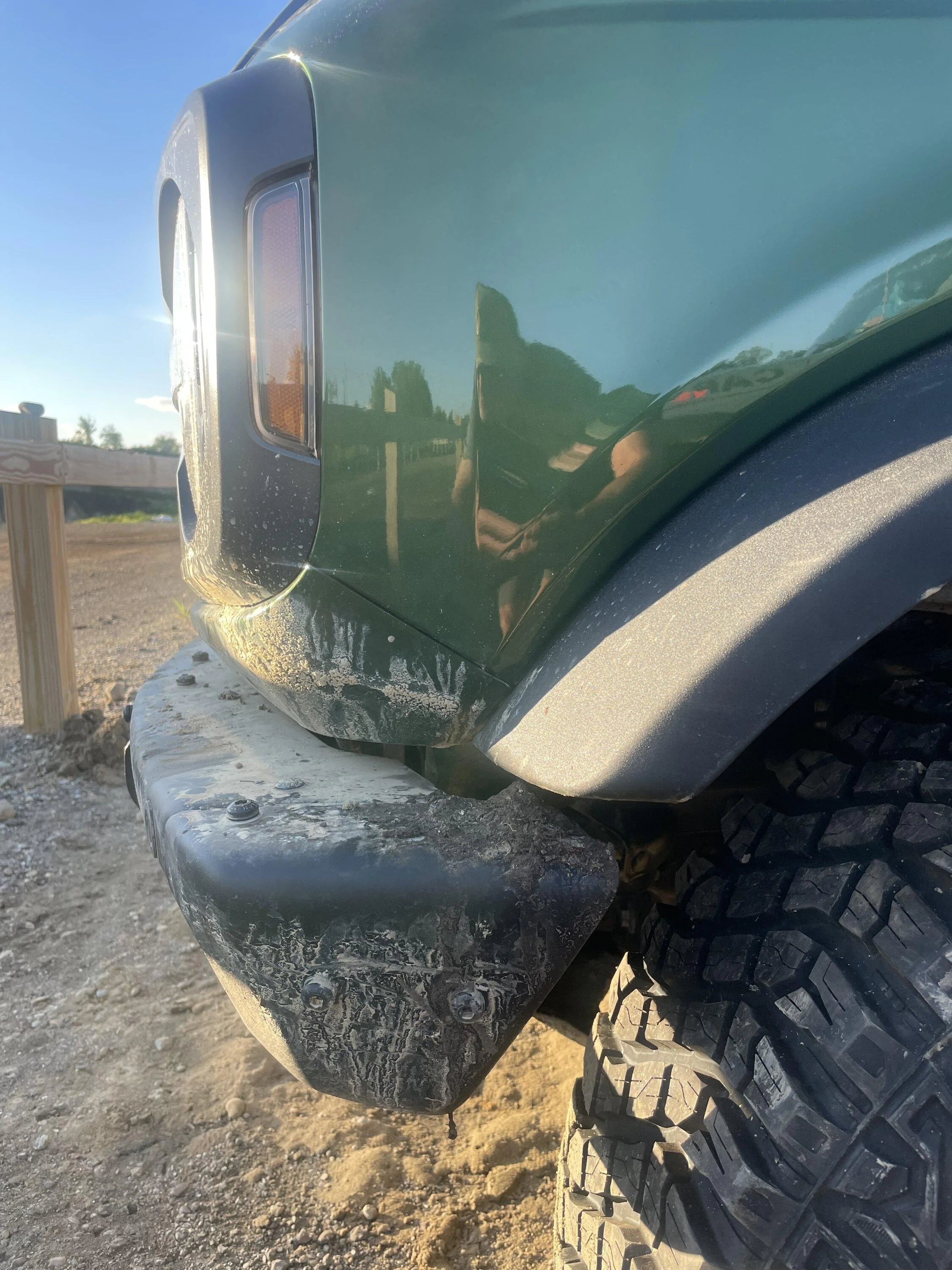

I do have pictures showing the water level below the headlights, a couple inches over the bumper. I need to measure another sasquatch to see if that's less than 33.5".

Also, not sure when you took the pic, but your air filter isn’t connected all the way on and I can’t help but wonder how it got that way? From factory install, it’s jammed in there pretty good. I have a K&N replacement and have honestly checked it once to ensure I stuck it on good and tight. Maybe yours was just placed that way after the episode and having it removed to look at it.

What is the narrative I’m building? I drove my front tires into a muddy mess, dropped to the frame, water line between the bumper and the headlight. Got winched out. Completely clean inlet tube past the air filter. Truck always ran fine, until a slight miss at idle. Checked and found the milkshake-y oil and drained it and had it towed. So instead of telling me I’m making the story up tell me how a truck runs fine but gets water in the oil. Forget it, you can’t. I’ve gotten a few helpful ideas of how to diagnose and am going to pursue those. So in that respect it has been useful.

Here is a pic of the waterline. Notice how completely muddy and sloppy it is above that. I really must have hit it hard!

Now notice the angle of the waterline. Draw a line from that through the tire to the rock rail I was sitting on. Will give you an idea of the depth of the water. I’ve wanted to find another bronco to be estimate the line but what, to the top of the rim maybe?
mmmm.
"There is probably a reason there are no tire tracks leading up to that puddle. These trucks are only as tough as you treat them. Everything can break if you go in over your head. The good thing is you got out and only need and oil change and an alternator. "
" It's not a U-boat, Captain."
" from the pic it looks like he is still above the intake trap door"
" Was the firstpost edited?"
" Yes. And it looks like other posts were deleted as well. :cautious: "
You removed the pictures/video/et al and then started a new thread on the topic. Whether you are actually in the right or not, it is suspect. Sorry that you don't like it, it is how it reads.

Apparently you didn’t see the picture of the airbox with a few splatters of water in it and the clean filter. Look at that water and tell me it wouldn’t leave an actual water line in the air box? Or on the filter. Or the air intake tube that didn’t have one sign of water entry. But I’m wasting my time. Think what you want to think. As I’ve said, others have been helpful and I’m thankful for that.
