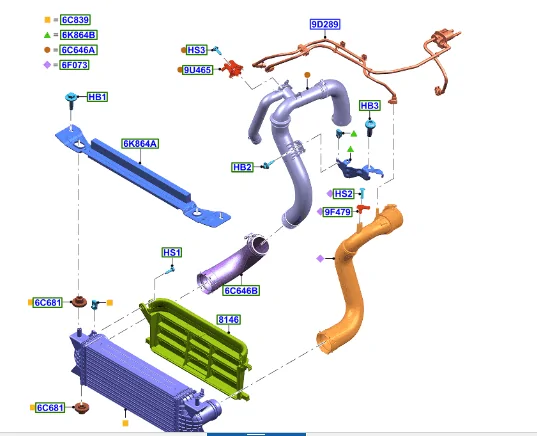

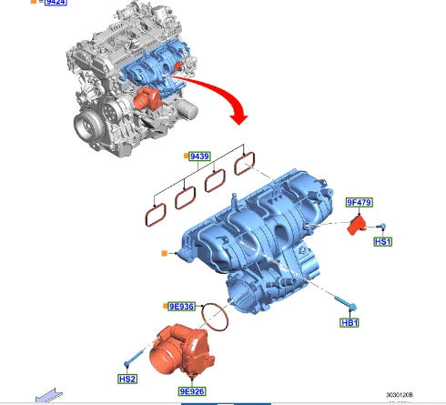

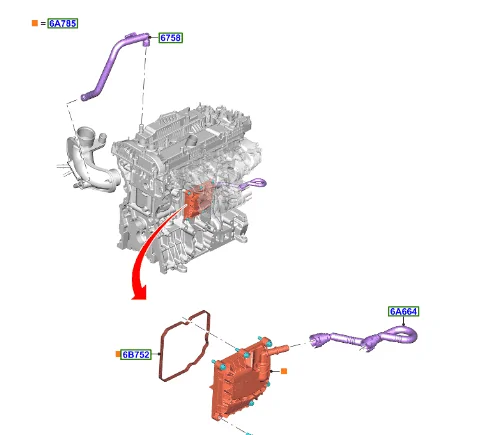

There's no way to know. I would say that it must have driven well enough for them to let it go as fixed. I'd assume they didn't check the engine since it ran fine and there was no reason to expect it wouldn't. literally everything points to the water not getting into the air intake.
The theory that it went in the intake, passed through the entire engine to the crankcase, all while running fine just doesn't 'hold water' harhar.
So when it went to the dealer for the alternator there was no mention of any other issues, correct?
Just about the only way for water to get to the crankcase via the intake is past the rings, and that's not easy.

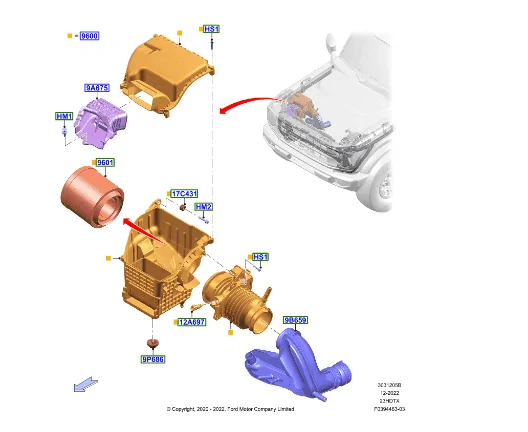

Can we assume the air filter is ajar because someone took it off?

Yes that's not easy. Actually impossible. The amount of water in the crankcase would have definitely hydro-locked the engine if it had come in the intake. I did take the air filter off the day it happened to look at it. I'm not sure if I didn't secure it back on or somebody else also had it off. It's entirely possible it was me.
I'm certain was the 'caked with mud' air filter comment that got me denied. But nobody will walk that back.
