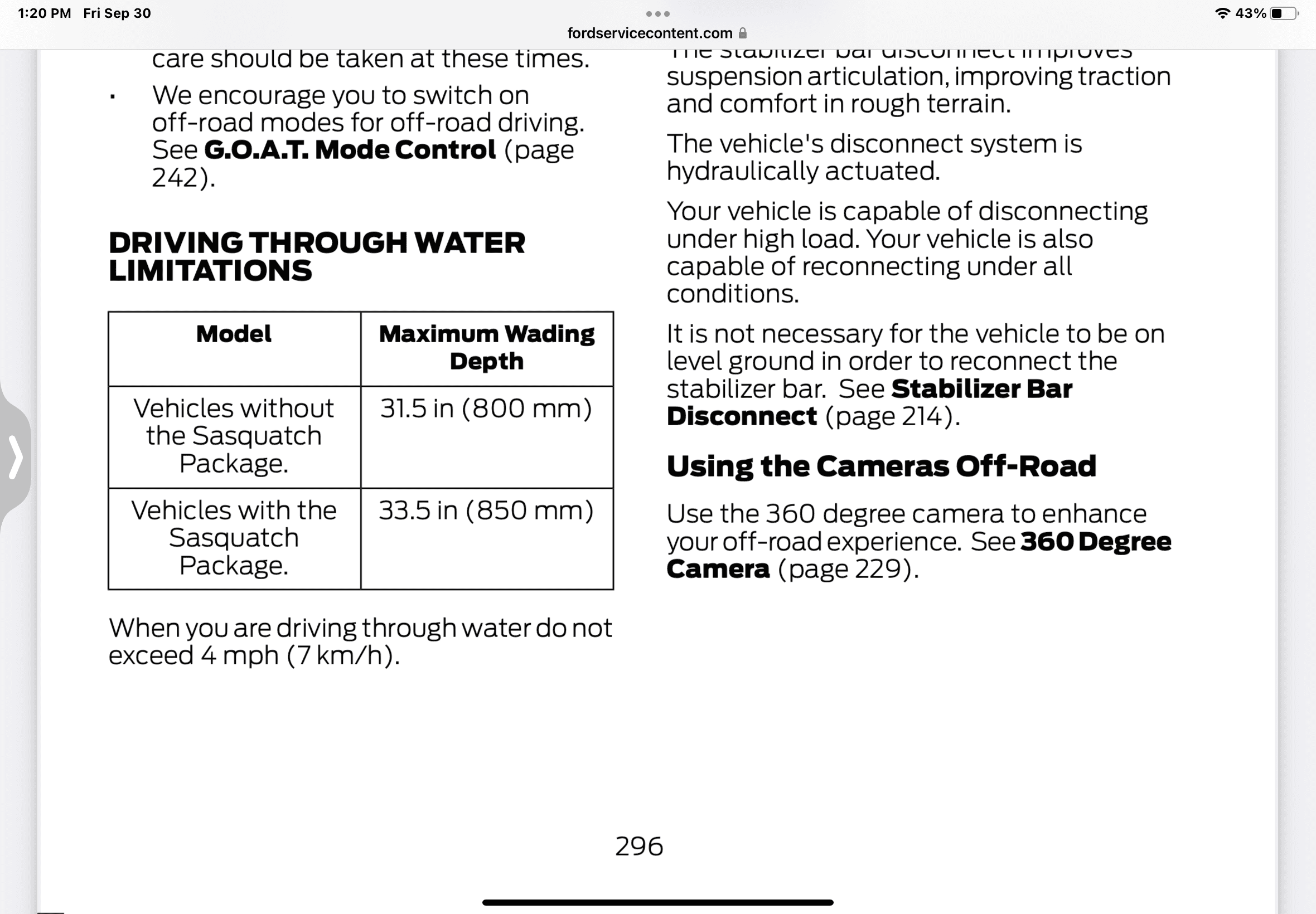

I do have pictures showing the water level below the headlights, a couple inches over the bumper. I need to measure another sasquatch to see if that's less than 33.5".

Off Roadeo rep said Sasquatch Bronco fording limit was top of the bumper; and tire.
Sas 33.5, Everglades is 36.4, Raptor 37.
