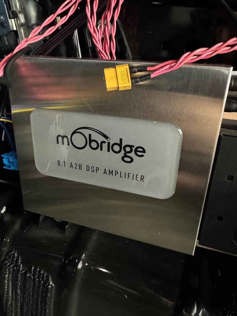

Does the pink wire need to be connected to the factory sub? I’m not sure where to plug the yellow connector to? I have a kicker sub in the oem enclosure using the factory wiring.
Ford Bronco Hi all IMG_9560
mObridge
mObridge
Base Sponsor (Level 1)
Fraser
Mar 20, 2023
257
367
Orange County, California
BMW e92 328
You can cut that connector off. Some sub boxes have it done don't, if you don't just cut it off and wire directly to your sub
