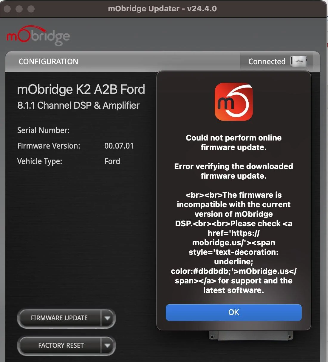

Need a little help with firmware update. Im getting the following error. Mac - Ventura
Did you ever get this sorted? I'm in the same boat now.
I'm running a w/ MAC Sonoma.
You need to use mObridge DSP not mObridge updater and it should all work
Got it working. didnt know there was an updated mObridge DSP. Tried to update with the old one. Was able to update the firmware. Once the update is done does the bronco tune need to be reapplied? I ask because my system doesn't sound the same.

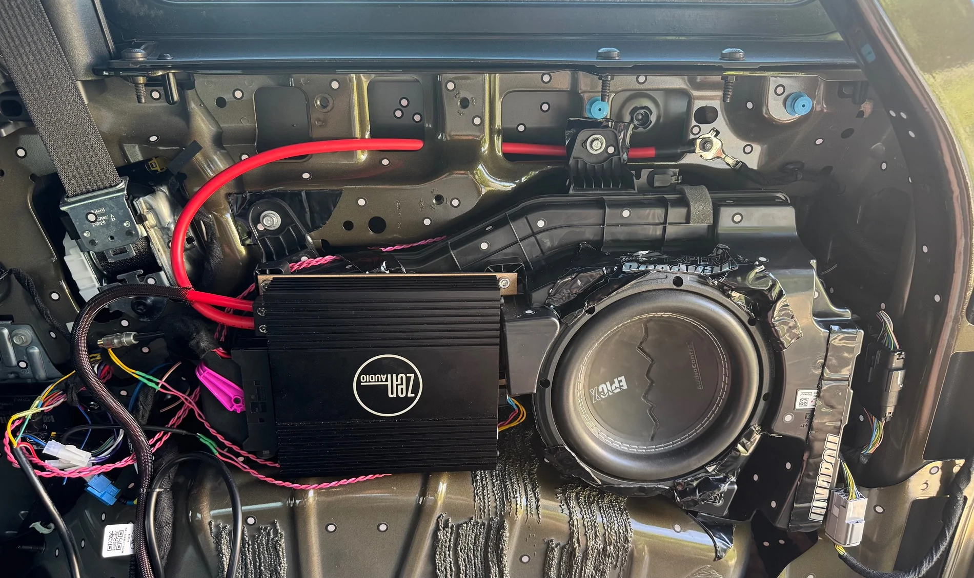

Sneak peak!
We just got done installing the next generation amplifier into a 2024 Braptor.
More power, lower distortion, next gen DSP. Wiring was cleaned up before the panel was put back on!
1) it is now optional to run the ACM harness. If you do not plan on upgrading rear pods to 6inch then you can leave the headunit running the center and rear pods and the zen amp DSP can control them. This means the only wire you have to run is the power wire <1hr job
2) this is exactly the install we did, we kept the b&O speakers and just upgraded the sub. Night and day difference and tune file is available!
3) can't comment as we did not.
