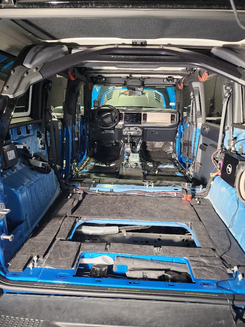

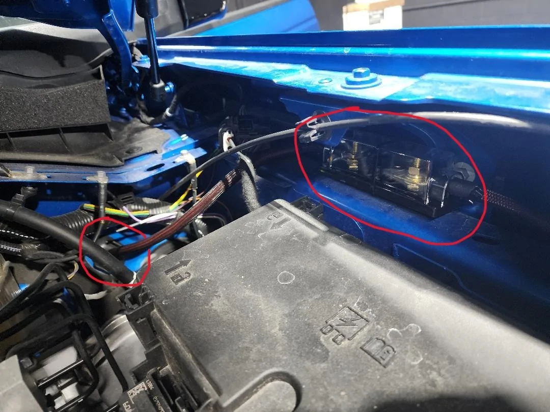

Hi All - wanted to follow up on my installation:
In short - the new Zen Audio kit seems super. A few things need to be addressed on install - which I will highlight. Fraser is/was great during the install. I am glad I was able to work with him. However, I did get some mis information from others at NavTV that had slowed me up quite a bit. So if you are working with NavTV - make sure you get with Fraser !
I have a 2024 Bronco Raptor - so got the kit with the the extra ACM harness. Also - I was going to do the install at the same time I was taking out the interior for sound insulation. This made the install very easy. I had a friend helping me - who tears cars apart quite often, he was fantastic at getting all the trim pieces out, as well as putting them back in ( which was more difficult & challenging given the added thickness of all the resonix layers ).

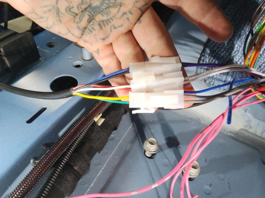

First note: On page 66 of the install ( for 2024 and earlier ), the wire colors of the oem plugs did not match up. Find attached a photo and the colors I had in my Bronco:
White wires went to red/orange and white
Gray wires went to yellow and green
Purple wires went to black and blue

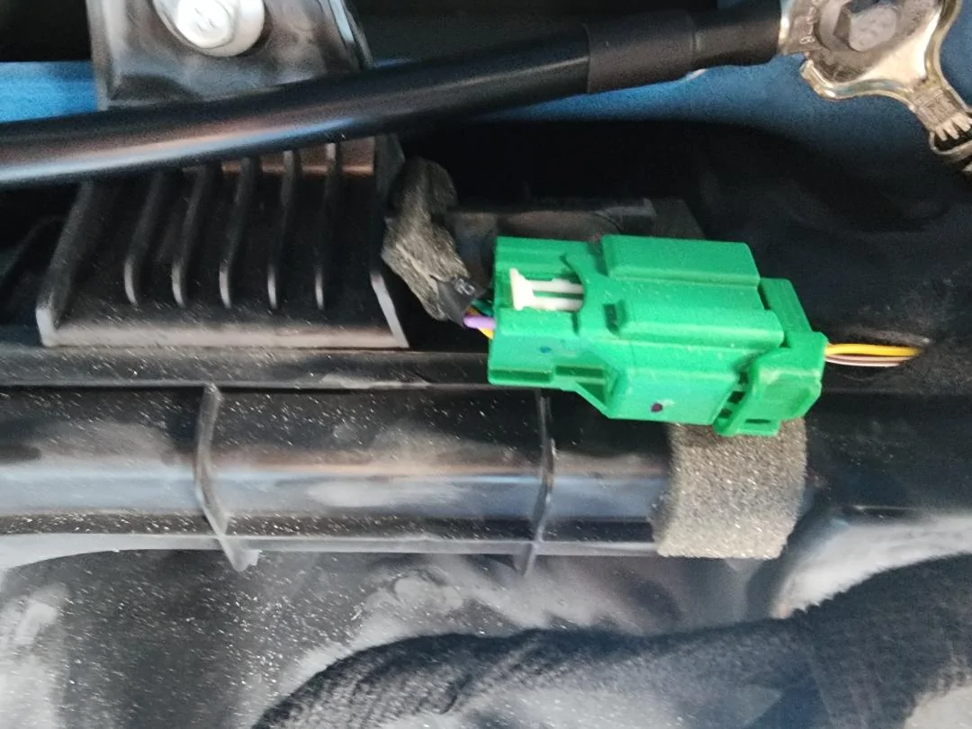

Second Note: This kit does not come pre wired to the existing subwoofer. This is for two reasons - I guess the existing subwoofer wiring was problematic/unrelatable and also that the OEM subwoofer cannot handle the power of the of the Zen Audio amp ( you can turn down the sub gain though ). I found this out from Fraser during the install. He recommended a few subwoofer speakers that can drop in to the oem subwoofer box with a little bit of work and highly recommends that this be done. Since I did not have any of that I just disconnected the subwoofer ( green plug ) and will attempt later on. It would have been ideal to at the time of install - as the molding had to be forced back a bit do to the extra thickness of the carpet from the sound insulation which pinched the plastic trim a bit. Not sure if i want to pull that out again - but maybe it will conform a bit over time. Here are the wiring connections you want to connect if you use the existing subwoofer ( again - turn down the gain ):
so you want to cut the green plug off on the top of the sub box and connect:
Yellow - pink
green - pink
black - pink/silver
purple - pink/silver
If you add a subwoofer speaker to the existing enclousure - I think we will need to know what the pink, pink, pink/silver and pink/silver are and what to connect to connect to the after market subwoofer. Otherwsise the Zen amp has rca out :)
Third Note: On the pre existing DSP settings, the rear quad speakers ( for rear fill ) our dialed down an awful lot. To much so in my opinion. Fraser said you can turn the gains up in the software - but I had not gotten to that stage yet.
So - all in all, a good system, but still a little left for me to do ( get a subwoofer and then massage into the oem sub box ).
