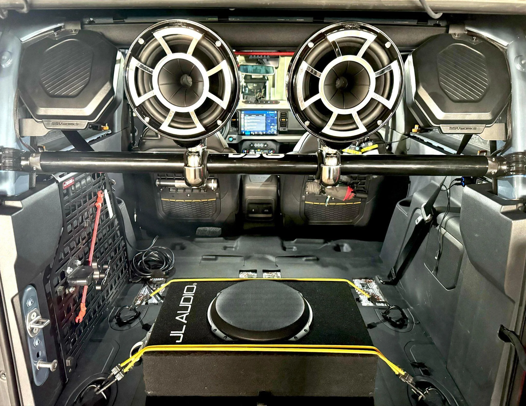

I have a 2-Door and can tell you that the Mobridge WILL fit, just takes a bit of "driveway engineering" and everything sounds 10x better than before (especially after tuning help from Fraser!). Customer service is second to none - Fraser even sent me custom firmware to help with a power issue I was having - you're just not going to get that from anyone else.
I have the Mobridge system running everything including upgraded 6.5'' pods and the 8'' wakeboarding cans. I had originally put in an 8'' Kicker sub to replace the stock, so Mobridge DSP is driving that as well.
Everything except the 12'' JL Subwoofer (put in a 500.1 monoblock amp for that one).
The ease of plug n play and being able to power all of the stock speakers (even some big upgraded ones) in one unit was key.

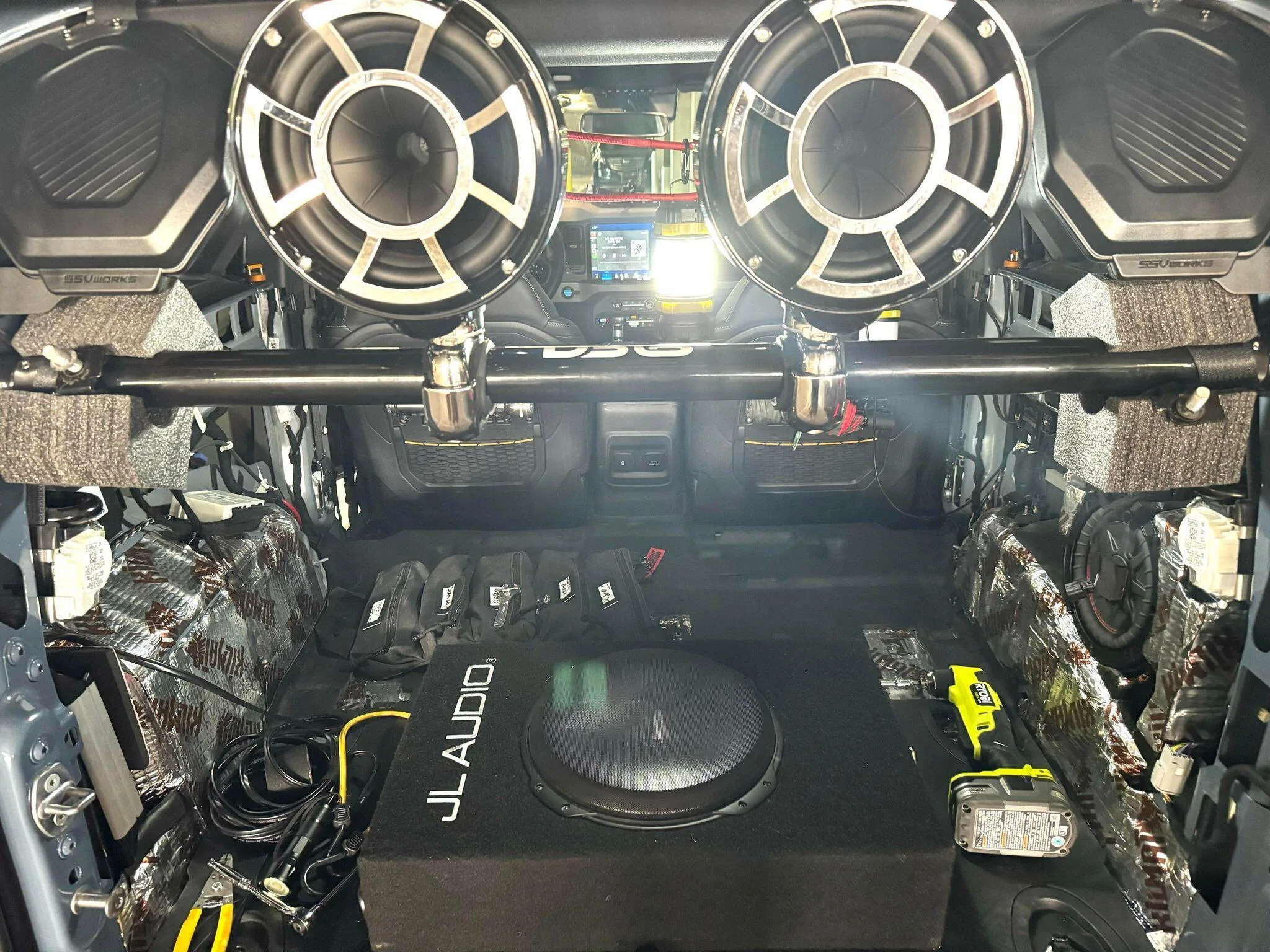

Proof that the 2D panels fit! And full disclosure, I had NEVER done this before and learned all as I went. The Bronco is very forgiving to give you access to run wires, pull out seats, pop off panels, etc - so it wasn't nearly as bad as I thought it was going to be.
(excuse the temp location of the sub - I'm going to mount it against the passenger side panel / molle to keep some storage space back there.

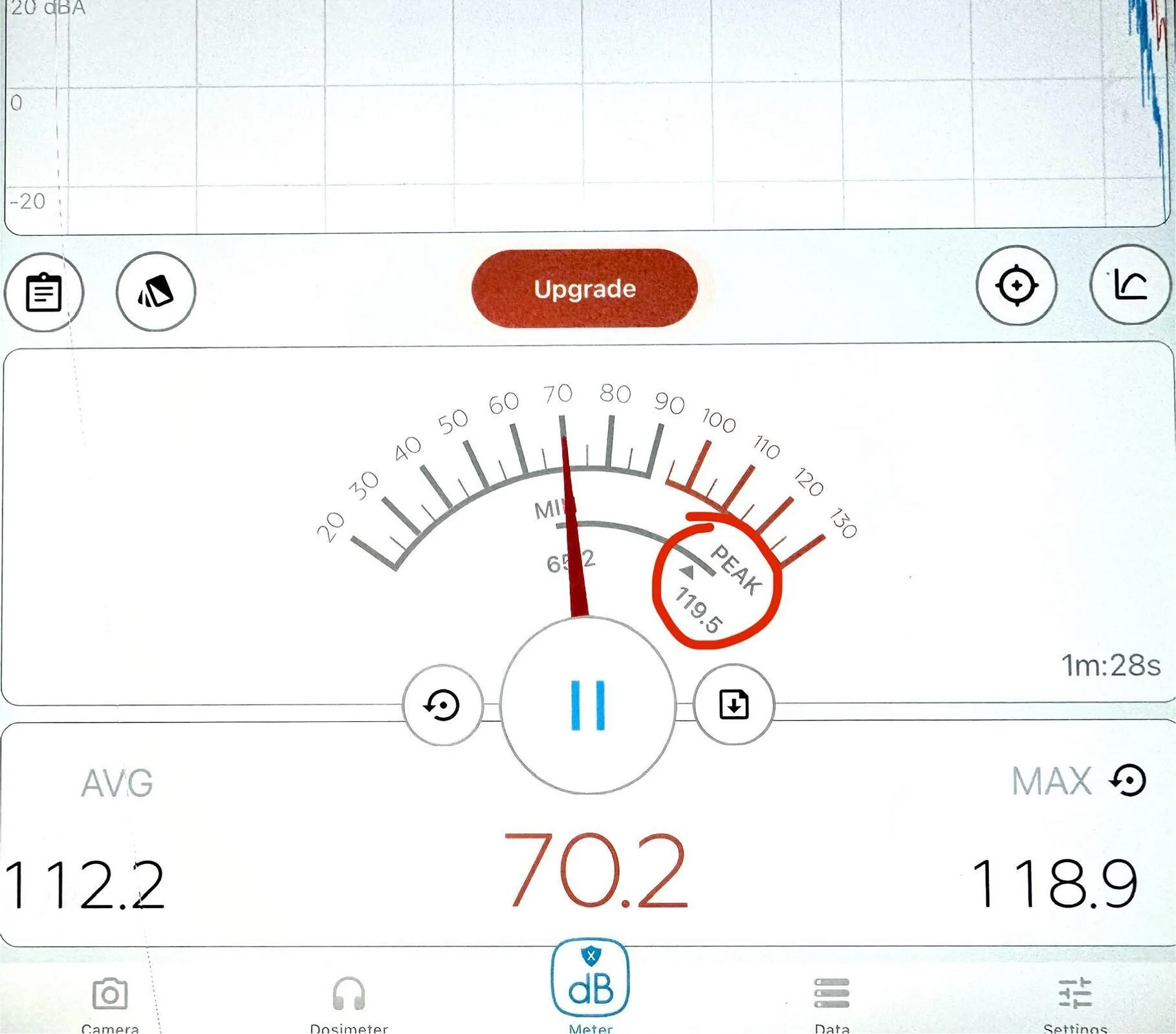

Oh, and it JAMS!
This was a few weeks ago - hitting nearly 120DB - after Fraser tuned it it's sitting pretty @ 125+ - so def no issues hearing your tunes with the top off!

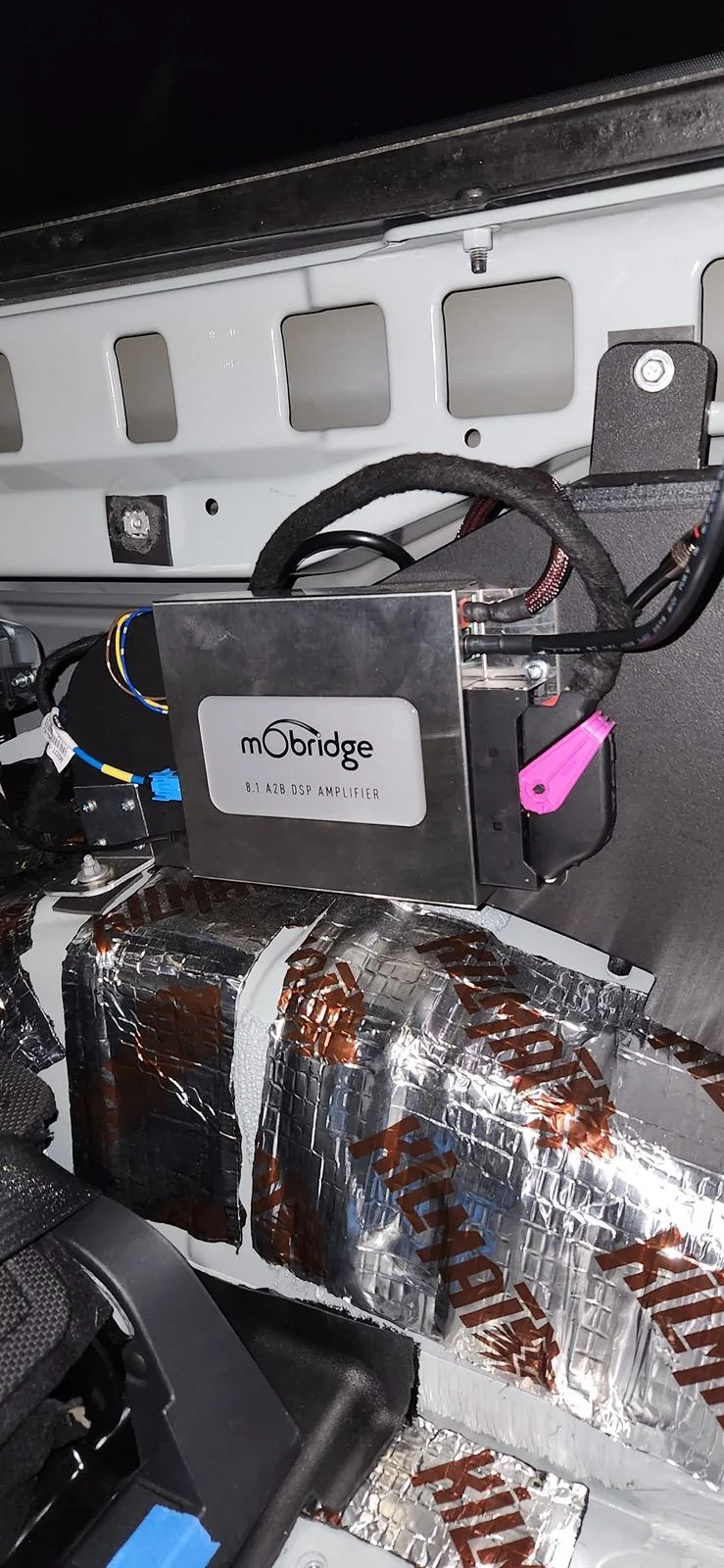

Just installed Fraser's @mObridge AMP/DSP and it is very much worth it and very easy to do !
I am very "green" when it comes to audio installs and I had it done fairly quickly.
The most time consuming part is tearing out the panels and trim pieces.
Just have to do some final tuning (Which Fraser had said he would do) and it will be complete.
If you are on the fence, take the leap !

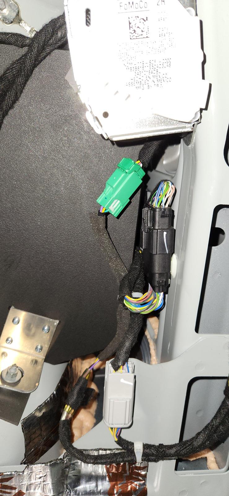

Unfortunately you will definitely have to run thicker power wires, we will have a how to video for this shortly. Not actually as big of a job as I thought it would be as there is a spare gromet in the firewall. Our kit will include everything you need shortly!
So if you want to run the factory speakers, our amp has channel limit settings you can setup so you don't overdrive them!
No forscan coding needed, no wires cut. Full plug and play just need to do some wire running.
