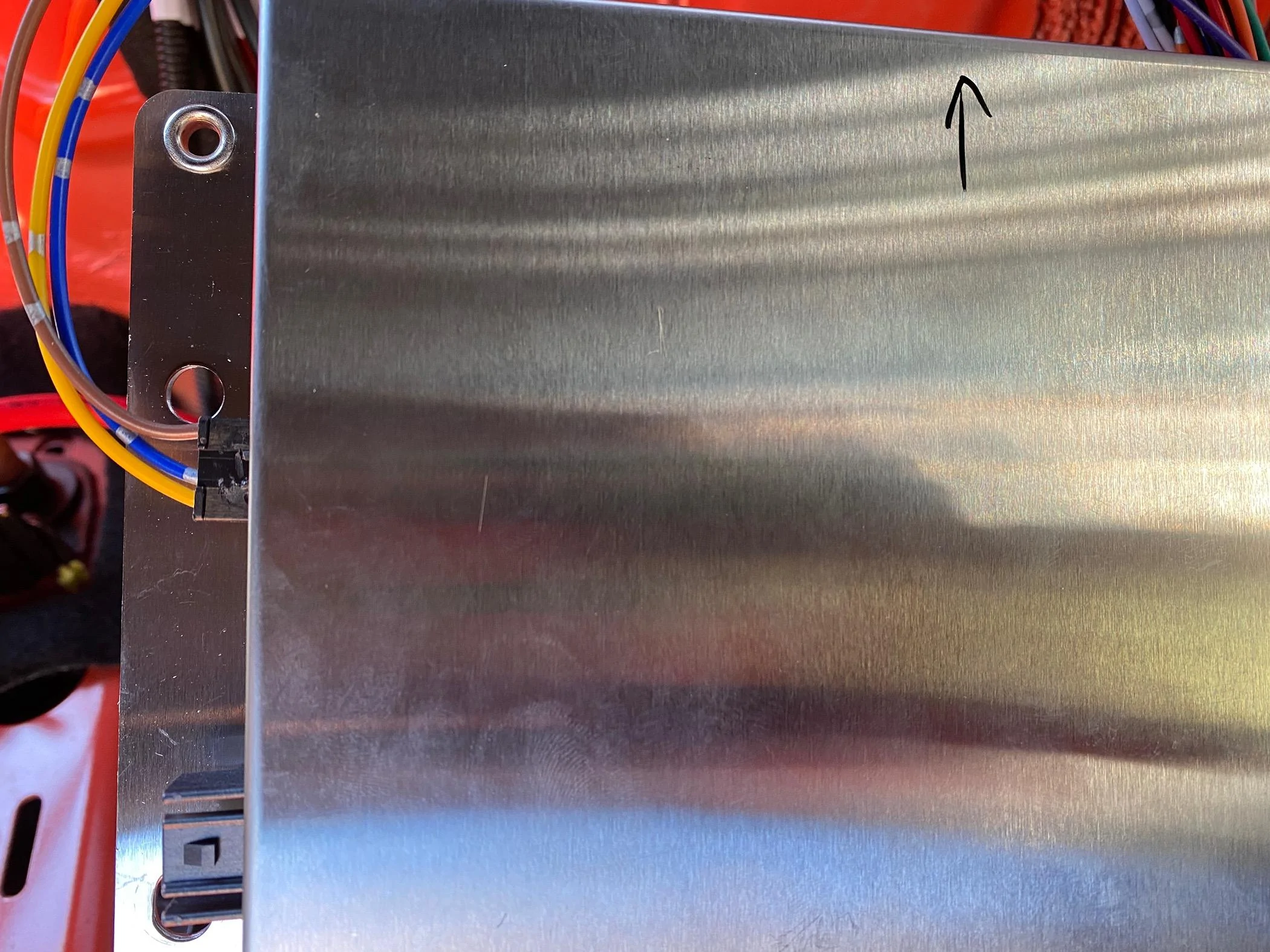

I just completed the Mobridge install and have run into an issue. When I power on my Bronco the head unit powers up and I can see playback, but there is no volume. I can turn the knob/press the steering wheel button and the volume graphic comes up, but it will not turn past zero (0).
I have checked all connections and they are secure. The Mobridge Amp is getting power (red lights on) and the dip switches are set correctly per the instructions. I have also made sure the amp is running the latest firmware (it is) and the DSP program can interface with the amp just fine. I have also done a Sync reset (power + seek right).
Any ideas?? I have emailed Fraser @mObridge (who is awesome btw), but since it is the weekend, I thought I would check here as well.
Thanks!!

Sounds like you may have missed the flat 4 pin connector that comes off the main harness and plugs into the back of our amp
I have that plugged in as well. And now my head unit is powering off/on randomly and my blind spot sensor is giving an error.
Thanks!!
I made the same mistake. Yellow wire should be closest to the data cable.Its keyed but will plug in the wrong way.

Swapping the blue and yellow wires worked like a champ.
Everything sounds great, except now I get no sound from driver dash speaker. Tried factory and new speaker and no sound. I tried with the Mobridge harness plugged in at the ACM, and the factory amp plugged in at the back, and then I got sound.
So close to being final!!!
