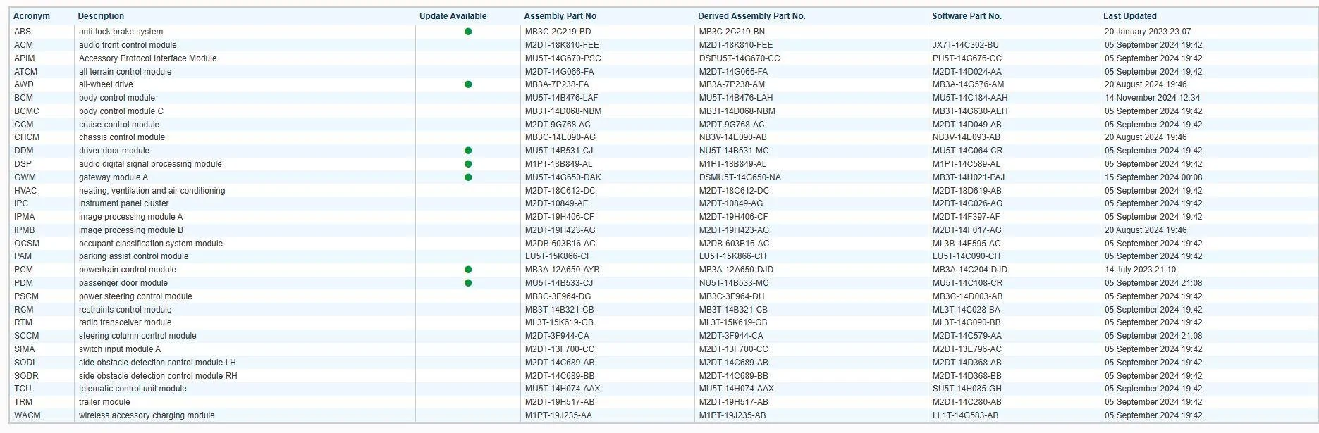

Looks like I have a few updates but nothing major. Have not checked since September 2024. Hopefully the door module updates fix the auto drop issues.
I found that additional updates would appear in FDRS after I successfully completed the ones initially listed.
This is true for the APIM, GWM, TCU and sometimes the IPC modules (the ones you update with a USB dirve). The updates for these modules have to be installed sequentially to prevent incompatibility issues between the software versions, so FDRS will show one of these at a time and once it is done, it will release the next one in the order in which it needs to be installed. FDRS is fairly dummy-proof.
