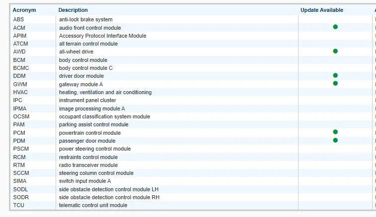

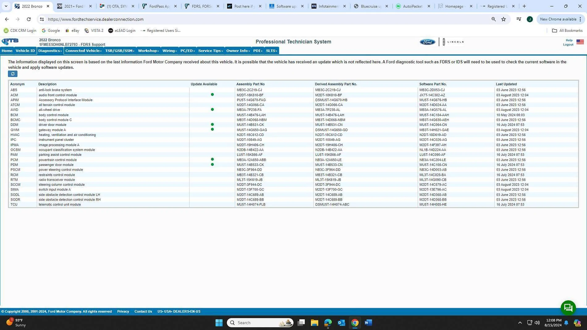

This is where my Bronco was On August 2024 when @rugedraw looked at my VIN:
Ford Bronco Sync update woes, OASIS / FDRS 1739296709321-ng
Apparently with no OTA history also. So maybe I'm one of those cases you have also seen.

Yeah it still looks the same as the picture you posted above.
It doesn't show any APIM update available. Sometimes other modules needs to be updated before it will show one available, but not sure if that's the case here or not.

@solracarevir This is exactly it. There are certain modules that must be updated in sequence. With FDRS, these are the modules that are done with a USB drive. The APIM, GWM TCU (and up to an extent, the IPC) have to be installed sequentially. Once the GWM update you show pending gets done, it will release the next update in the sequence (APIM or TCU) and once the next one is done, it will release another one and so on until you are up to date. As far behind as your truck is (Sync 22082 is from the 82nd day of 2022), you would need several APIM, GWM & TCU updates installed (possibly an IPC update or two, as well) before you truck is fully updated in terms of the sync modules.
In terms of all the other ancillary modules, you do not show many pending updates; just some door modules, the ACM, PCM and the AWD module. In terms of connectivity, your truck is talking and reporting itself to Ford's servers just fine. Just seems like the OTA gods don't like you.
