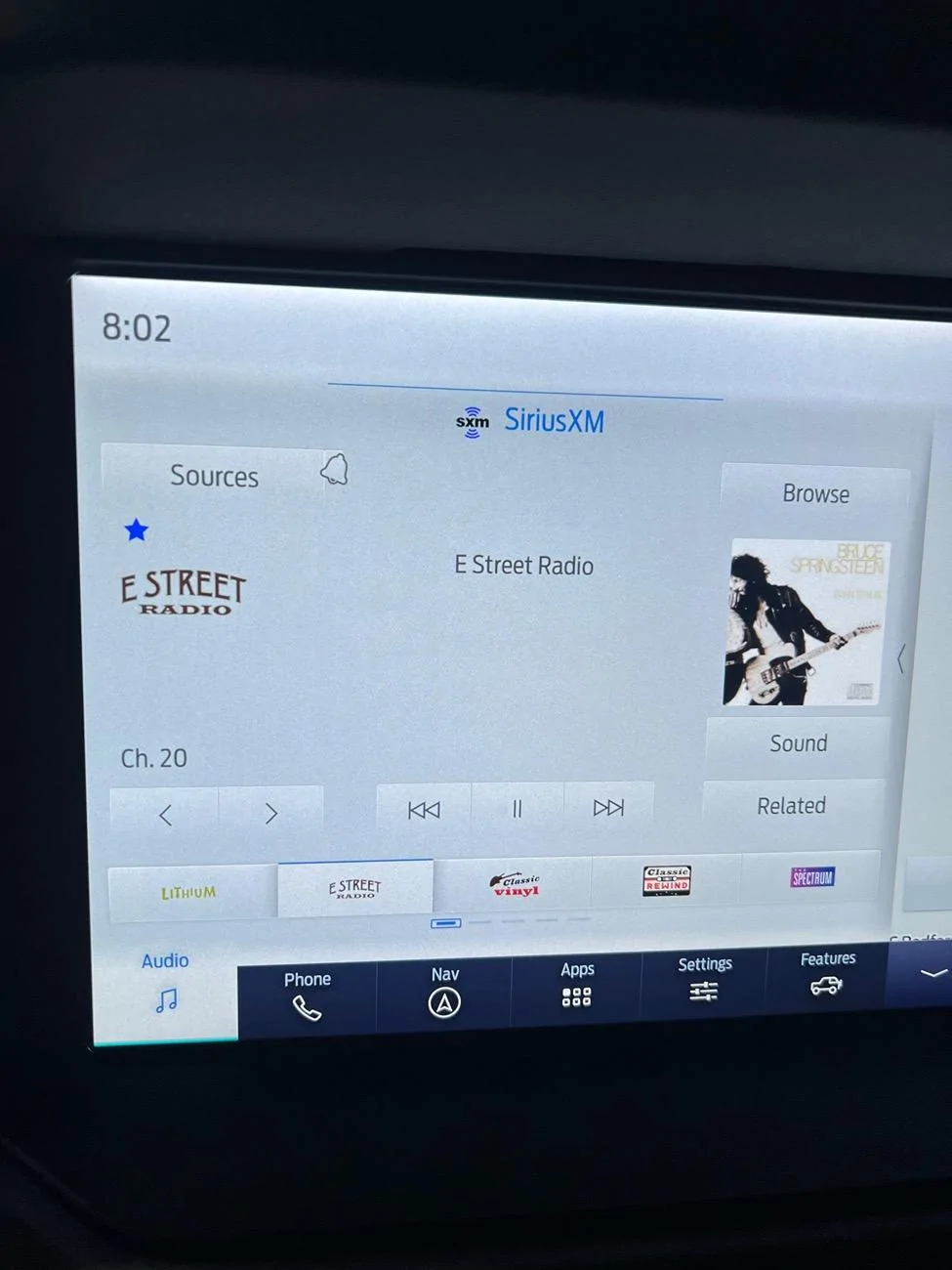

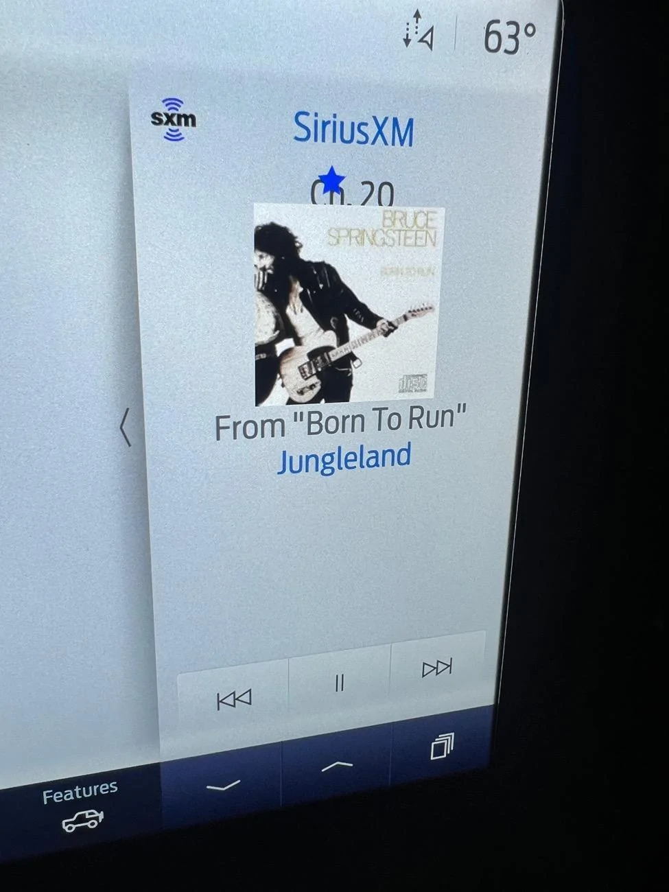

I'm on the new update as well and also have some issues with Sirius not displaying song and artist info. I noticed this issue before my Sync updated as well.

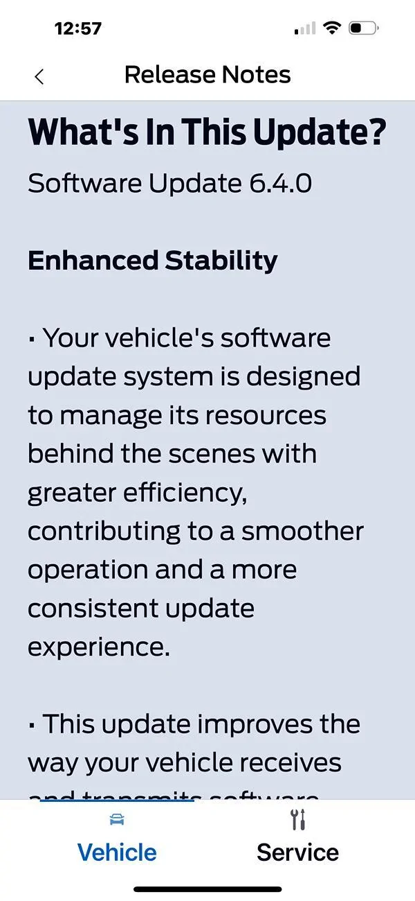

6.4.0 my rock horse build stated working again!
Ford Bronco Sync 6.3 update issue and display problems 20240830_115020

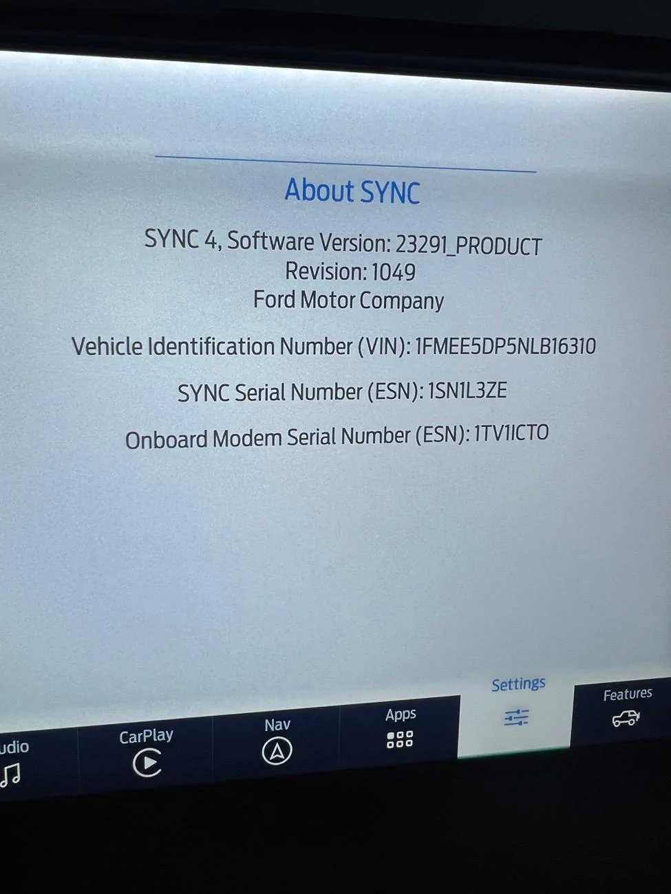

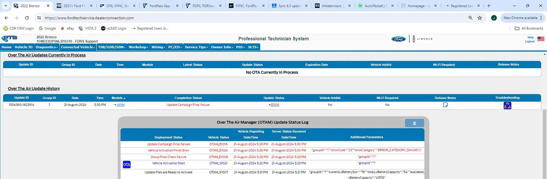

I am stuck on the “Priority Update-Audio”. It has not completely downloaded and the update now button is greyed out. It has been like this for a few weeks. Last successful 6.3.0 update was the step up to the mic update.
Any thoughts?

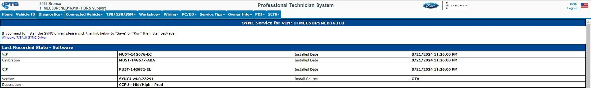

I'd need to VIN to check. PM is fine.

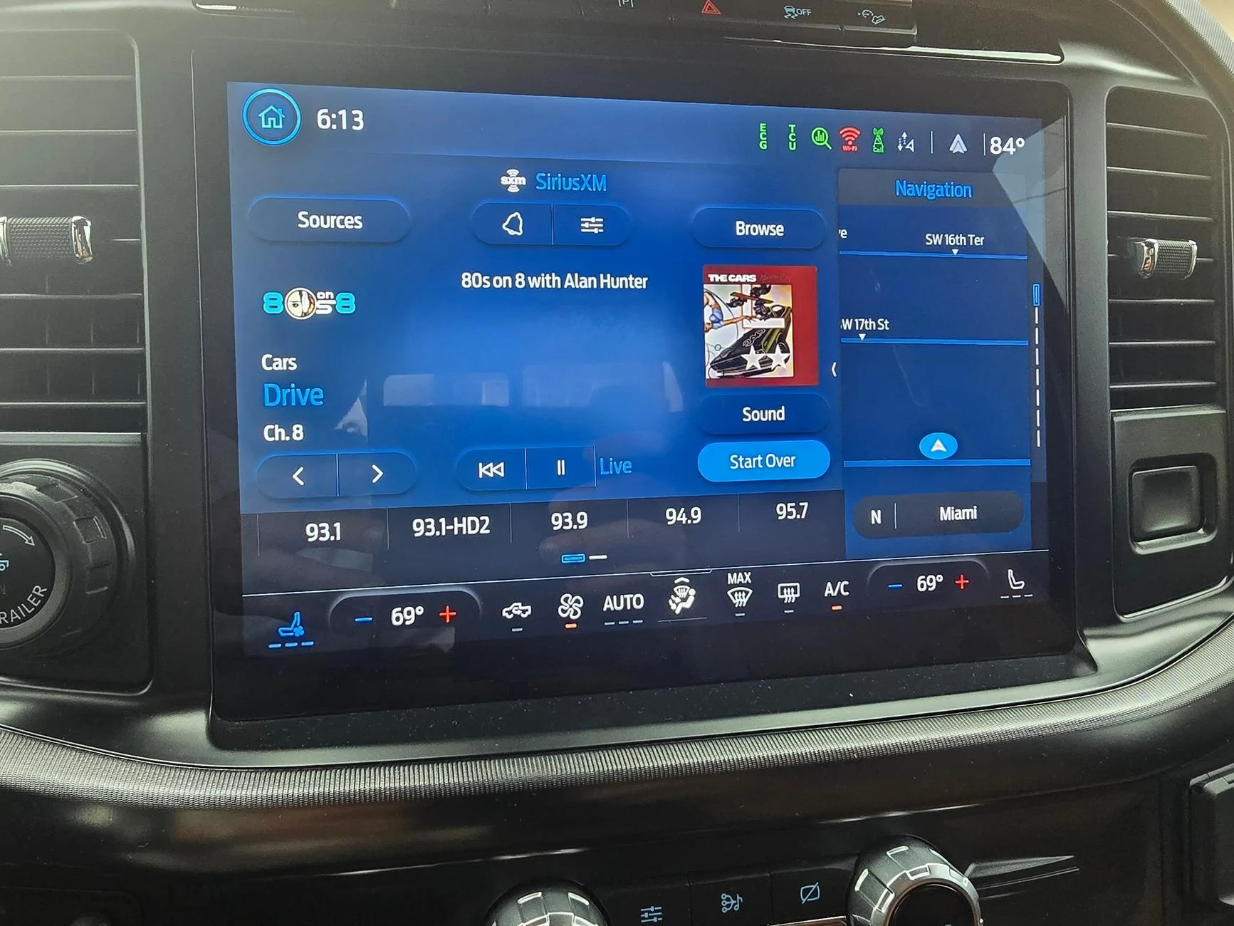

I'm having this issue as well. Update 6.3.0 and it saying not completed and update button grayed out.
Also having issues with XM not showing artist or title. Also the little bell icon is overlapped with the sources button.

Send me the VIN. Hopefully your truck reported back to the server after the update to see if this can be fixed like in the case of the OP.
