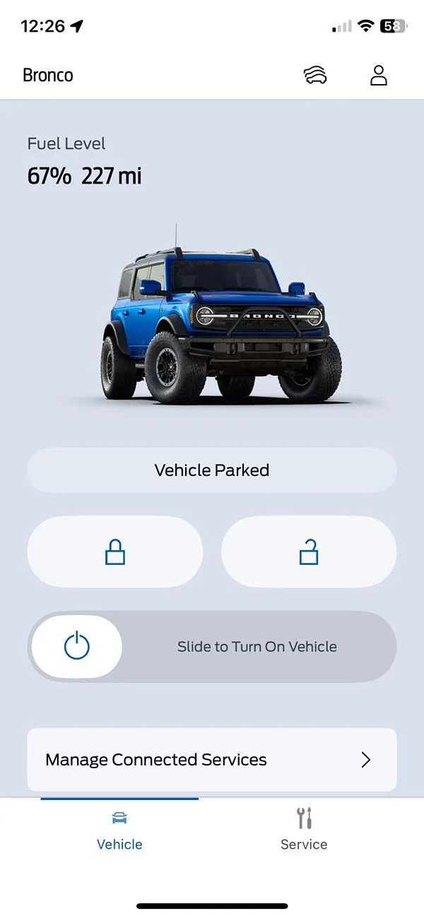

Did anyone lose their shortcuts on iOS? I had automations for locking the doors, unlocking the doors, seeing my fuel levels and starting the car.

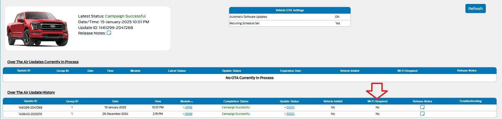

@rugedraw - I looked at the cost for PTS - you are correct - not worth the price. I wish the list of updates would be available in ford pass. Microsoft windows will show you the list of updates it wants to install - seems like Ford should do the same. I can't find any history of what has been installed on Ford Pass. My bronco is connected to house wifi - one of the mesh routers is right there in the garage. Haven't ever seen any notification of any kind of update.
Again: Wifi is terribly overrated on the forums when it comes to OTA's and the OTA process in Ford vehicles. 99% of OTA's show this in the PTS OTA dashboard when an update gets pushed to a vehicle. Only two OTA's have ever shown a "yes" there. One was F150 specific and the other one was TCU update 23-PU113-UNX-DC and this was to address a config problem that broke connectivity in the modems rendering vehicles unable to talk to the mothership completely, so wifi was the only way to get the update sent to them.
