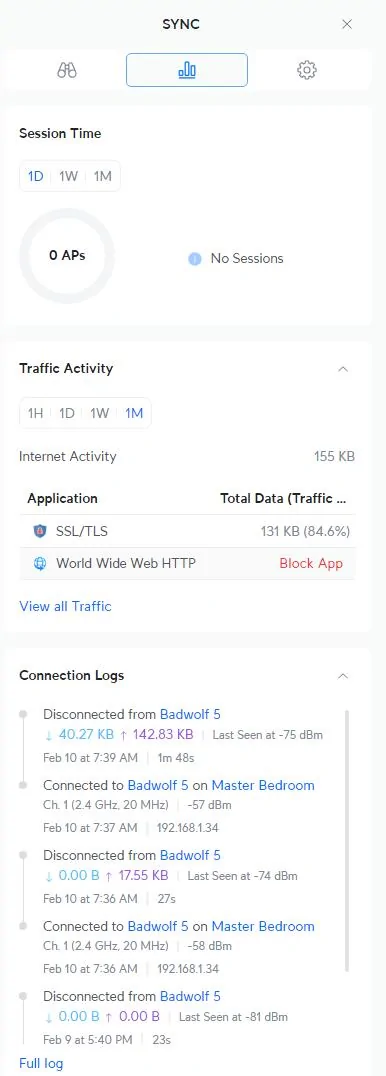

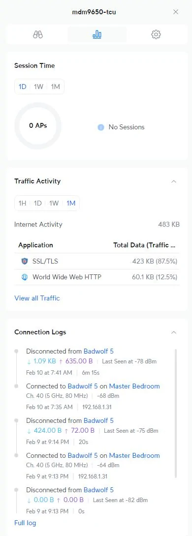

The Bronco is connected to my Wireless network at home. I see both Nic (from what I read some Ford Vehicles appear as 2 Network interfaces on routers) and both seems to be calling home. No updates tho...
That is probably not the issue but it's something to include/exclude from this end as part of the diagnostic process. As was mentioned by @rugedraw your dealer is going to have to do these updates in the hope it's going to unlock whatever is hanging the OTAs. The problem I see with a lot of dealers is that, "OTAs not updating" is not complaint they're going to spend much time trying to fix. A lot of that has to do with their lack of understanding how to claim these updates, assuming the vehicle is still under factory warranty. Now, if you're out of warranty and willing to pay time, I'm sure the dealer would be happy do all of those updates on your dime.

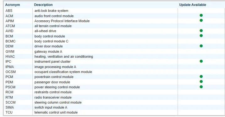

OTA history shows only an APIM and TCU update in the past 60 days. The update that would have changed the graphics on the screen would have been to the IPC or APIM (depending on which screen the rolling rocks was shown on) and any update to address shifting would have been for the PCM. I cannot tell you if your truck received an OTA update for the PCM at some point, but I can tell you it shows a PCM update pending for it on the server along with a few others. You have an IPC update pending too, so I assume the rolling rocks is/was on the touchscreen.

Modules with pending updates are below. Truck is on Sync 23159 which is two version behind the latest one. No OTA's have been attempted in recent history.
