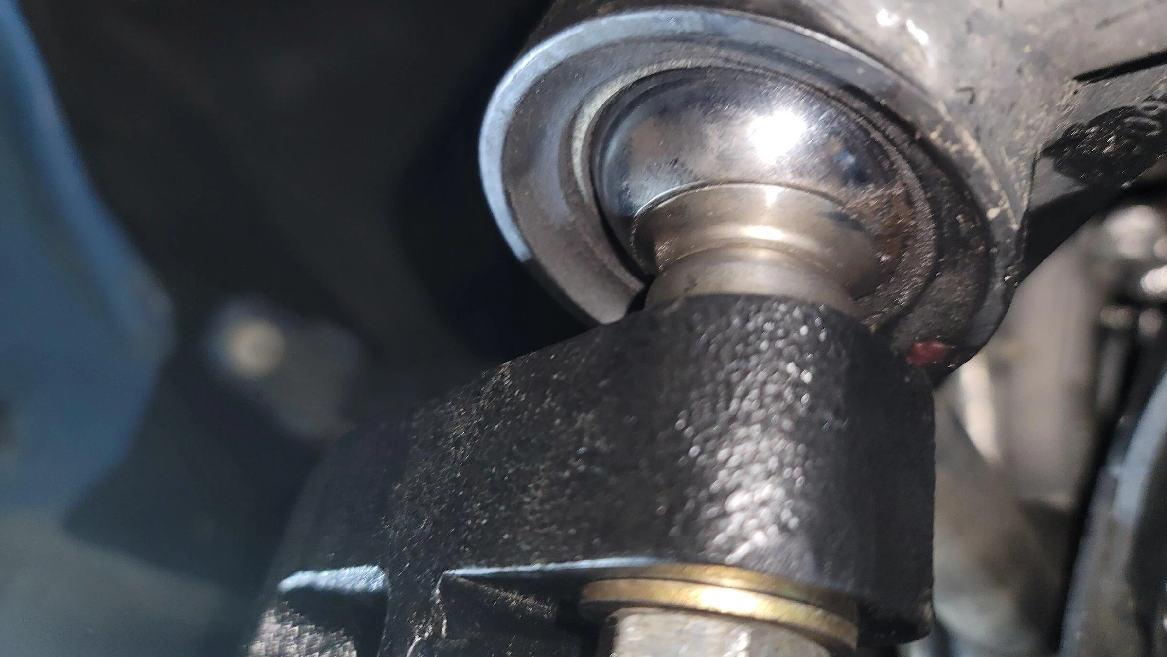

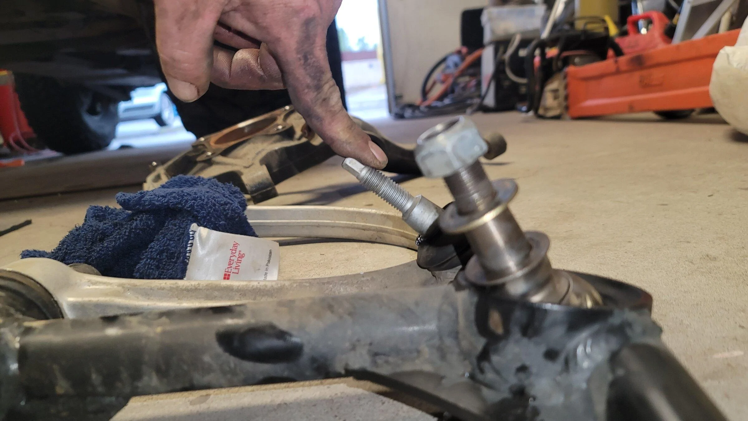

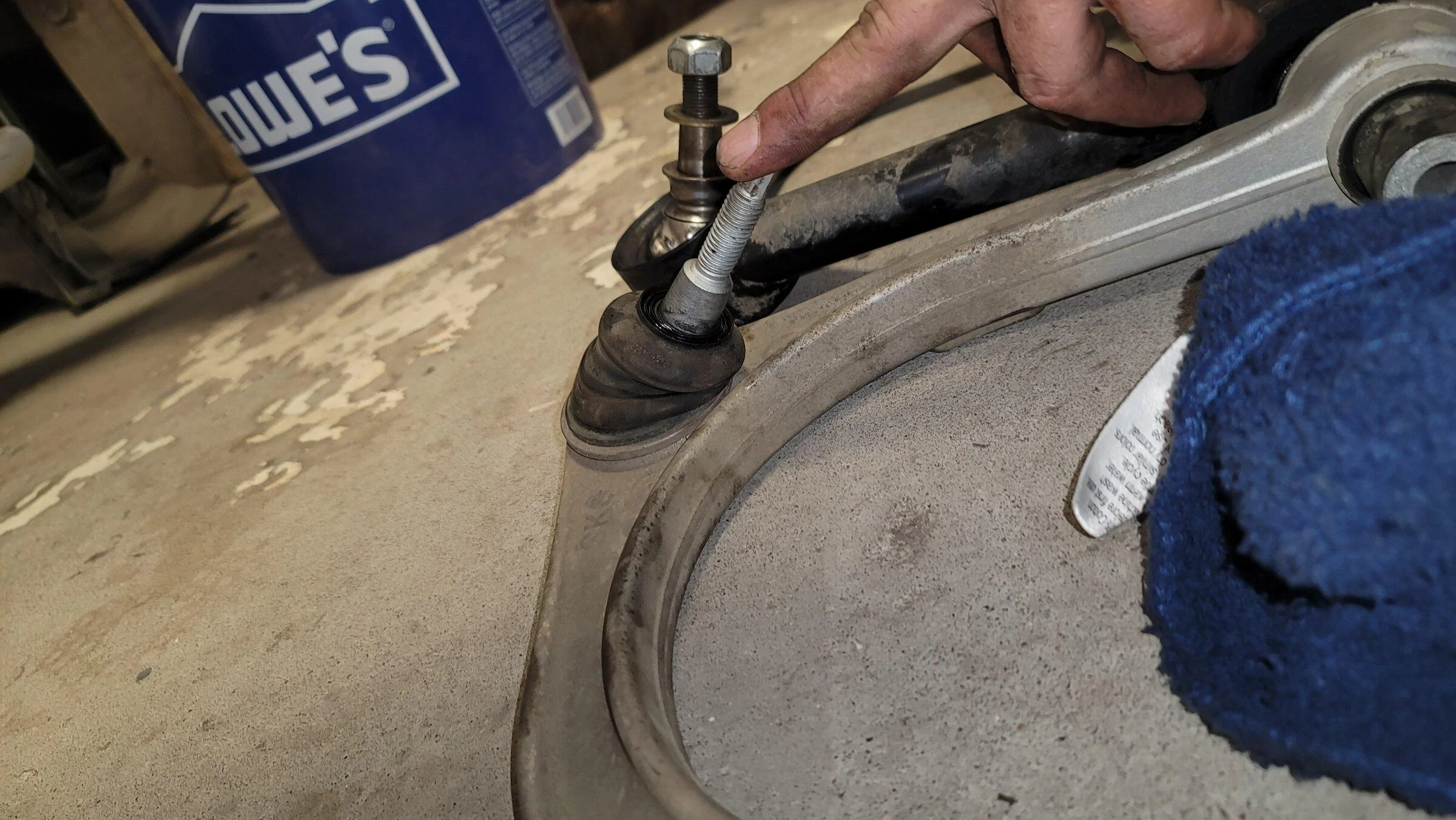

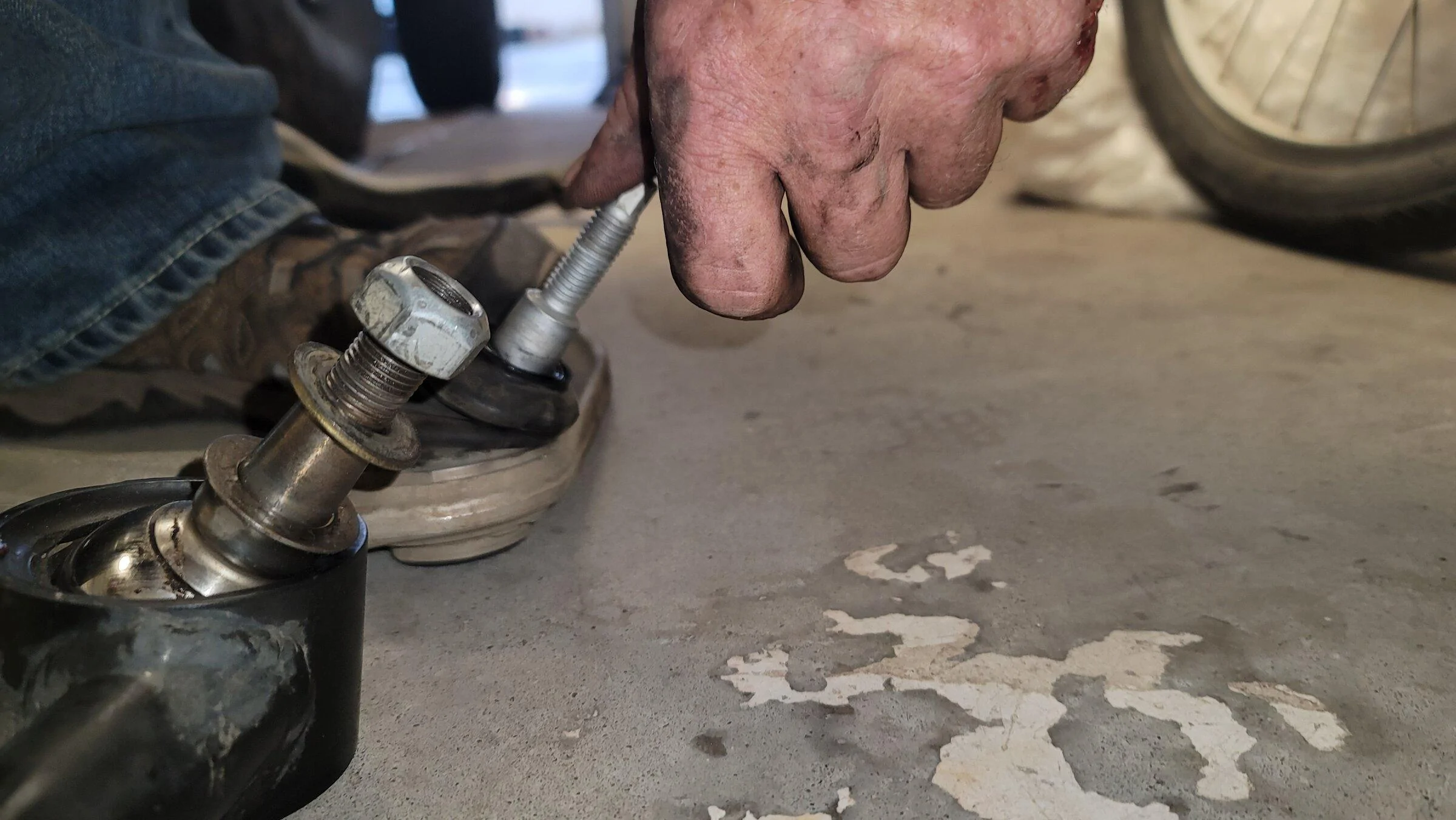

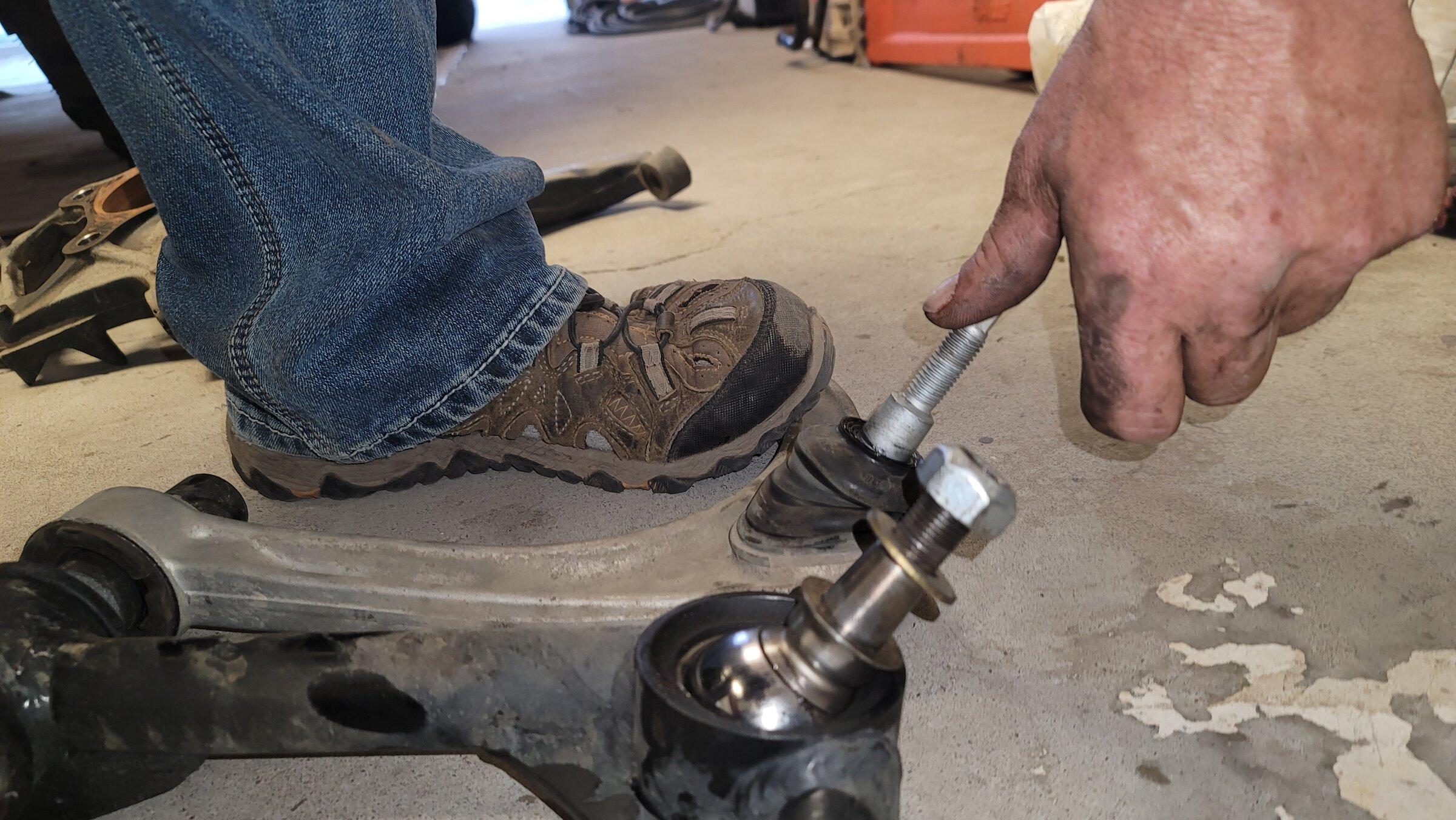

I took off the Fabtech UCAs because the uniball has LESS angle available than the OEM ball joint....so for all the fools selling this crap try using shit that's better than OEM not worse. Probably the only ones worth a shit are the ICONS that use factory ball joint.
The OEM UCA joint has nearly 80 degrees of movement!
And for those that think new UCAs with these uni balls or heims with misalignment caps, are bad-ass super shit...here's a clue... THERE JUNK!
Here's some pics ...
Zone Off Road's UCA also uses the OEM ball joint. And won't break the bank.
Ford Bronco Exploring off-the-shelf tie rod upgrades 1651292388196
