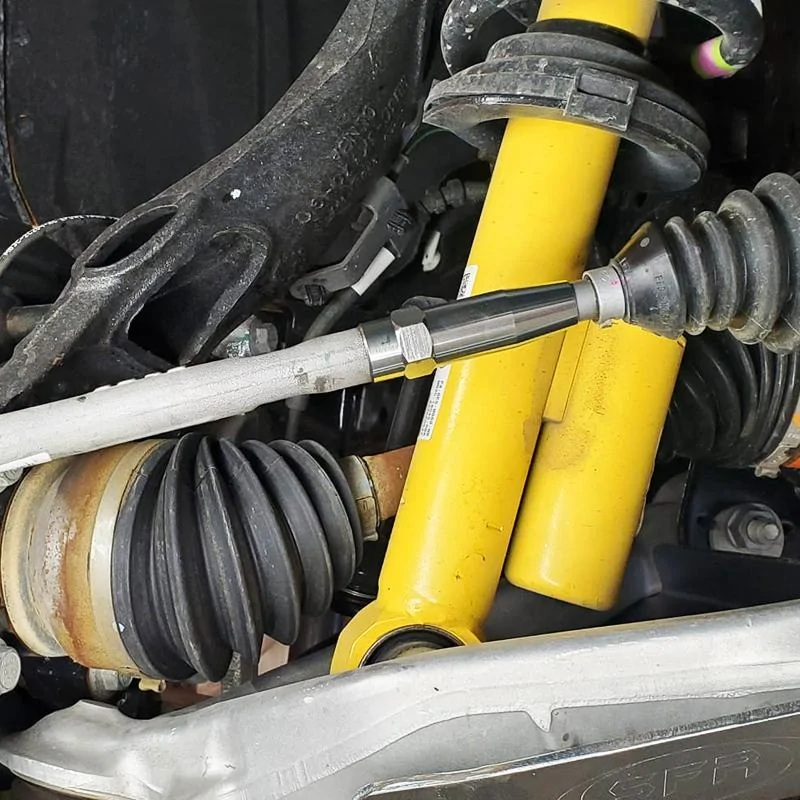

If I install a tie rod sleeve or brace on my bronco, will the problem with the tie rods move up into the steering rack?
I’ve broken 2 tie rods and want to not worry about it.
-Brock
in theory yes the stress point will change

We released our Tie Rod sleeves a while back with the fragility of the rack in mind. There's a balance between the tie rods being so weak you're constantly breaking them, and possibly then breaking other things, and them being so strong the weak link moves to the much more expensive rack. I feel that the sleeves we designed walk that line nicely. They support the weakest part of the inner tie rod (the threads), and where some other stop short we continue to the fattest part past the hex, but still leave a "fuse" inboard of that. Cheap insurance without going overkill was the goal.

I use Level Up sleeves which are very similar. No broken tie rods yet, but with my driving style I'm not sure I would have without them either. I do think these are much safer for your rack than Broncbuster braces.
