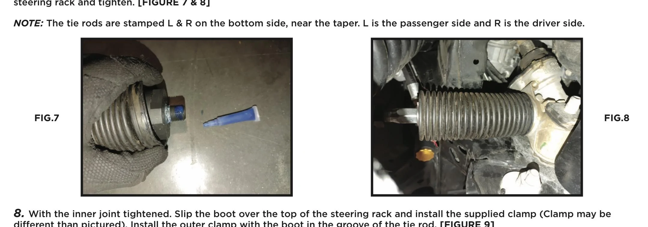

They are plug and play with the factory rack. But be aware that they are stamped incorrectly from Icon (at least the set that I had). So that the tie rod marked with an L is actually passenger and the tie rod with an R is driver. You’ll need an alignment after installing.
Mine were correct (L is passenger and R is driver side). See attached pic of instructions showing orientation/location each goes. Just did mine. Worked fine and needed an alignment afterward (to answer someone else’s questions about that).

The instructions were updated due to the mismarked tie rods. Most people consider the right side to be passenger and left side to be driver, unless you’re driving on the Queen’s roads.

Yep. I’m just mechanically inclined to begin with and figured out the orientation without the instructions. Wrenching on hot rods and such teaches ya to use the force sometimes (that inner knowledge, wrist torque wrench for quite a bit of things, etc, etc) :p(y)

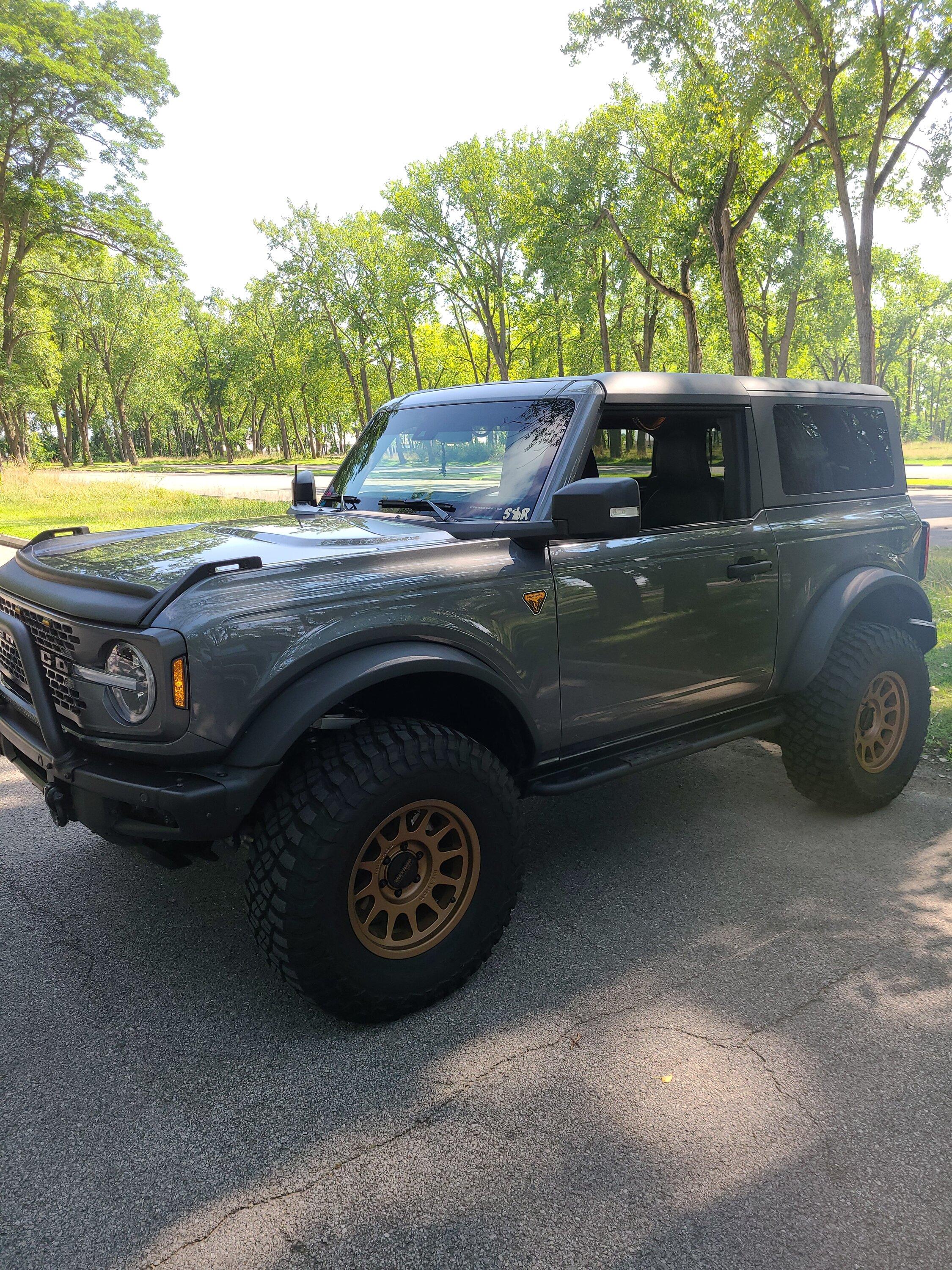

I went with the 74Weld 2.0 rack and the icon tierods..had my dealer do the install..then had the Icon stage7 billet kit added..Now ima ready for 39's on my 2door BadSquatch🤘
