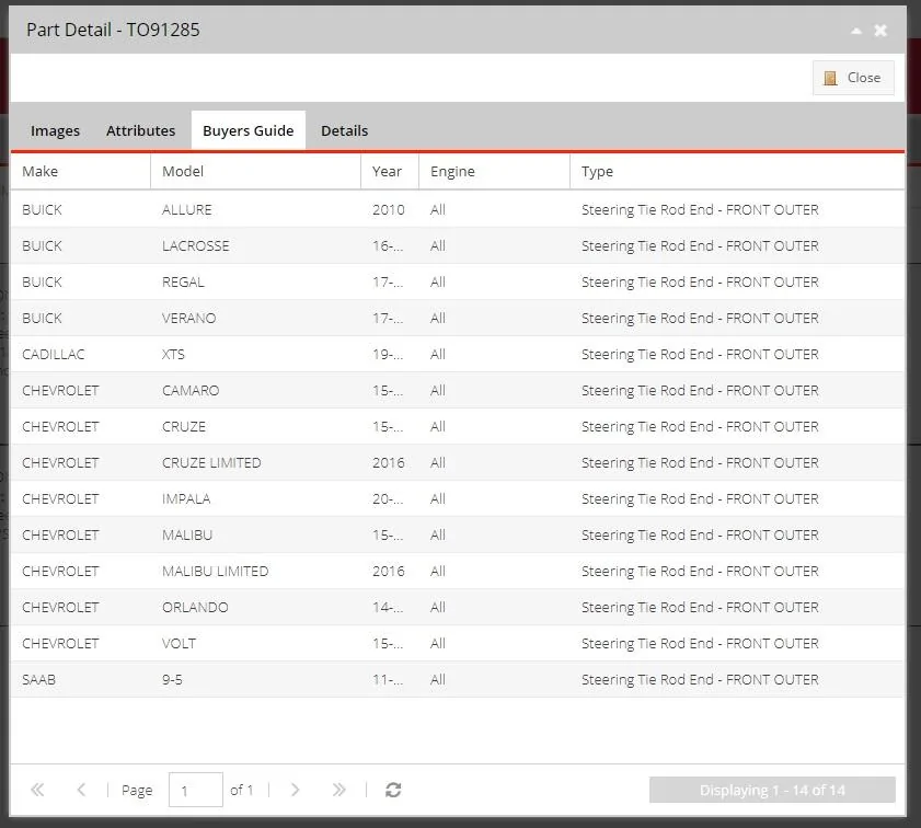

And then again maybe I'm wrong. Just found a 2010 Buick Lacrosse is 12/16. It's only 136mm long though, giving up 6.5mm to the 09-14 F150 outer. Still 26mm longer than 04-08 F150. I think that would be ok!

Here's everything the Buick TRE fits. Should be widely available!
Edit - whoops, posted Lucerne, it should be Lacrosse.
Ford Bronco Exploring off-the-shelf tie rod upgrades TO91285
