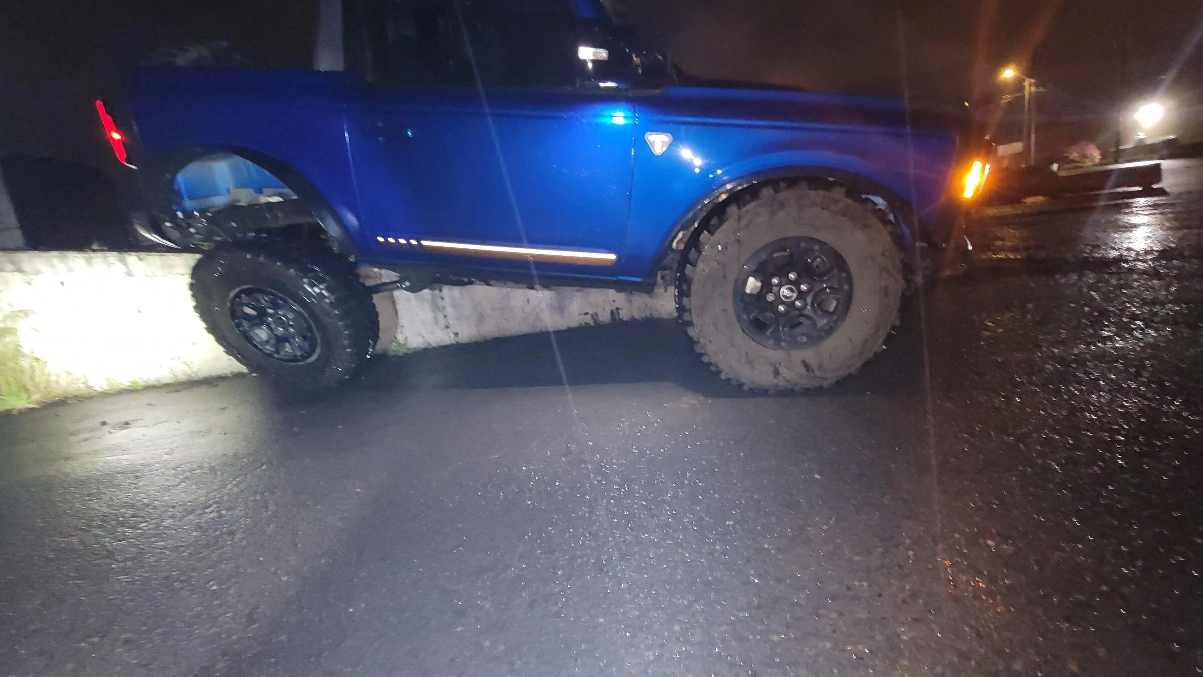

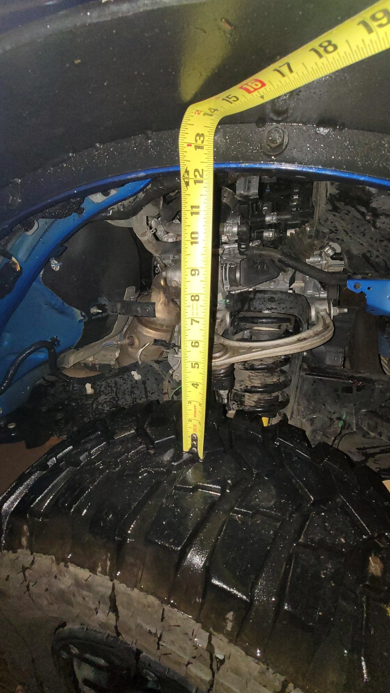

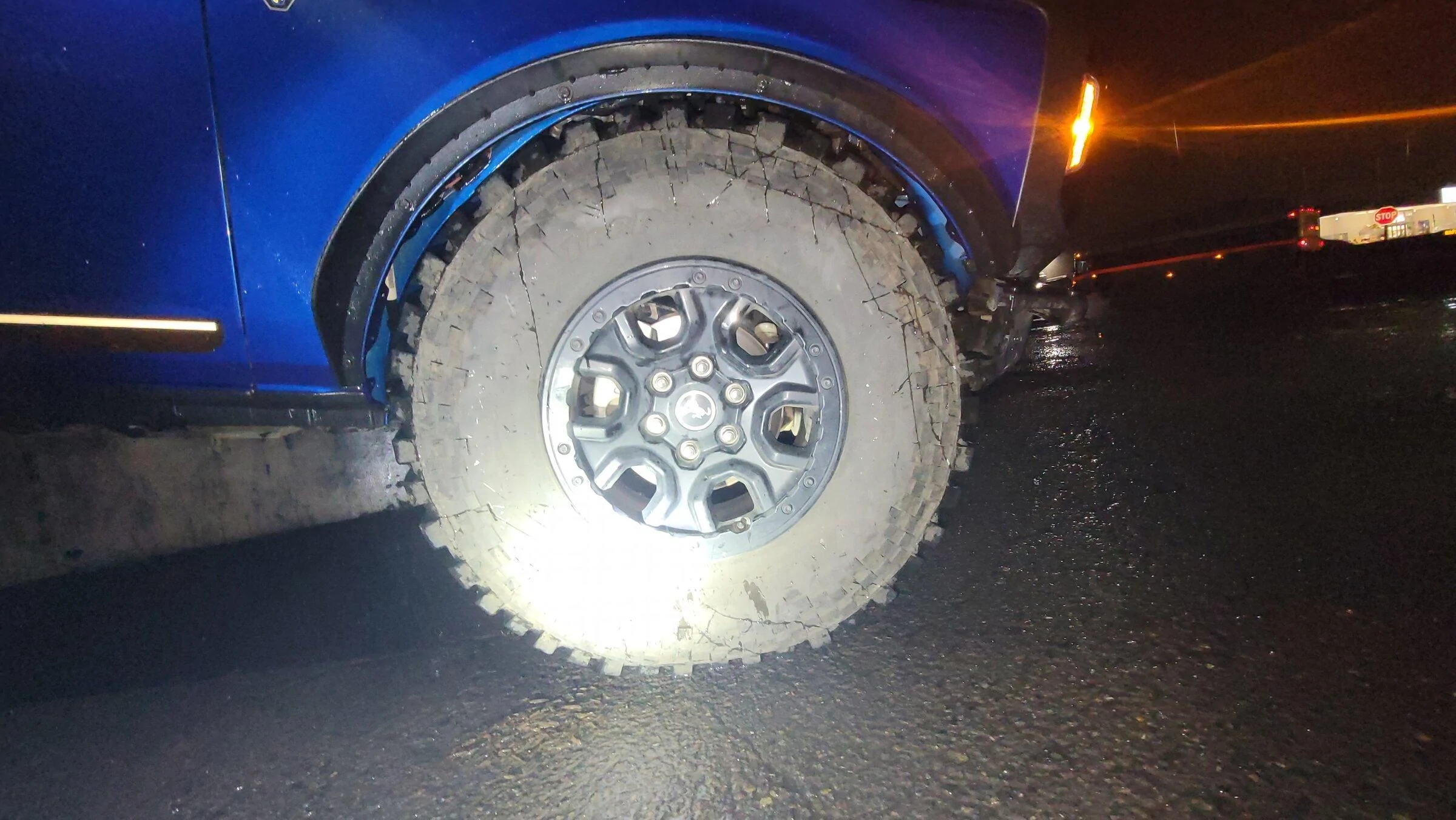

Well took er for a late night spin...Absolutely Fantastic!!
I gained nearly 1.25" compression travel in the front!!! Unbelievable that I have a FULL 12.5" front wheel travel now!!! The recipe is OEM UCAs folks. And shaved bumps with RC knuckle uprights.... obviously my Fabtec UCAs were bottoming out in the uniball angle available before this.
My real desire here was to straighten out the tie rods angle and this setup fixed that and also gets nearly FULL use of the 80 degrees available from the upper ball joint.... here's a few pics....I'm so happy I'll probably start another thread about this.

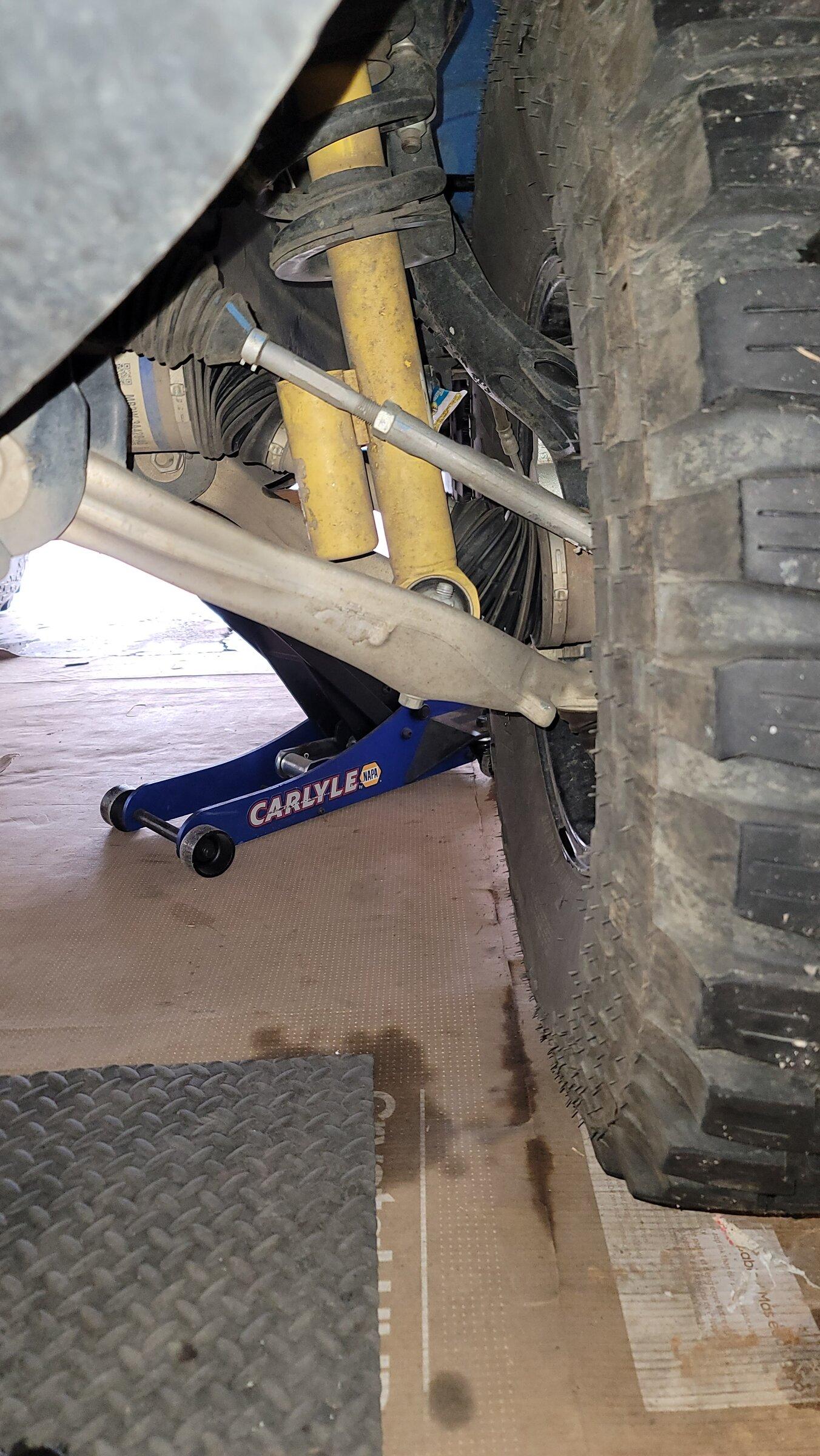

Here is a before and after pictures of the tie rod angle at full droop...what a difference! Imagine for yourself where the force is directed when the tire impacts a rock or stump on the outside edge....the force is transfered across the tie rod into the rack ...and when the tie rod is a t a 45 degree angle then HALF of the force is pushing UP on the inside of the rack, not across. This is where the rack fails...simply when the force is in the wrong direction.

The CV angle looks a lot less severe in the second pic?
