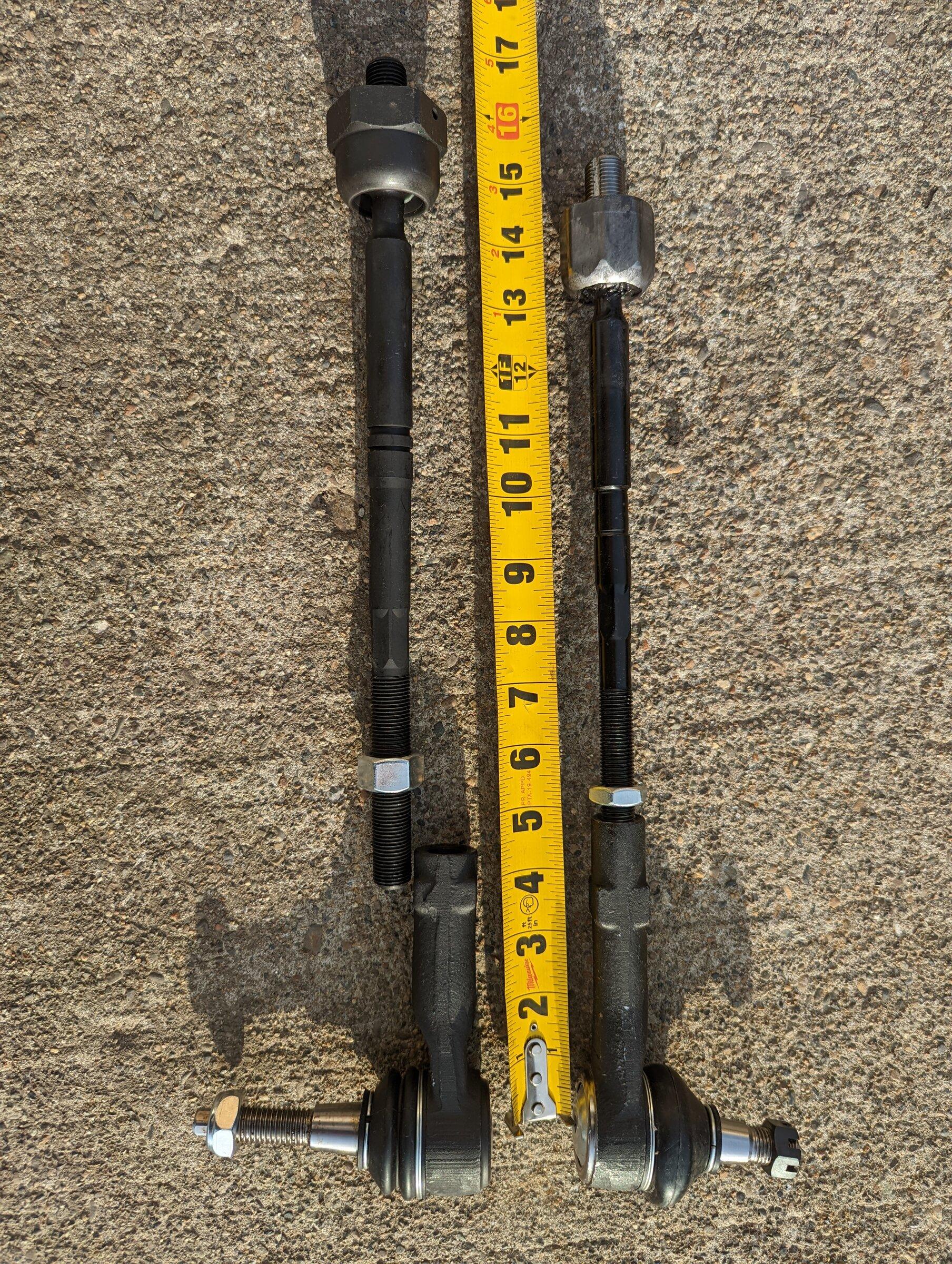

So we're looking for a ~16-5/8 length from center of TRE to end of threads that go into the rack. You can see the 04-08 F150 can do it, but has minimal thread engagement. I'm hoping the listed specs on the 09-14 TRE are correct and I gain the ~30mm published.
The other one is the old Ranger (and same diameter as Bronco). The extra 2mm of the F150 looks massive next to it.
Also note the Ranger TRE has a little upward kick, it would be beneficial for down travel if it was long enough.
I'm really stoked your doing this! I'm surprised the taper is the same at the mount and the threads are the same at the rack ends too? Fantastic !!!
The taper is still a question mark. 99% chance it's 7 degrees. Question is what the major diameter is and if it will sit in the knuckle correctly. I have a reamer if it needs to sit deeper but I'm hoping it doesn't come to that.

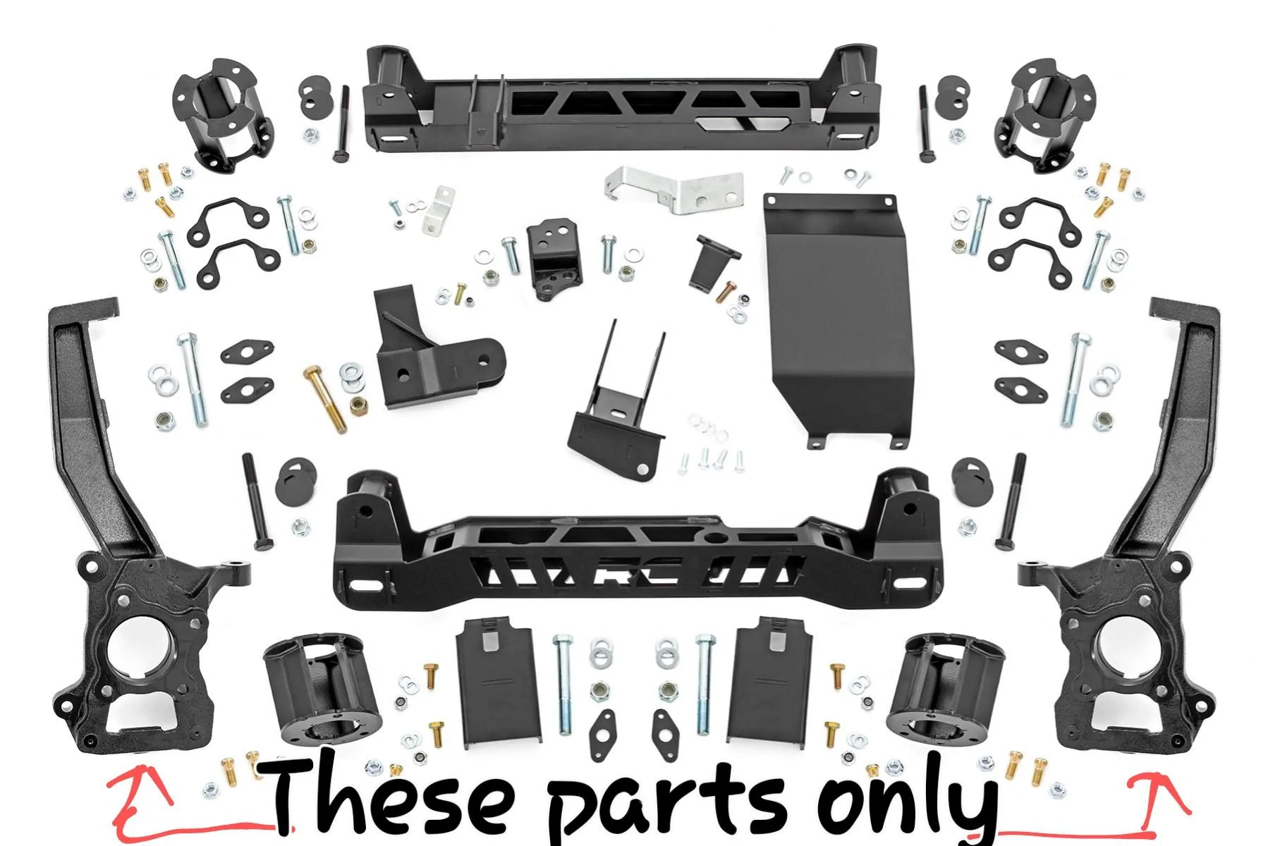

So I went ahead and ordered the RC uprights for the simple reason they have the tie rod mounts in a much higher position. Which will result in the tie rods being almost level at my ride height. This WILL decrease the angle on the rack which will make it less likely
to have issues... The best part about this experiment is that they are ONLY $199 for the pair!..(half the price of BB band-aid) and when combined with Tricky Dicks HD Tie Rod Solution, it should help dramatically.
The only issue I see is how the upper UCA will sit with a 4-5" higher attachment point and if the geometry will be affected severe or minimal amounts.

I'm curious how this works out. I'd be worried about possible bump steer too.
