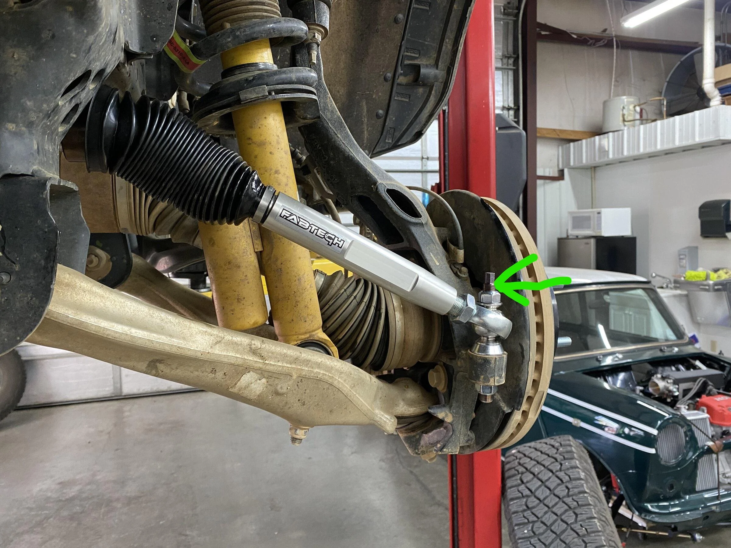

Ok while I'm no fan of him or poor quality heims, it is clear from my observations that the angle achieved is the same or very very close to the same with the OEM outer tie rod joint when compared to a very quality FK heim with misalignment spacers installed. Not advocating for them, just saying that the reason he advised against them is to sell his silly band-aid clamps that only fit OEM. Here's pics ....
So not much is gained with these, they just wear out faster and aren't really any stronger unless the mount was redesigned for double shear at both ends.
His silly band-aid clamps that only fit OEM appear to work. He guarantees them. I installed them because I have nothing to lose, and everything to gain. There doesn't seem to be a consensus on any other solution. Most of us don't know enough about tie rods to feel safe putting on some cobbled together solution. There's no risk in strengthening a factory tie rod..... So as much as I'm envious of your and others understanding of the engineering of tie rods, when you do find the strong safe solution, and it's widely excepted, I'll put them on. Until then I'm using the band aid.
