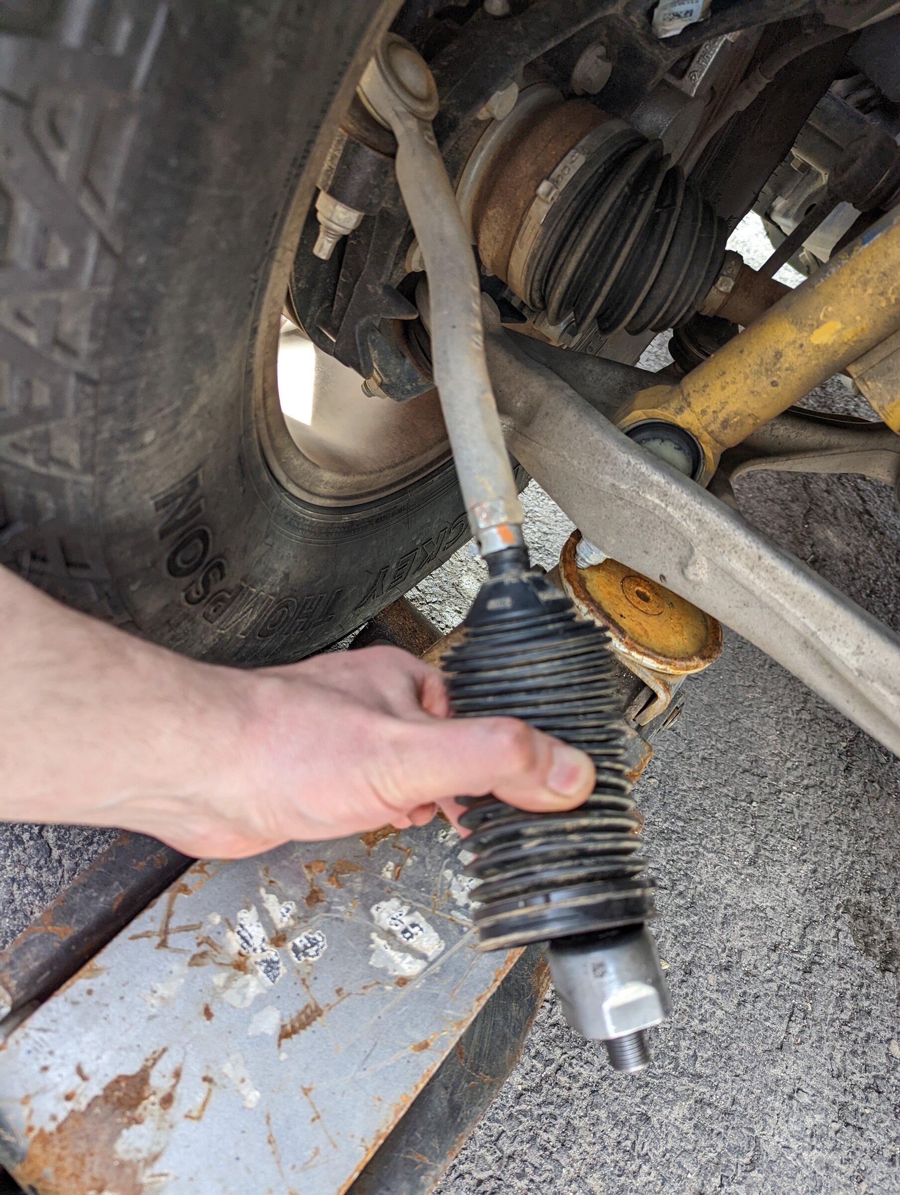

Just got done ripping apart my front end. It is indeed M16x1.5. I didn't want to lose my alignment so I didn't break the inner and outer apart, but the overall length is 16-5/8 from end of rack threads to center of outer TRE.

After doing some spec hunting I have sets of tie rods coming from 3 different vehicles to compare. 2 make sort of sense: 2005 F150 and same era Ranger. The 3rd? 2010 ish VW Toureg.
I think a factor in these bending is the offset outer tie rod. It loads the threads at an angle. I don't have my stock +55 offset wheels on but it looks like if I did, the TRE offset would be to clear them. If the F150 tie rod pans out, the 09-14 version has an offset for those that would need it.
