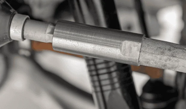

I ended up ordering these:
https://www.levelupsuspension.com/products/level-up-suspension-tie-rod-sleeves-21-bronco
I was worried that the JKS threads were not coated (or any powdercoat/paint that was one them would come off when they were installed) and would rust and seize over time. The rough country ones looked good too, but they covered most of the adjuster (especially when you loosen it) which seems like it would make alignments difficult.
Google seizing and stainless as your statement is a contradiction.
sea382
May 22, 2022
Riverside, CA
I had stainless tie rod sleeves on my Colorado for years with anti seize and never had any issues. This kit comes with antiseize as well. I really think the JKS raw threads will be even worse over time...
The difference here between a stainless steel fastener and a stainless steel tie rod sleeve to me is how much its being tightened. A faster is usually torqued to a specified amount, which can cause galling of the threads. Here the sleeve is being used as a nut. If you ask any good alignment tech they will tell you not to overtighten the tie rod nut. There is no need, especially since even if the nut come loose the tie rod end cannot rotate. The inner tie rod would have to rotate in it's ball joint to have the tie rod actually come loose and fail.
