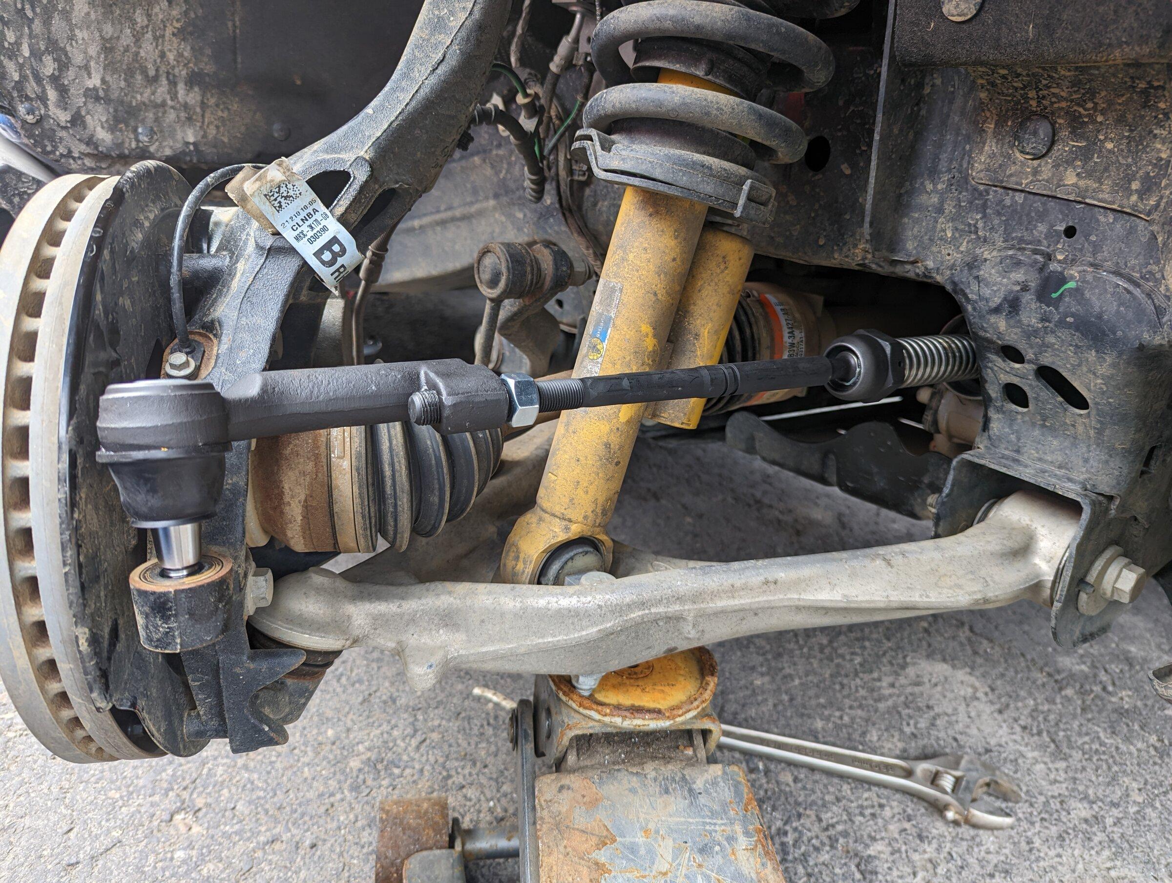

They're both super easy. I think it was barely 5 minutes to get both off.

Anyone have a good video how to change out an inner with tools you would have out on the trail? I’ve already purchased a couple of Ranger tie rods from Rock Auto, so I just want to make sure I have everything else I need.

We should have filmed it. @Copperhorse73 can attest to how simple it was. You can do the whole job well enough to get home with 2 crescent wrenches and a flat head screwdriver as a minimum. I also recommend a hammer, needlenose, and side cutters. A set of sockets and impact is icing on the cake if available.

100% simple. The only part I wasn’t sure on (still not as I wasnt watching closely) is how to preserve the boot clamp. I’ll probably include a 2.5” clamp in my field kit as well
