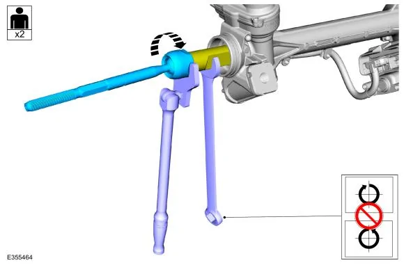

Wide jaw wrench of some sort.
e.g.
You should actually get two. Most people are removing these incorrectly, and not stabilizing the rack while they remove them.

Never really thought about it until I saw that picture, but a crowfoot is a good idea. Doesn't take up much room in the tool bag and I already carry a ratchet. Much lighter than a giant combination and/or adjustable wrench.
Anyone know what wrench sizes are needed?

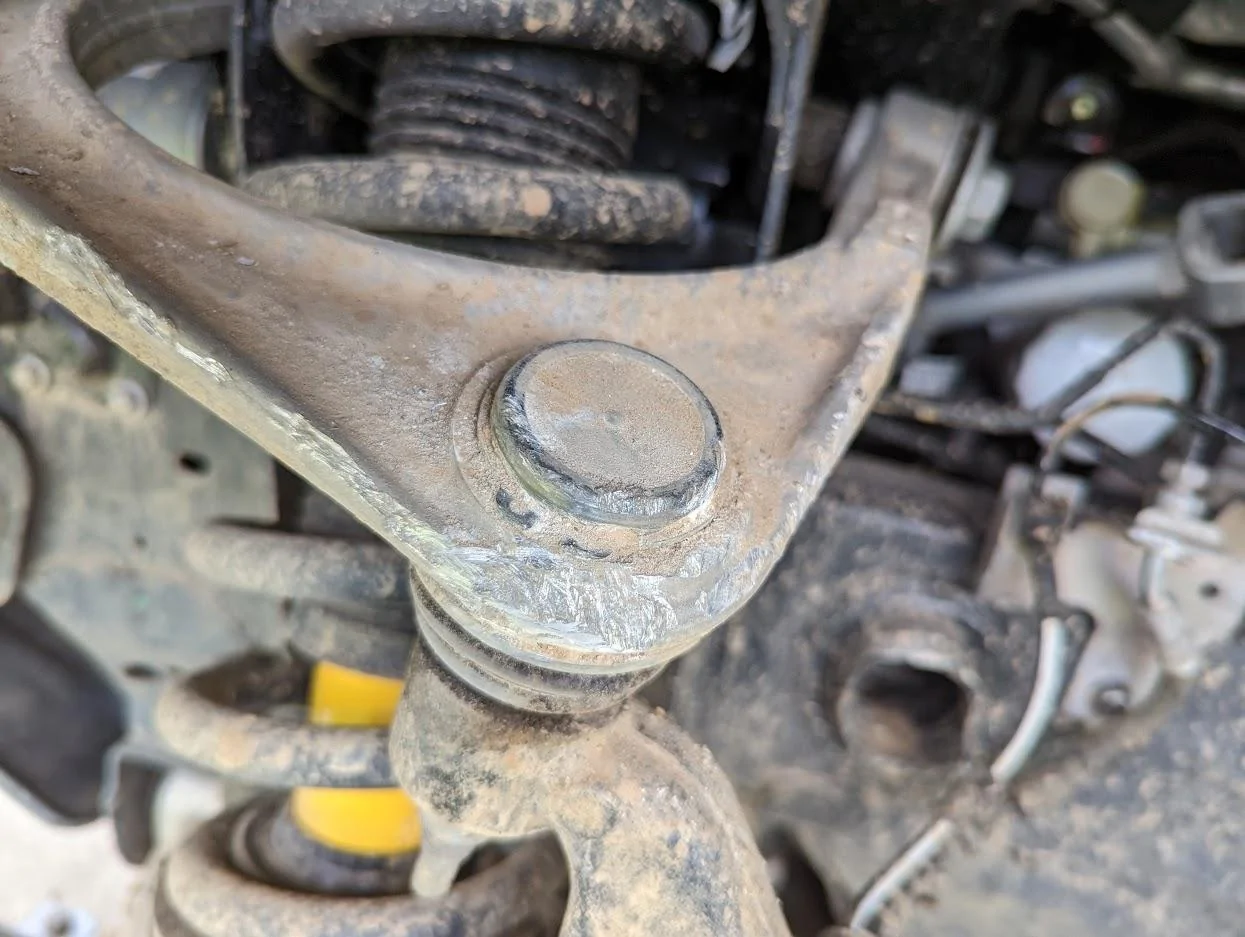

One thing different in my use case is I have no intentions of ever doing a lift. A level at most. I'm not liking the uniball idea because this is a daily driver first and weekend toy second.
The Ford techs want to replace this, and while I disagree that it really needs it, if I'm going to shell out the money I'd rather have something better. So I'm thinking either Icon Delta Pro or Zone with OEM ball joints.
This is kind of veering off the topic of tie rods but since it came up a couple pages ago...
Ford Bronco Exploring off-the-shelf tie rod upgrades PXL_20220516_224446835
I know the one is a 32mm, I dont know the other off the top of my head. The next time we replace one i‘ll write it down.

Does anyone know what the size of the stock Inner Tie Rod Nut is? I don't have my Bronco yet, so I can't measure it. I'm going to get a Crow's Foot for it. Thanks
