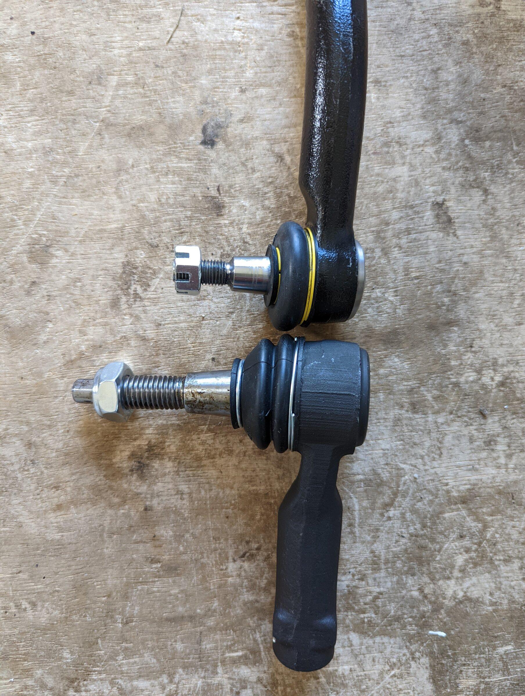

Thwarted again. The length works with the 09-14 F150 inner. The part that goes into the knuckle is puny. The Moog specs said 12mm but this off brand is 10mm. Maybe a real Moog would solve that, but the tapered section is way too short for us. Here it is compared to a 04-08 F150 outer.
Personally, for the foreseeable future I'm going to run stock Bronco steering and keep Ranger spare inners on hand.
Maybe down the road Ford will give us a better option. HOSS 3.0 tie rods?

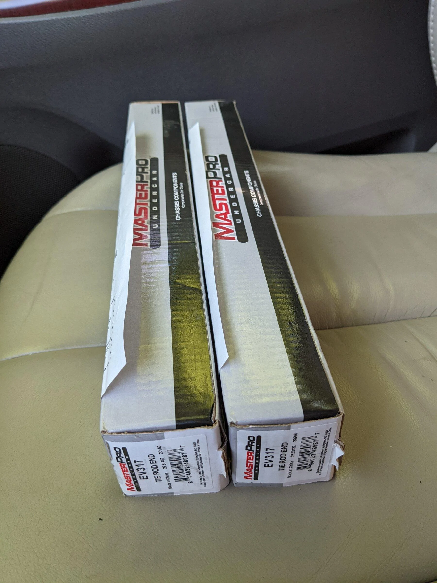

Great thread. Thank you so much for all the research.
To distill this and make sure I fully understand the recommendation, is it fair to say that this Moog EV317 is an effective spare to keep on board?
Edit: just noticing that link doesn't supply context, but that's the inner tie rod end for a 2004 Ford Ranger with any of the 3 available engine models.
Yes that's what you want. I've taken to referring to them as an EV317 as well, less typing. I keep 2 in my Bronco when offroading.
