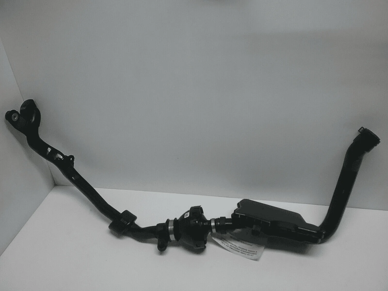

The Mustangs actually have a "sound tube" that pipes the sound through the firewall to behind the dash. I removed mine and plugged the hole.
