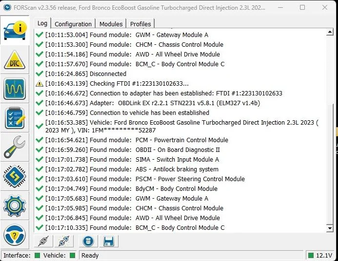

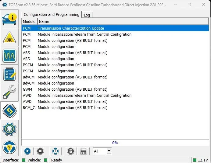

Hello, I'm running FORSCAN for the first time. I saved the configuration file in case things go wrong. When it runs I get no ACM option. Any ideas what I'm doing wrong?
Thank you

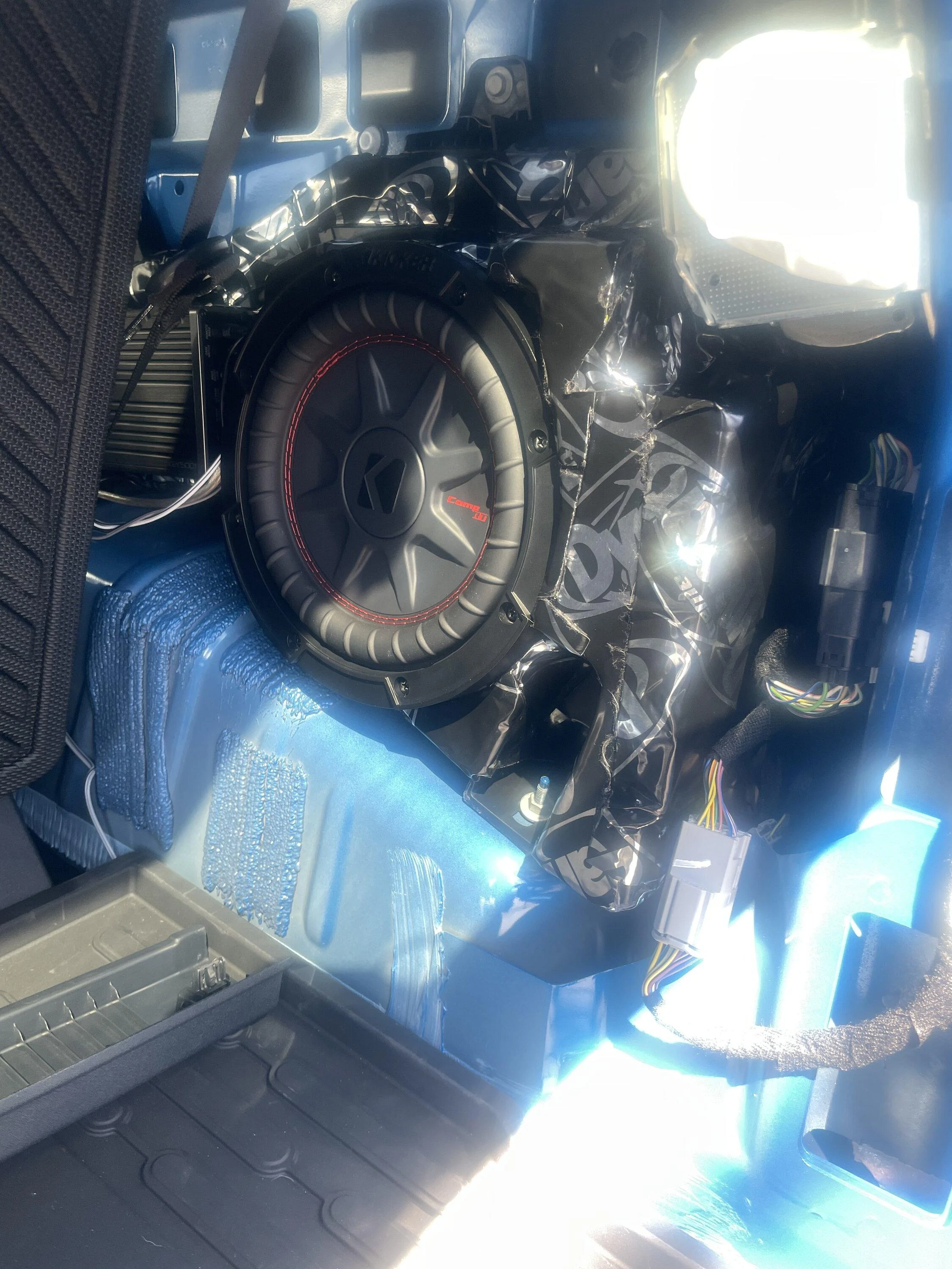

My wife’s bronco came with the fake amp and subwoofer. Used the kicker sub and kicker key amp with the bass adjuster. I wrapped the entire box in dynomat and no rattle at all.
Did you use the factory wiring for the Sub amp? Kicker 500.1?

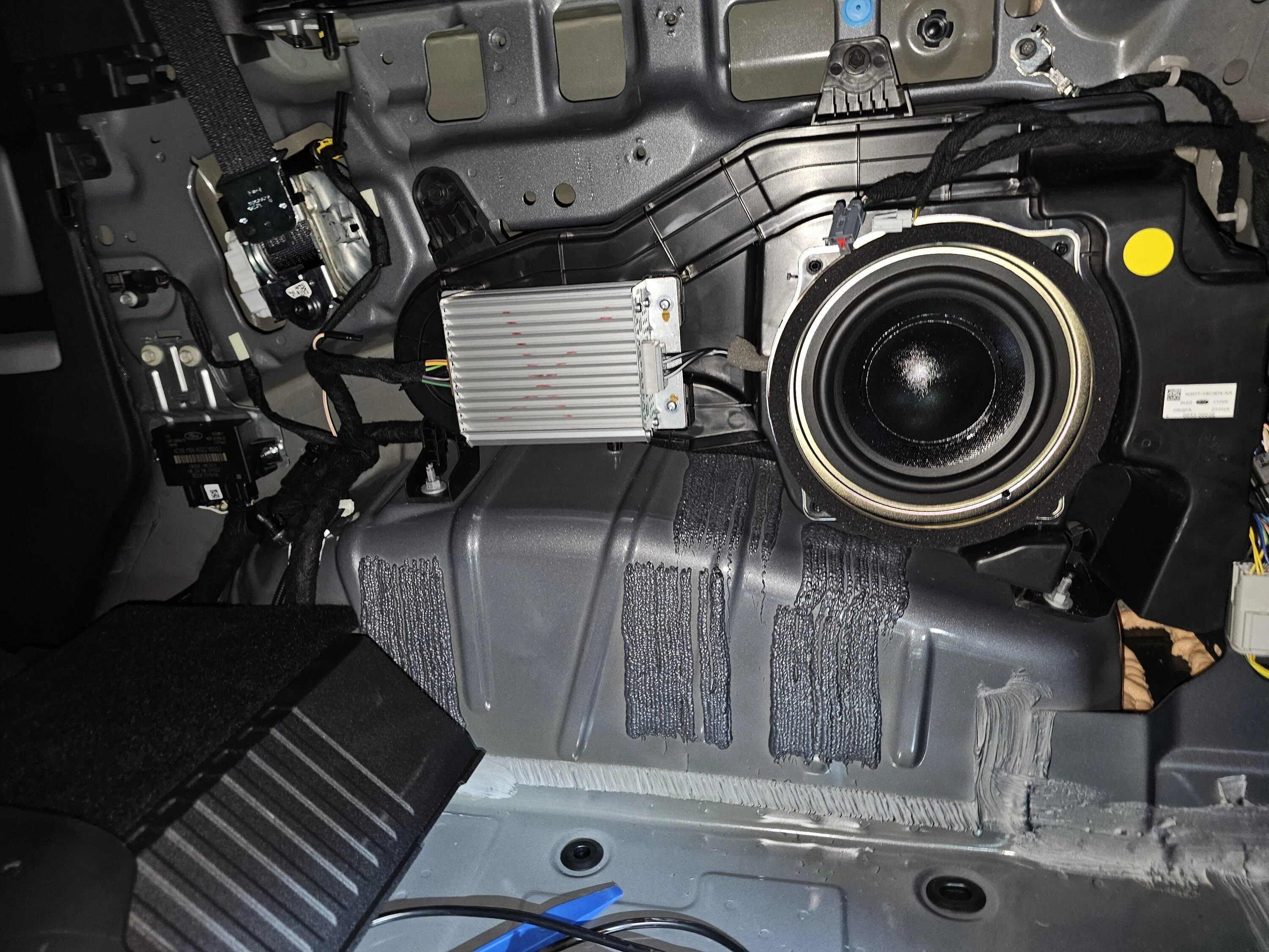

I have my rear passenger Trim panel off to wire my license plate relocation bra k LED and some LED pods for a new rear bumper, my Bronco Window sticker shows I have the 6 speaker delete...so got the fake amp and sub.
While Iam in there is there a plug n play replacement to stick in there besides OEM?
What do you mean fake amp and sub? Why would there be anything there? Is it literally a fake speaker and an empty amp box? I can’t even comprehend why they would waste money sticking fake stuff in there.

Is that really all? No wiring/splicing/etc? Do they just plug into an existing wire harness? I have Forscan already.
So I have the B&O system and it sounds pretty decent but when I had my panel off to run some wires I could see the subwoofer had a really tiny magnet. I’ve got bigger subs in my pinball machines. If this is a truly a drop in plug and play subwoofer then just by replacing it I should get better base. No modification whatsoever?
Did you get yours through Amazon? They are showing $107.96
It's true. All 2023 Broncos were supposed to come with sub and amp. But, supply issues kept Ford from being able to keep up with production. I read (not sure if true) that since there was equipment in the test vehicles for crash test certifications, they had to have stuff there in the production Broncos. So, most of the 2023 Broncos have "sub delete" and a $250 credit on the window sticker... the fake amp has a blank system board, and the fake sub has no magnet/driver... just a cone. However, the sub housing is there, and all the wiring is there... so it makes it easy to replace with real equipment.
