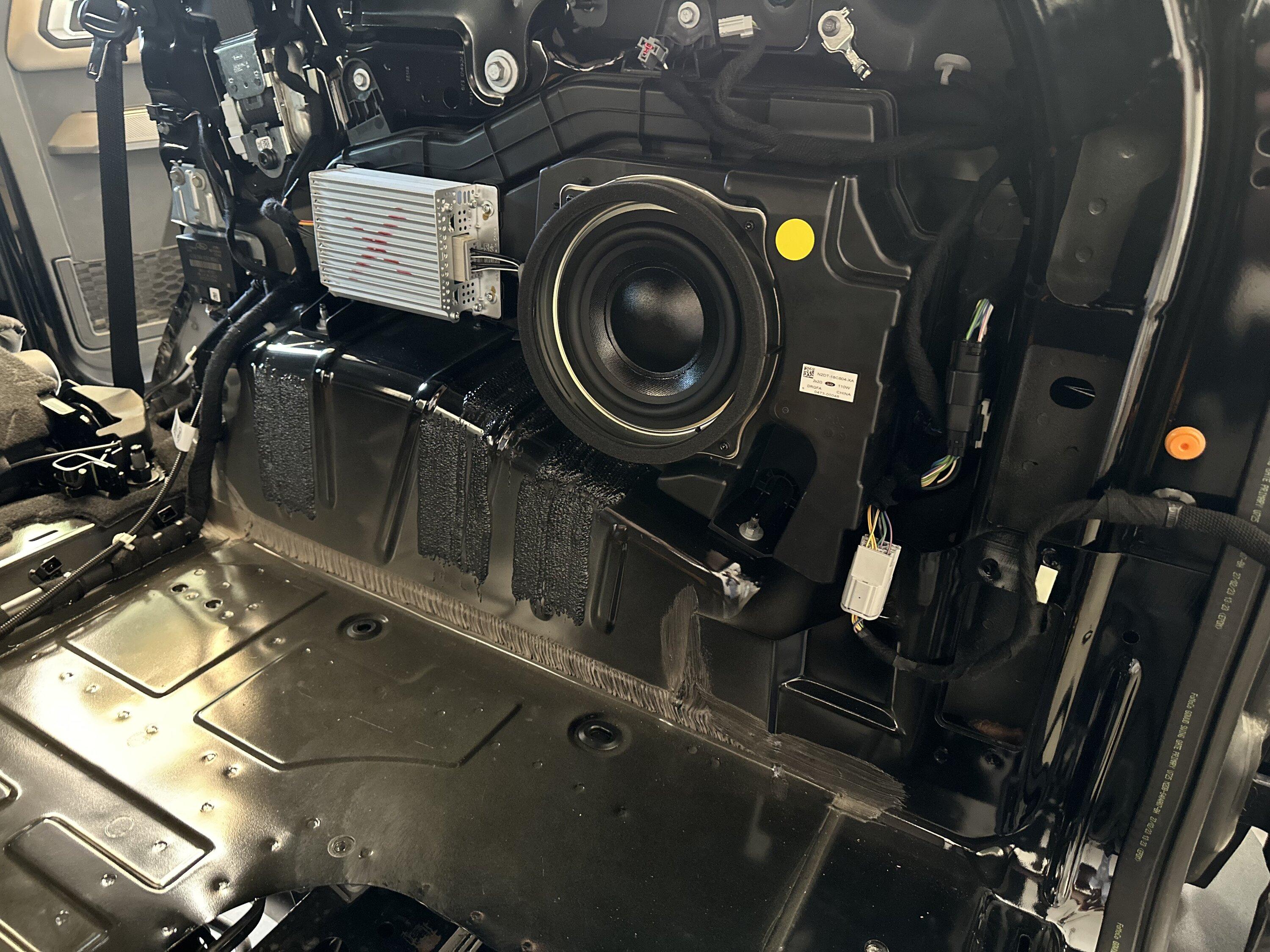

Ford Bronco Fake sub/amp...Now what? 71553989622__9331CC46-EB97-4D7A-B2A8-D2D141CC04AA
I installed mine tonight. If they’re easy to source, getting a couple extra blue clips is good piece of mind. I had to break open the Gorilla Glue for one of mine. Luckily the orange clip you can see in the picture didn’t break.
I still need to install Forscan, getting the license took a lot longer than expected, so you might want to do that the day before.
