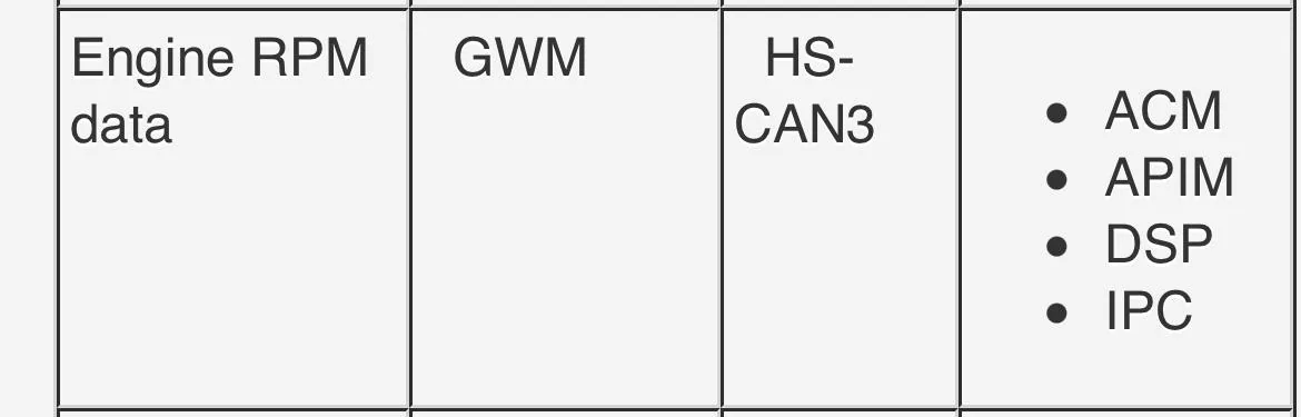

For specifics, and I guess it’s more than fake ass engine noise but this is from the CAN map of the Bronco. ANC (Active Noise Control) has been in use since 2015 with Ford vehicles.
ACM is the Audio Control Module and DSP is the Digital Signal Processor (B&O Amp)

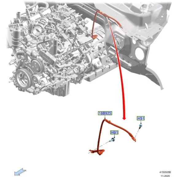

Hey all,
I installed an aftermarket amp and subs in my 4 door lux OBX, and I'm running into an issue. Whenever I accelerate, my subs give off a hum in time with the engine, and after some googling, I discovered the engine sounds in these is fake/amplified.
Does anyone know if it's possible to disable the fake engine sound? Will I have to go through the dealer?
List of equipment used in case anyone's curious:
2 Skar SVR-12s in custom enclosure
Skar RP-1500.d amplifier
Knukonceptz 4 AWG OFC wiring kit
AudioControl LC2i tapped into front kick panel speakers (gonna need to patch into the factory sub wiring, these speakers don't have much bass below 60hz)
you can always start by the easiest thing, radio filter in the engine bay, a simple wire to check
