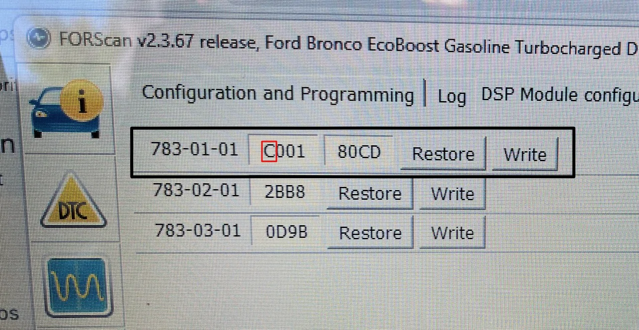

Here is my understanding of the adjustments made with the forscan based upon whether you have the Lux pkg.
Adjustment for LUX Package B&O Stereo Equipped Broncos using Forscan
LUX PKG
Okay just called my buddy. It is part of the ANC setup so yeah more prominent and or exclusive to vehicles with Lux. It's part of the ANC (Active Noise Cancellation) so those without Lux either get a reduced version of the fake ass engine noise or none at all. I knew it was generally complained about for vehicles with higher trims. Anyways if you have Lux there is ANC in the DSP and you can turn it off with ForScan and see if it helps make it go away. @LightRefined
My original post in the ACM (Audio Control Module) is for Software ANC. Both may need to be disabled. Also both may not work. No clue but good luck. Weiners crossed
783-01-01*xxxxx--C=ANC Disabled D=ANC Enabled
Adjustment for Broncos with Base 7 speaker system using Forscan (NO LUX)
I have a 2024 Big Bend with the base 7 speaker setup. I did all the recommended speaker and amp upgrades and added an extra sub and amp in the back. Got everything tuned in the garage and decided to take it out for a drive and is sounded like a garbled grumble was coming from somewhere. I thought something was rubbing on the tires. Then I thought I screwed up the speaker and amp install. Did some research and for the first time heard about the fake engine noise. I didn’t think they would include it on the base BB model but mine had it. The forscan is different than the Lux models in that we don’t have a DSP module. I found after a while that I only have to change the following to turn it off:
ACM 727-01-01 xxxx-xxxx-*xxx
Original showed 382B 16F1 10AA
Fixed version shows 382B 16F1 00AA

Thanks for this. I'm running into the same problem on my 2025 base 2 door after Kicker Key 200.4 install. Seemed a little louder after replacing the speakers but not much. Definitely louder after the amp install--and yes all gains on amp are at minimum as well. Planning to check this out in next day or two.
motaresto
Oct 13, 2025
32
PA
You change that first "D" to a C". I just did it and it works like a champ. The fake noise is even louder/worse than I realized. Incredible difference. I despise the faux noise for some reason. Much better!
Did this to a '25 2.7L w/ LUX to the DSP module 783-01-01.
Can confirm the change of the first "D" to a C" worked to remove the fake engine noise. :thumbsup:
