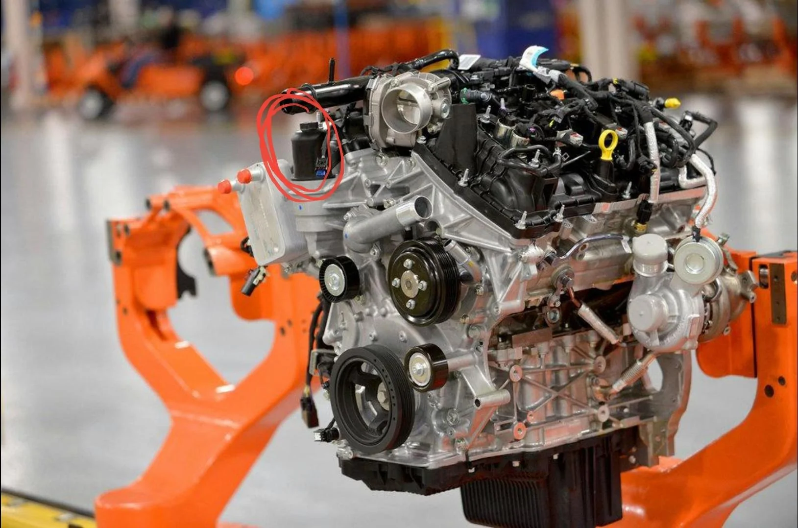

Pretty sure the 2.7 has the filter on the top like the GTI.
Looks like you're right, that's awesome. Makes for such an easy oil change, assuming you can get an extractor tube all the way to the bottom of the pan. I've dealt with a couple vehicles where you couldn't.
The 2.3 definitely has a bottom mounted oil filter though. Should be at least a little easier to access on the Bronco than it is an RS though...
Ford Bronco Changing your own oil? Screenshot_20210228-140357_Gallery

I am pretty sure the Bronco 2.3l filter is in the same drivers side position as the Ranger. It’s a bit tight, but does not require removal of the tire (at least in the Ranger). 2.7 is definitely on top of the motor and is cartridge style. 2.7 shoot shoots oil like a fire hose and uses an odd “partial turn” drain plug. All well documented elsewhere too.
