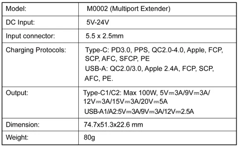

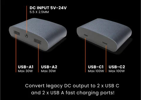

The solar panel will be pulled out only occasionally as needed and in that case it will connect to the EcoFlow through a USBC port via a slimQ, which can take the full 60W output of the battery and convert it into a USBC PD.
https://www.amazon.com/dp/B0BFW8G3DD
I don't think the slimQ will work in the way you think it will. The slimQ seems to rely on an external power supply. A detail Amazon leaves out.
You won't be able to use it to charge the Ecoflow.

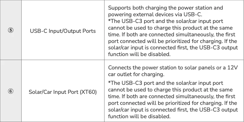

Also there's this little detain in the Ecoflow documentation.
Ford Bronco Budget fridge + powerbank combo Screenshot 2026-09-02 at 12.23.55 AM
There was never a plan to use both the XT and the USBc port to charge the EcoFlow. It was always going t be either or.
I have double checked the documentation of the SlimQ and cannot see any mention of it requiring a power supply beyond the input from the solar panel
https://slimq.life/products/dc-to-usb-extender-for-150w-240
This is 2nd generation product that can turn any DC input 5V-24V into a full PD 3.0 USB C output.
On many (most) solar panels, the USBc PD ports typically deliver half of the spec'd panel power. For example, 60W panels can deliver the full 60W on the 12V 2.1mm jack port, but only 30W (some models 45W) on the USB-c port. My goal with the SlimQ is to feed it with from the 2.1mm jack on the panel and (hopefully) deliver something approximating 60W USB-c PD on via the SlimQ output. The panel and SlimQ arrive tomorrow, we shall see if it works.
